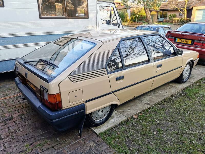

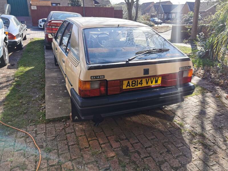

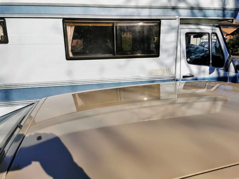

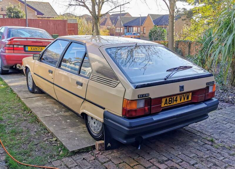

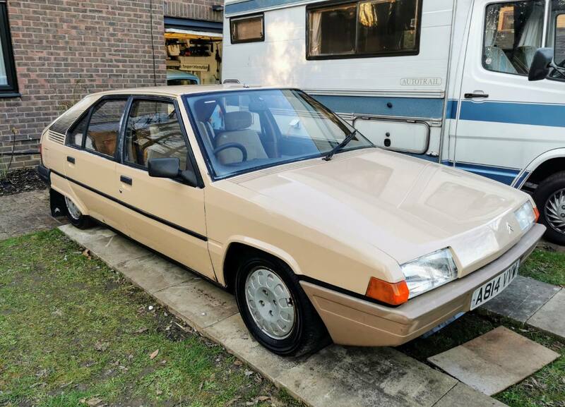

Fairly productive day today.  Main task was to hit the BX (not literally) with the polish and wax.

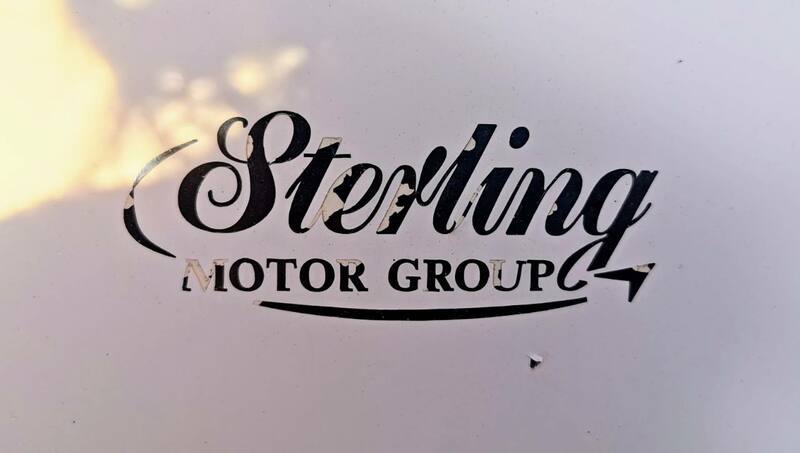

I'd been hovering over whether to remove the dealer decals for a while, though as they were in pretty poor condition was leaning towards removing them.
The fact that they pretty much started to disintegrate once the polishing started sealed the deal really.
Off they came.
Then a couple of hours of elbow grease followed.  The result was worth it though.
The bonnet and roof still have a bit of a haze to them so could probably do with going over again, but overall I think she's looking a huge amount more presentable.  Far better for having lost the random stickers and badge from the bootlid I think.
I'm waiting on some proper 3M double sided foam tape so I can redo all the rubbing strips (two are coming away in addition to the two missing on the front wings), which will be a good opportunity to deal with the ingrained grime right next to them I just couldn't get to today.  The bootlid badges look to be metal rather than plastic, so removing to clean behind them shouldn't be a problem.

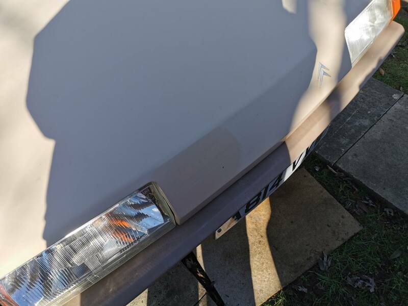

Getting the missing bit of rubbing strip back on the front wings will help a lot I think as your eye is drawn to the gap there immediately.

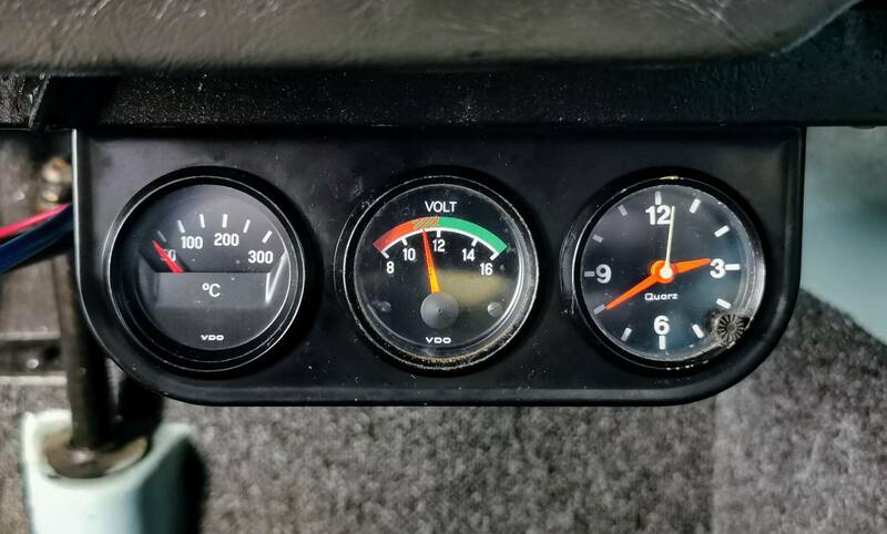

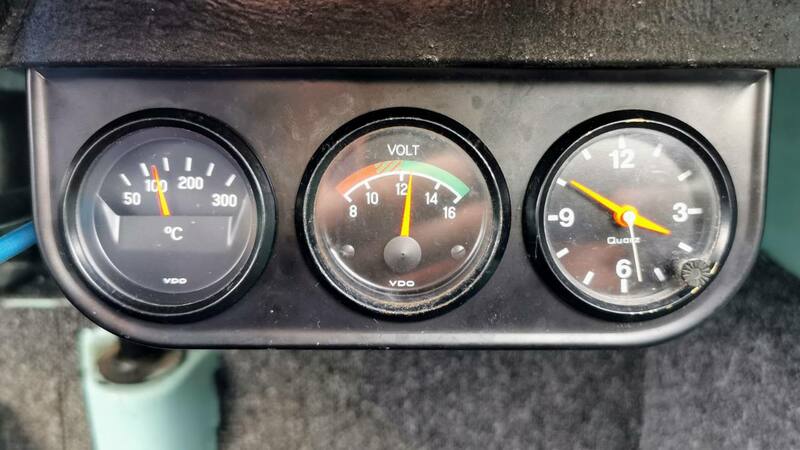

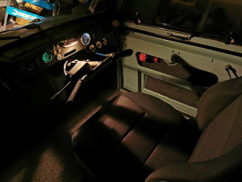

Once I was satisfied with my progress there I decided to finish up wiring in the new instruments in TPA.  This took longer than it really should have mostly thanks to poor process planning on my part but we got nearly there in the end, and the voltmeter now works.  I just need to hook up the permanent live for the clock at the battery end and tidy up my wiring a bit.
What ended up taking the longest was tying into the existing dash lighting circuit and sorting out the grounds - as we had a mish-mash between the gauges of common grounds for the gauge and lighting, grounded through the case and totally separate connections - and I was trying to keep the spaghetti to a minimum.  Got there though.
Probably going to add some filters so that everything is green as the illumination mismatch bugs me!
Finishing off the clock wiring tomorrow should only be a ten minute job.  Only took a while because I've got a battery isolator switch fitted so need a dedicated live for it run all the way back to the battery itself (via a 2A fuse of course, right at the battery side).  That adds a lot of extra work as the wiring all has to run underneath the car.  Nice to be still getting things ticked off though.
Really happy with how the BX is looking now.  I was right that the colour was really going to look the part once it had a good shine to it, really does suit the car I think - even though I'd never have thought to choose beige at the showroom, I do like it.

Lovely stuff on the BX (and glad to see the Autoshite sticker survived the ordeal, still really want to get/find one of those for REV LOL, if anyone does have any extras lying around please do give me a shout!)

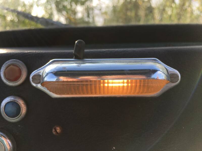

did not realise the bulb in TPA's speedo had been replaced with an LED one it looks far too cold and ghastly, I hope your planning on fitting an incandescent lamp again or a warm white LED if nothing else at some point :)
funnily enough the clock in my Model 70 is green when lit up, but I plan to just take the clock apart and remove the green filter rather than add green filters to everything else
(as I find the unfiltered tungsten glow matches the general atheistic/age of the Model 70 much better then the Green which makes me think of the 1980's more)
What is the source of the dash light?  Sure I have seen it somewhere but can't place it, and I need exactly that thing for a job.

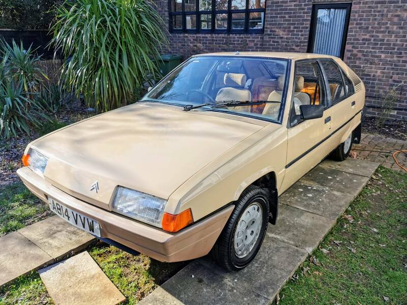

The beige of that BX is just so... suitable. It really looks the part and especially now it's all polished up. Heavens, if I had an outside tap I'd wash the BM in celebration, but as it hasn't had a wash for 15 months now why ruin it?
I think that beige has come full circle. I see it sometimes on modern Fiat 500s and other cool* cars.
I expect it’s called Cappucino now or something.
Anyway, keep up the great work! Love seeing it come back to life.

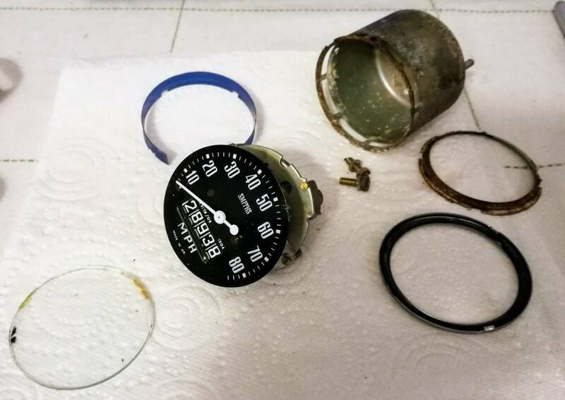

There's no LEDs anywhere in TPA.  The original lamp is still there, there's a blue filter built into the speedometer surround - can be seen here when I had the one from KPL apart to remove all the spiders.
That's it at about 11 o'clock in the above photo.
De-greening the fuel gauge would be difficult given that it's crimped together... getting into it without destroying it would be the challenge.
It's been a while since I had a BX hatchback, but am pretty sure the 'spoiler' is part of the hatch moulding.
thats interesting! never realised the Pre March 1976 Model 70 speedo's  had a blue filter in them, would be interesting to see what it looks like in person
but if the photo is anything to go by it does not look very nice so id elect to remove it
gonna have to double check what Large Speedo Model 70's have now! (REV being a private example and knowing her previous keepers means I know I should check double, see for example her warning lights being re-arranged/re-assigned)
That has really surprised me - it looked to have all that horrible coldness of a 6500K LED to its light. Perhaps then, as I think you've suggested, all the instruments need to go green to match the fuel gauge: I still, 47+ years on, remember the surprise of going from the white illumination of Dad's FB Victor to the green of the Zodiac - and then back to white for my 16...

As mentioned elsewhere, I remember Dad's 1970 Zodiac had green illumination for its instruments.
Can confirm that the dash gauges in the Invacar definitely do not colour match. It's how they are, so no biggy. I may have to dismantle TWC's speedometer though as it's full of dead spiders as well, and the bulb only illuminates the 70 and 80 part of the speedo...
Resting battery voltage looks a bit healthier when I've not been faffing about with the headlights for half an hour.
The clock now works too.
The only bit you need.
You're of course totally correct.  The edge which looked like it was a join was actually the edge of the black paint where it was originally masked.

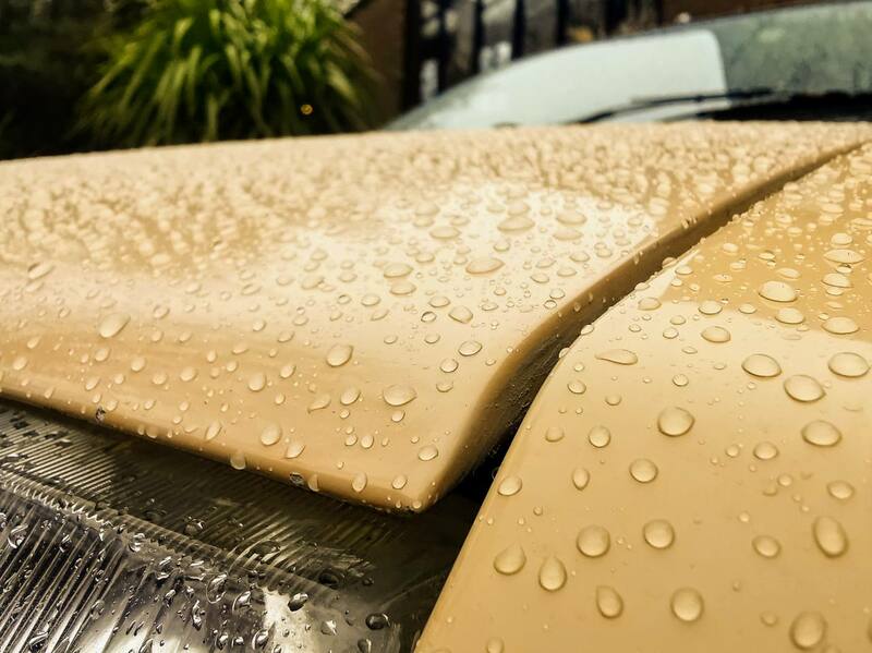

Well doesn't that sound happier?
I'd known something was way off with the carb setup from square one given that the idle speed was very high and I could tell with my nose from fifty feet away that she was running stinking rich.  I decided to actually investigate that this afternoon and it didn't take long to work it out.  The idle mixture screw was wound all the way in and firmly seated...So the carb idle circuit was doing precisely nothing.  The only reason the car was idling at all was because the idle speed screw had been wound so far open that the throttle was held about 10% open and she was actually running from the main jet rather than the idle system.
Winding that open a couple of turns and backing off the idle speed adjustment (as that immediately shot up to about 3500rpm once I started to open the idle circuit up) soon got things much closer to where they're meant to be.  I'll hook the CO meter to get it vaguely close to the book value when the rain stops.  Now she's not running horrendously rich I'm glad to report that the intermittent but frequent miss at idle has vanished as well.  Not expecting to get it absolutely perfect as I've no idea how stale a lot of the fuel in the tank is, but I don't reckon things are a million miles off now.
The even bigger positive of this than a smooth idle though is that apparently backing that adjustment screw out has resolved the issue I had with the accelerator pump being blocked off - that's now working properly it looks like.

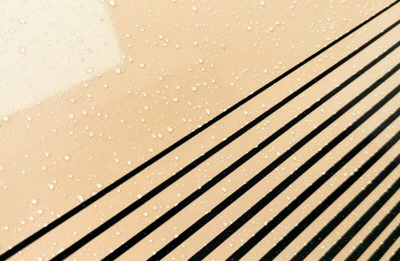

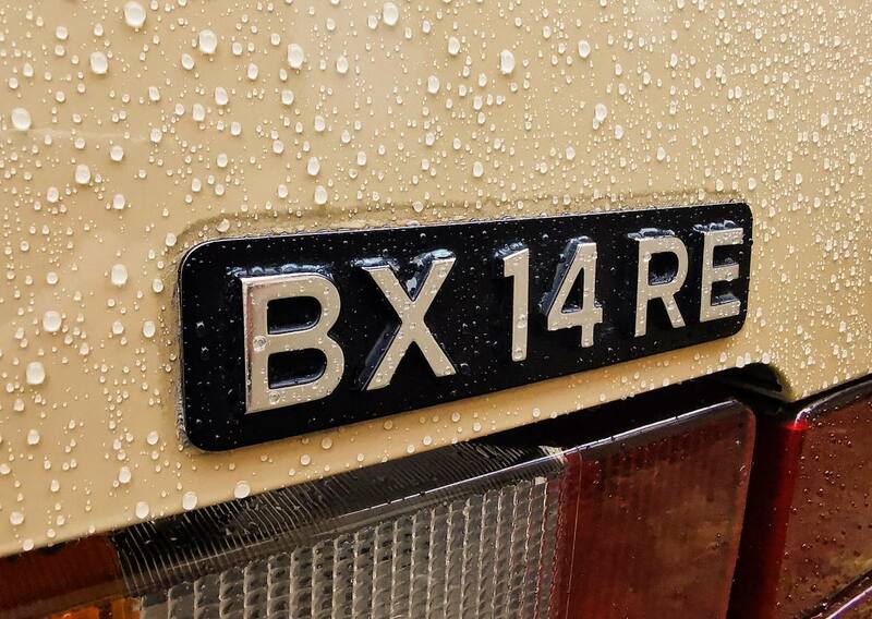

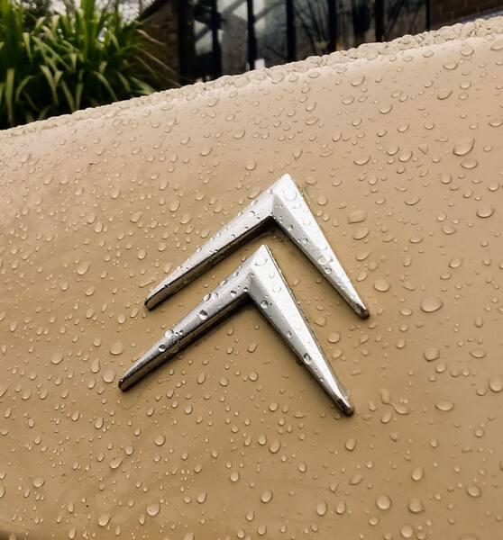

Just wish the rain had held off for another hour or two.
Particularly annoying as the oil filter I'd been waiting for arrived this morning, so I really wanted to get the oil and filter changed today.  Guess that's a job for later in the week now.
Nevertheless, it did give me an opportunity to get some gratuitous water beading photos on the freshly waxed paintwork...Imagine it's been a few years since this happened!
original_fd1c2f29-ddfc-459d-a74b-1f28e5b11c0e_IMG_20210303_160240.thumb.jpg.aa5b44b3c3d09b539c0666f57d17953c.jpg

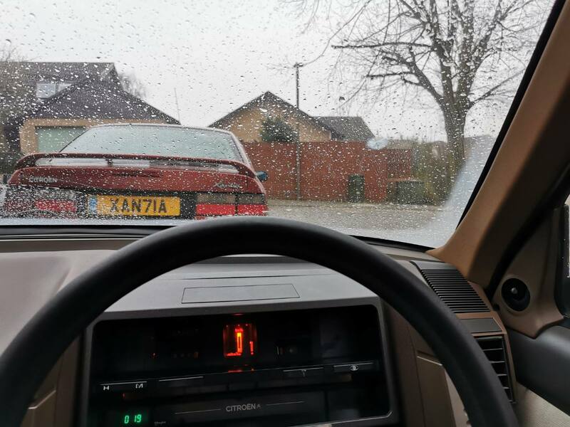

What're those lights that flash when you rev it up, Mr. Zel? Are they like the traffic-light 'econometer' my R18 had?
5 minutes ago, R1152 said:
Oooh, feeling the beige BX love here.
It's referred to as the "Econoscope" in the wiring diagrams - Exact way it functions I'm not sure yet as it appeared to have disappeared by 1985 when the handbook I've got is from, and it makes no mention of it.  Basically a bunch of blinky lights tied to a vacuum pressure sensor.
That's how it worked on my 1982 Renault 18GTL - from the vacuum sensor. There was a switch on the gearbox that closed when 5th gear was engaged to prevent the red LED illuminating. On my 18 the plug had already come off the switch because Renault had made the connection so tight you could have played a tune on it. Refitting it fixed it so that if you hoofed it in 5th, apart from the bloody thing pinking like mad you only got the yellow LED on at worst.
