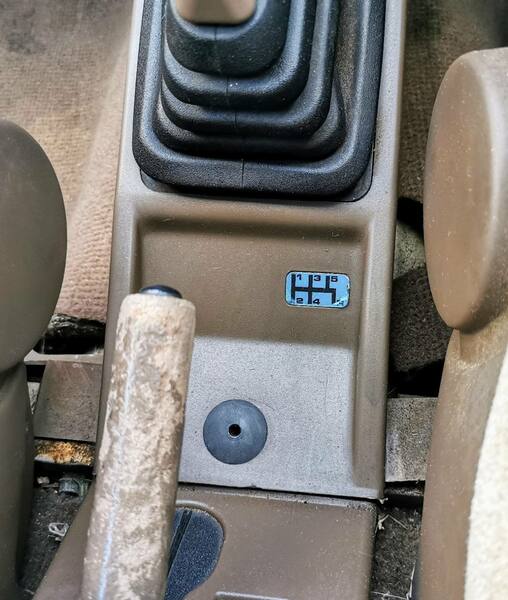

Edit: After 150K miles, HOW is the protective film still on the label for the gear shift pattern?!?
