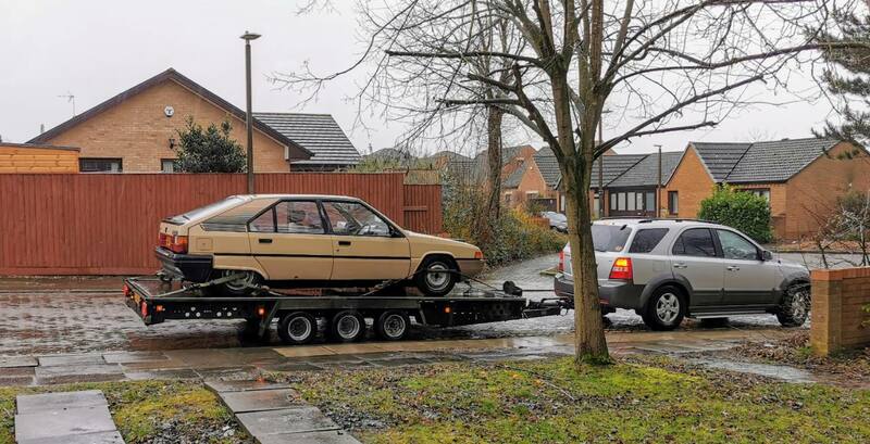

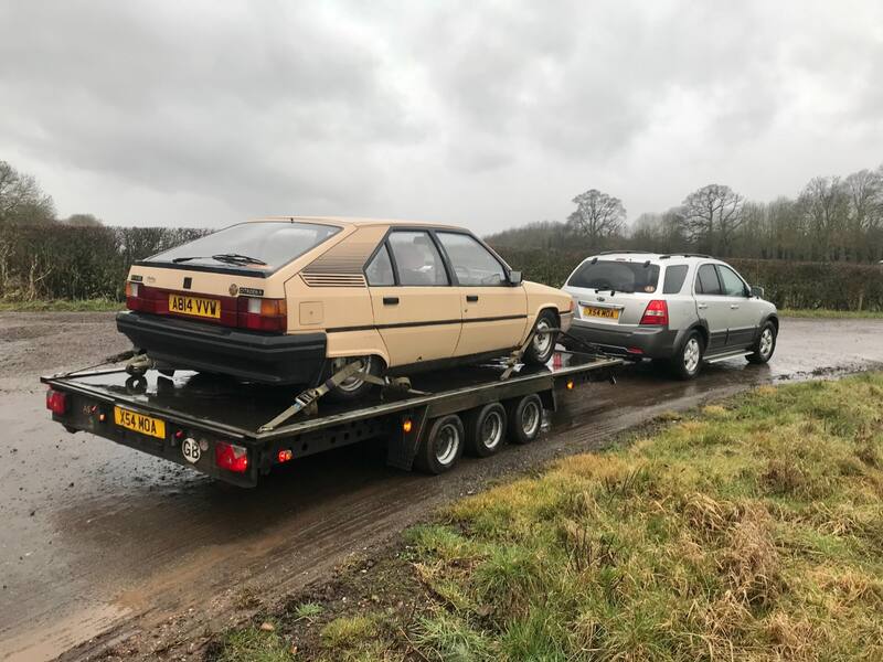

55 minutes ago, worldofceri said:
On the road to beige glory...
Yep...the weather has noticed you're on the way!
Perfect for unloading and looking over a new arrival!
We have touchdown!
Safely tucked away behind the Xantia for now.
I'll see about having a look at things more closely this afternoon if the bloody rain ever stops!  Get a new battery picked up then see where we are.  Oh, and some new seat covers.  Apparently early BXs suffer from the same issues with decomposing seat fabric as Skoda Estelles do.

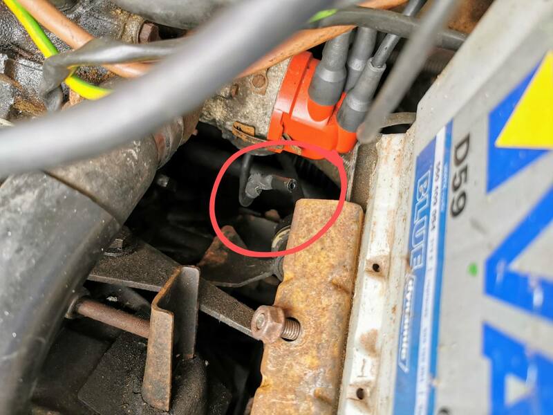

[] Distributor advance unit vacuum line isn't attached to anything.

Yep, those loose pipes are all as a result of our final fiddling session. I never got round to putting it back together, and then it had to be moved to where it was until yesterday.

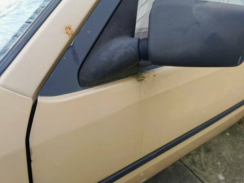

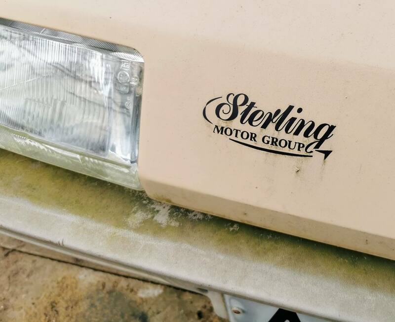

While rough around the edges, I reckon there's the makings of a good car here.  A good valet and a set of seat covers would go a long way to making it look better.
The bodywork seems astonishingly free of dents and scrapes for a 150K mile car.  Quite likely more than that actually given the exact same mileage is still showing from the previous MOT...

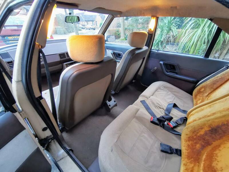

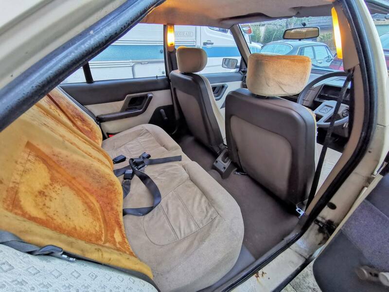

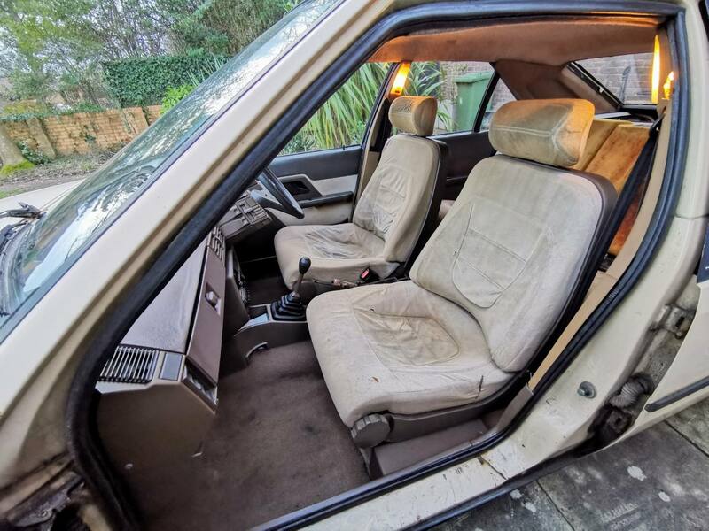

The interior to be honest needs more help than the exterior and is looking a little sad.
Aside from just being generally grubby and dusty in that way all old, disused cars are the single biggest issue seems to be decomposing fabrics.  It looks like the seats and door cards all suffer from degradation under UV exposure in the same way as seats on Skoda Estelles do.
Not sure what state the front seats are in under the slip covers currently in place (which are fit only for the bin), but I'm guessing not great.  The cover seems to have been completely removed from the upright of the rear seat.
While that looks quite dramatic, the foam doesn't seem to be in too bad shape so re-covering them shouldn't be too difficult.
The cloth on the door cards is clearly going the same way.  They're flat though so should be easy enough to restore.  The headlining looks in honestly miraculously good shape.
Given the reputation these series 1 cars have for plastics with the structural integrity of cardboard there are surprisingly few things that are obviously broken.

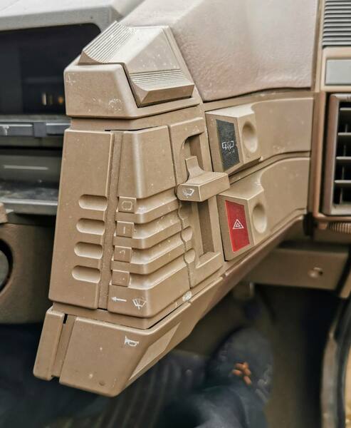

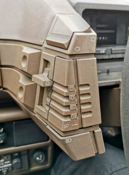

All of the driver controls are present and aside from a few scratchy contacts due to disuse seem to work fine.
Looking forward to actually getting to use these in the real world.
They will look a lot better once they've been given a good wipe over to get a bit of life back into them.

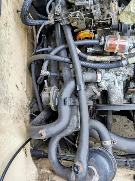

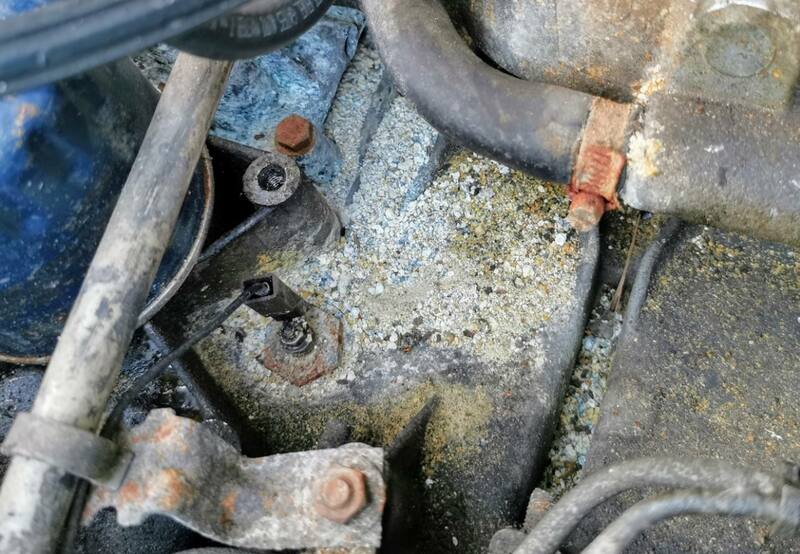

The engine bay is filthy but seemingly pretty clear of the usual maze of wiring hacks I'm kind of used to on cars of this age.
Mmm...crusty...
Cleaning this engine bay is going to be immensely satisfying...

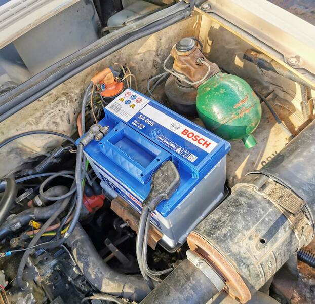

First actual job for the day was to pick up and install a new battery as the one with the car seems to be past it.

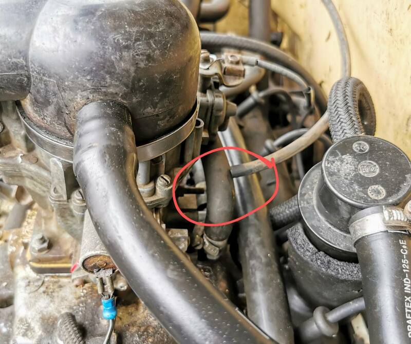

My earlier glance around the engine bay revealed a few things disconnected due to prior investigation into poor running.
This one I initially thought was a vacuum line.
Turned out that this was actually hooked up to the fuel pump inlet...my guess folks were trying to run the car from a can.
Figuring this out was helpful as it meant I wasn't missing a hook-up point for the connection for the distributor vacuum advance unit.
Sadly the line for that was beyond help.
I didn't have nearly enough 3mm pipe in stock to run a whole new line...so being me it was time to improvise!
Two flexible elbows made line I did have, then connect the two with a bit of copper brake line.
Not pretty but will do the job.

Once it was dark I was able to have a look at how much of the dash lighting works.
Oh.
We have *one* working illumination lamp it looks...above the blanked off space above the fuel gauge.  Zip from anything else.  Yep...that will need to come apart then!

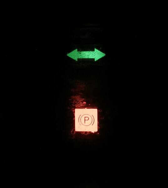

Speaking of lights that are out, noted that we have no light working in the hazard switch or dash tell tale for the fog lights.
The light in the glove box is working though!
The dash light for the indicators initially wasn't working, but I blinked and it came back to life without requiring any intervention.

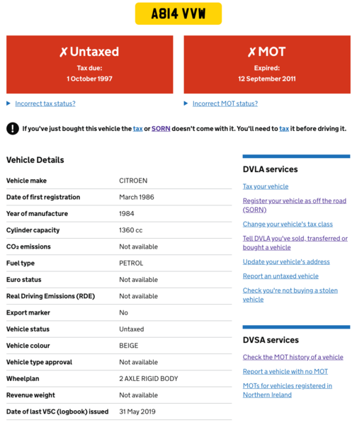

while I dont know the full history of this car (tho I have skimmed through its previous thread recently and in the past)
I do wonder if its ever seen the Open Road in the past 20 years?
because although it had an MOT in 2010, its showing as Untaxed since 1997! so perhaps the odometer is not actually broken? (although both the fail and the pass a few days later are showing the same milage, but I do wonder if it passed an MOT in 2010 why it was never taxed etc)
2040906911_Screenshot2021-02-18at21_04_45.thumb.png.1202073d51f482c504433e8e011b0069.png
BTW im curious if there are any special notes on the V5?, like "declared new at first registration" or such?
because as you may have noticed she is a 1984 car but registered in 1986, but she does not have any used before date of first registration or import markers etc that would say she is an import or such
however normally when you have new old stock sitting around in the dealer they just get registered as a new car (so would show up as year of manufacture 1986 rather then 1984)
but this one is down as 1984 and is on an appropriate 1984 Age related plate, so im curious as to what happened there  :) registered as a new car but someone went out of their way to make sure the Year of manufacture was correct!

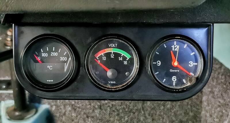

Last two instruments arrived for TPA though.  Not wired up yet but have dropped them into place.
Doesn't this look better than the cheap modern tat I originally had fitted?
Yes I will clean everything once the wiring is done.  No point yet as they will all need to come out again for that.
Location seems a good blend between out of the way and clearly visible.
My garage is about a worst case scenario where reflections are concerned because of the lighting.  If I have issues with that on the road I can adjust the angle of the bracket a bit as required.

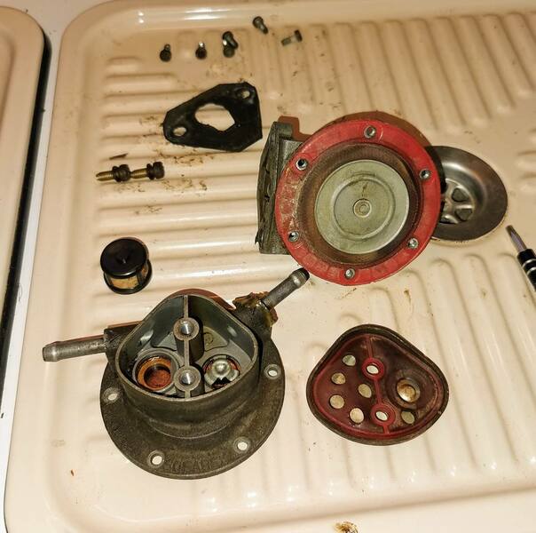

Further BX tinkering has occurred.  For all of 45 minutes before I ran out of daylight.
Having stripped down and thoroughly cleaned the fuel pump (it wasn't bad) I think I have to conclude we have a diff pump.
Best I can tell one of the valves is damaged or the diaphragm has a pinhole I can't detect.  It just doesn't seem to be able to generate any decent pressure.  I've checked again and can get a solid flow of fuel from the tank under vacuum, so this pump looks to be to blame.
I did note that the oil smells quite strongly of petrol, I had put that down initially to the reported miss and lack of a decent run in forever, but if the pump has been leaking internally that could also explain it.
Will do a bit of digging later on and (assuming I can find one) will get a replacement ordered.

30 minutes ago, egg said:
I think the OEM part number is 1450-81
link
Hmm...that looks to be for an injected version...no fancy in tank pumps with the humble 14RE.  Just this little mechanical one.
I think this is the right one...albeit a slightly different design.

I've actually gone for an aftermarket one this time, simply because I've had very mixed results in the past with NOS parts involving diaphragms...so we'll see what turns up.
I was a little concerned how old the genuine Citroen one was and if the rubber bits were still ok.
You set me thinking and we have 3 cars with that pump. When I found a QH one for £19.21 including a 15% discount code if I bought before midnight I just went for it as a spare.
Not a bad plan!  Don't imagine it would be impossible to rebuild one either if you could find the right material.
56 minutes ago, LightBulbFun said:
was thinking just this :) I was going to say if the fuel pump situation becomes a PITA can you rob electric one from TPA, and then just reinstate TPAs original mechanical setup
I know her or well KPLs! pump was broken, but I cant imagine it would be too hard to get a replacement mechanical pump given the following the Steyr puch engine has!
or just see if you can find a 2nd electric pump of the same make and Model (since whatever it is, clearly is working well!)
Not worrying too much about it really.  I'm quite happy with the electric pump setup, especially with it not being a car that I'm using every day.  Should be less prone to potential vapour lock issues in hot weather too.
I really should just get a pump rebuild kit for it though.  I couldn't ever *find* anything amiss with the original pump, but just kept having issues with air in the fuel line...The electric pump was originally fitted just to try to prove the pump as the culprit, but the gent who loaned it to me offered me to just keep it...so it stayed where it was!
I was determined that today the BX was going to run.
Borrowed the fuel pump from the Invacar.
This got a decent amount of fuel flowing through the filter.  Still no interest in starting though.  I did block off the return line just in case the pump was having issues with the return.  No difference.
Pulling the top off the carb revealed we *did* actually have fuel in the float bowl which was progress from yesterday.  I was able to blast a bit of gunk out of a few of the passages.  There's definitely something amiss with the accelerator pump though... doesn't feel like the plunger is moving at all.  So I'll need to pull the carb and do some detective work there.  Hopefully I can find a decent exploded diagram so I don't need to reverse engineer it in my head.
Back together and we tried again.  Result?
That's progress.  Huge progress.  She still dies if you give her any real throttle because there's no accelerator pump working, but other than that she seems happy enough.  Bit of a miss now and then, but the fuel coming through the filter is the colour of weak black tea, so think we need to put a couple more gallons of fresh fuel in the tank before we read too much into that.  No smoke whatsoever, no rattles, she sounds pretty good.  Even though that puff from the front to mid exhaust join is going to drive my OCD mad now I've noticed it.
With the engine actually running I could check things out better.  Clutch seems okay.  Brakes (based on 3 feet of movement) are working.
Suspension comes up very quickly and settles down fine.  Based on the regulator tick rate I think the accumulator sphere is fine.  The bounce test seems to show the front spheres are fine...very floaty - the amount of travel is huge compared to the Xantia.  The rear ones...not so much.  No notable travel.  We'll need some new spheres for the rear then.
Yeah, these have been on there for a while.

This was the first time I was able in decent weather conditions to have a look at the car.
The bodywork on this car is (aside from the one dent just forward of the nearside rear wheel which looks repairable) is astonishingly straight.  Like ridiculously so.  The lack of scrapes and dings just blows my mind.
I didn't realise that the front bumper is actually brown rather than beige!
I couldn't resist hitting one tiny bit with the polish.  I reckon she's going to look decent once she's had a polish.
The exterior has an appointment with the pressure washer then a load of polish.

First order of business there was to get rid of the disintegrating slip covers on the seats.  Front seats aren't in terrible condition under them, though they're grubby as all hell and the fabric has come away from the foam which is why they look so baggy.
After an hour or so, some attention with the vacuum cleaner and a first wipe down of the plastics this is where we were.
Still a huge amount to do but it's got rid of a lot of grime, and the dash looks so much better.

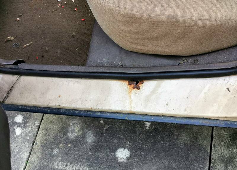

Did spot one area I'll need to break out the welder for though... hardly catastrophic though!
Only real grumble there will be the sheer amount of interior I'll need to dismantle to get to it without melting things.

Great to see it sat there idling quite happily, that bodes well.  The interior, seat fabric aside, looks like a good wipe over with some vinyl cleaner/conditioner will see it looking far better than it has any right to.  Is it just the photos or is the gear lever actually colour coded to the interior?
Yes, it is indeed colour coded.  Nice touch.
Looks like the front bumper will look well after some linseed oil/owatrol/etc.
