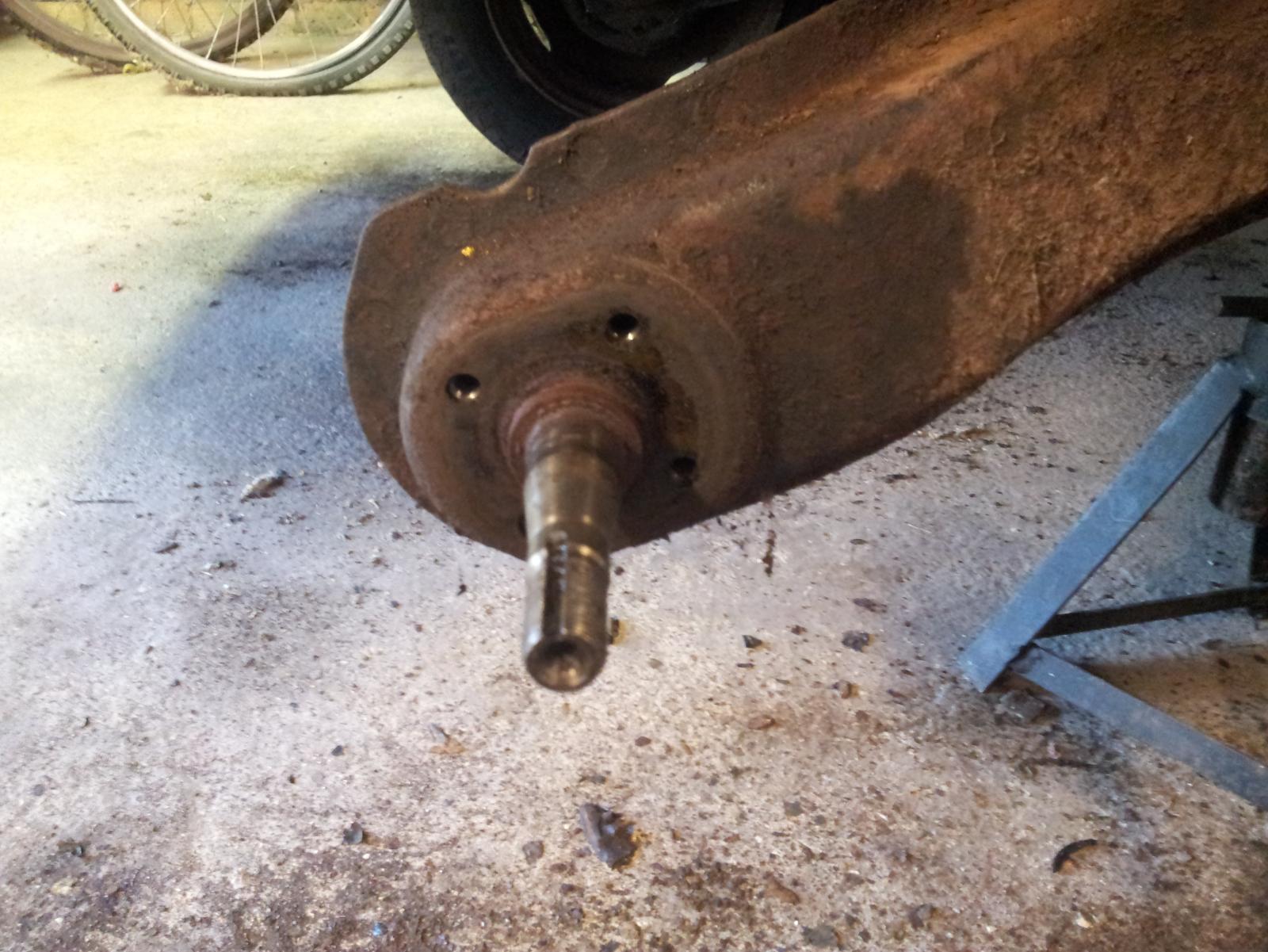

Bearing puller set arrived yesterday as promised.
Tried it today and yay! inner bearing race parts from stub axle with no drama at all.
Thought I was snookered again as the puller wouldn't fit behind the bearing because the wheel cylinder and brake adjusters stopped it getting close enough to the backplate. Tried clamping it across the tiny flange on the front of the race and gentle winding with a spanner produced the desired effect.
Puller set seems quite well made for a cheapo oriental product and will no doubt be useful again in the future, if only for the other side.

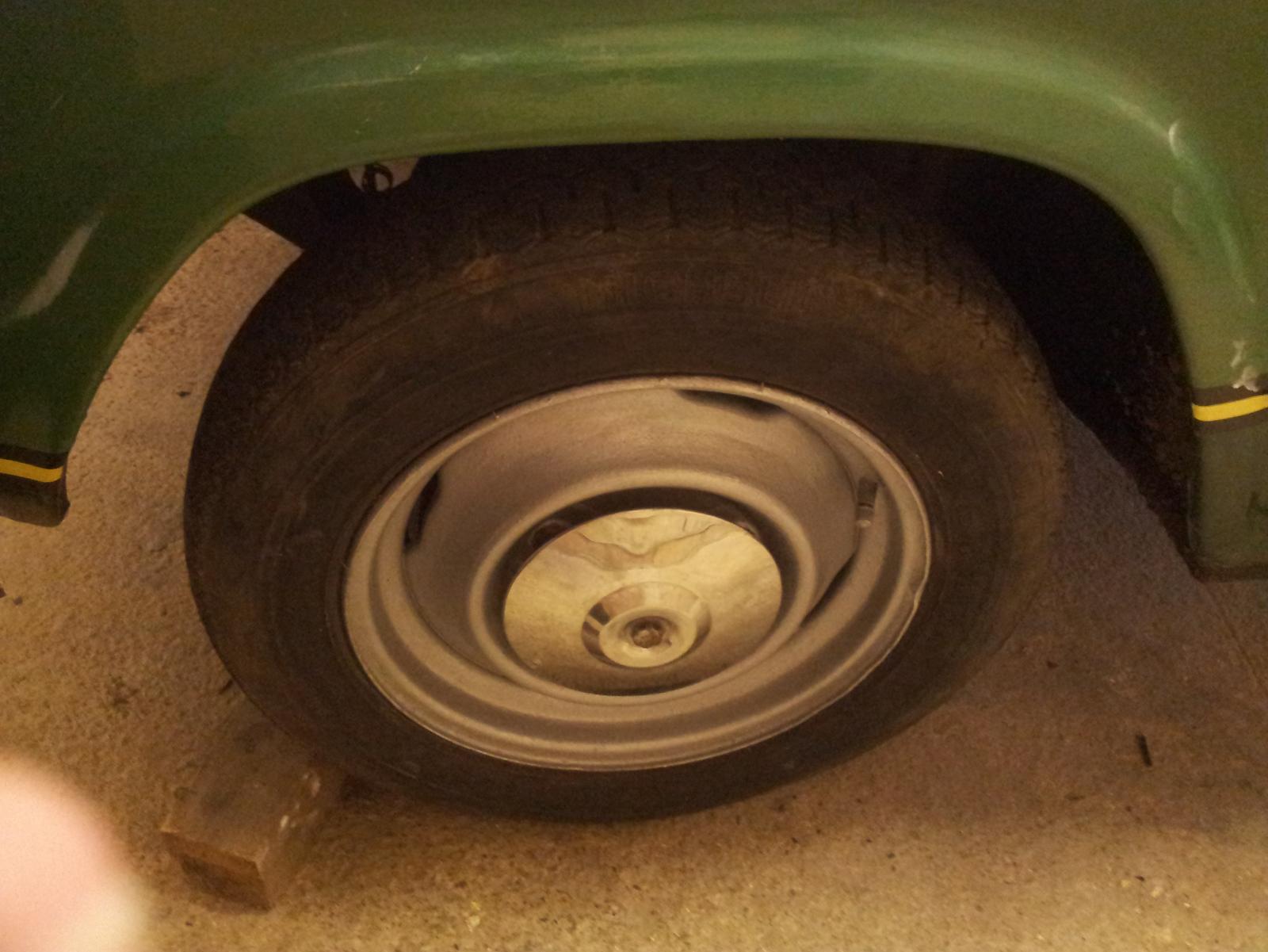

Apologies to the "do not paint" contingent, but I really had to do something about the wheels. Even patina has its limits (see definition below). A cursory wire brushing and a nice thick coat of silver Hammerite has made them look less like they were retrieved from a stagnant water-filled ditch.
Before and after shot:
After grovelling in my oddments box I discovered a roll of insulating tape which was the same colour, width and probably age as the yellow stripes on the car, so I have replaced the peeling originals with peeling new ones.
Also did trial fitting of lightly-butchered hubcap from a set misappropriated from one of Mr. Six-cylinder's many many Visas (Visae?).
Any thoughts? Yes? No? Too shiny shiny like? Probably.
Note the external handbrake mechanism.
And the thumb in the corner of the photo. No David Bailey me. :-)
PATINA: (noun) - The universal excuse for not repainting/repairing/replacing any totally knackered component on the grounds that it will "compromise the originality of the vehicle".

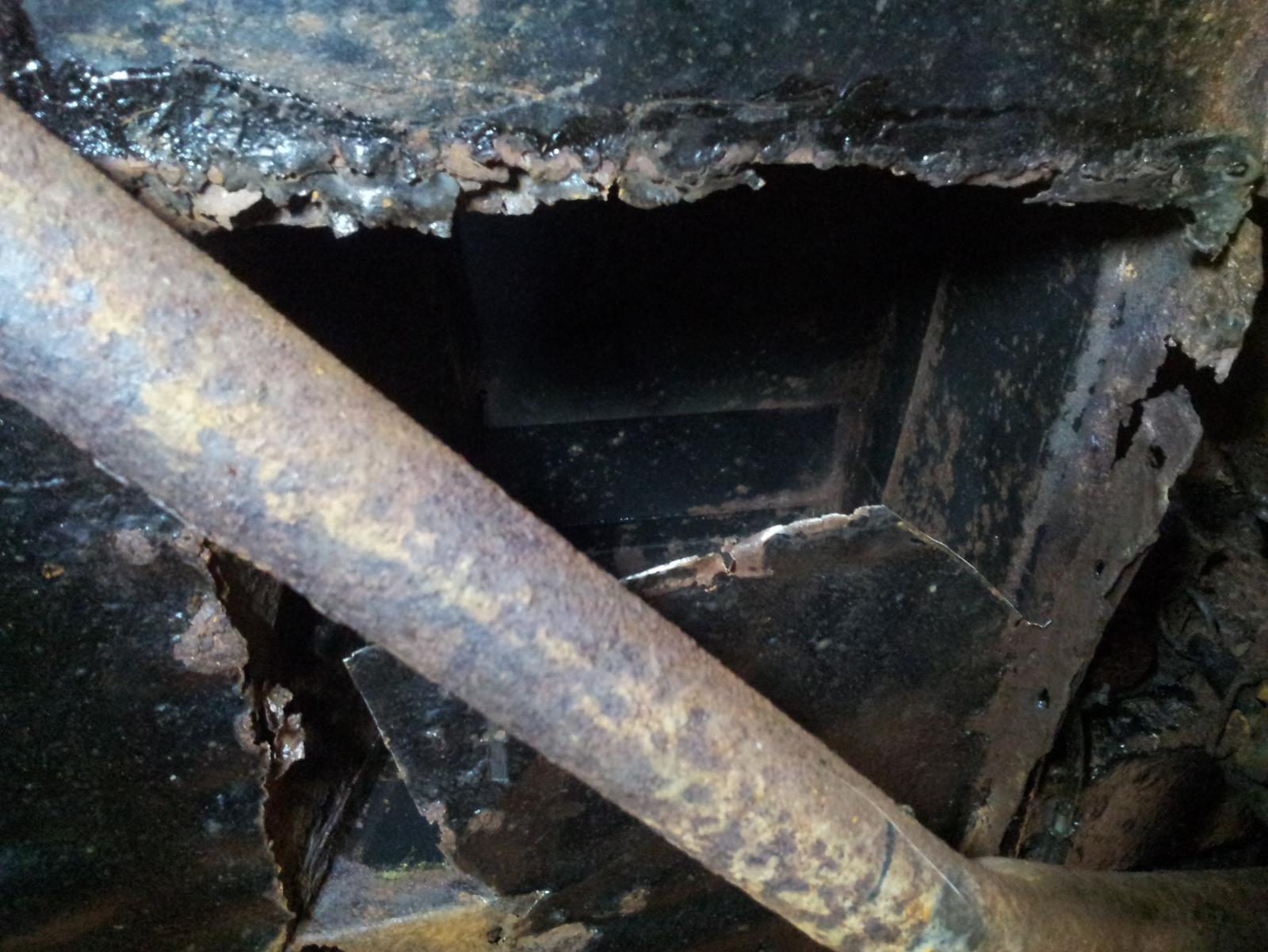

UPDATE: FROM FLAWLESS TO FLOOR-LESS
One of the reasons I decided to take on Bob as a project was because the bodywork and underside appeared to be in reasonable condition and did not require any welding. I enjoy doing mechanical stuff but hate doing bodywork.
An initial examination showed that some of the floorpan had been plated and then the entire underside and wheelarches had been treated to a nice new coat of underseal (well "new" at least 23 years ago).
However, on closer examination yesterday I discovered that some of the metal adjacent to the rear sill repair on the nearside was a bit crispy. After ten minutes of prodding with a screwdriver it now has a hole about eight inches square in the floorpan. See the awful truth below.
BUGGER!
This is the bottom of a double skinned section which appears to have rotted all around the edge, such that the metal could be peeled off like a sardine tin.
I can do weldage.
I have done weldage.
I don't do weldage any more.
I am far to old and grumpy to enjoy lying on my back with bits of red-hot metal landing on my face.
Sods law also says that while the same area on the offside, which has already been plated, is easily accessible, the nearside is above the exhaust pipe and close to the petrol tank, so both of these will doubtless have to come off.
Bugger again!
The current plan is therefore to continue trying to make it start, steer and stop, then try to find a mobile welder who will repair this for me in exchange for some pictures of the queen. At least it is a flat area and I can clean up the existing metal and cut and shape a new plate, so hopefully it shouldn't prove too difficult or expensive to farm this out, assuming I can find someone local who will take it on.
I just hate paying someone else to do stuff for me. Not because of the cost but because it is no longer "my" restoration and I have no control over the quality of the repair.
If anyone knows of a good mobile welder in or around Milton Keynes who would be prepared to do this, please let me know.
