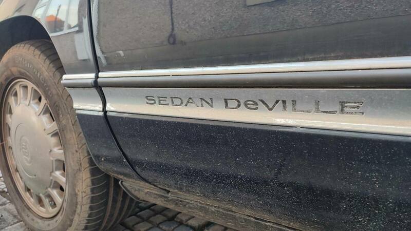

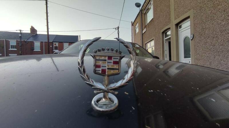

Yes, it has happened! As the title revealed I finally own a Cadillac! And what a beast it is.
What you see below is a 1996 Cadillac Sedan DeVille, Cadillac's FWD (!) Fullsize offering featuring the famous Northstar V8 (similar to that in my Olds Auroras). Yeah, the one blowing head gaskets left and right...
I never really seriously considered getting one as the Rwd, body on frame Fleetwood is way more interesting to me (and even larger). With this DeVille coming up for sale literally 5 minutes from my GFs house, and with a deal to be had, how could I resist though?
I don't have a huge amount of info yet. The car apparently stood in a garage in Sunderland for years before the current owner dumped it in a storage yard only about a year ago sometime around mot time. There it just sat until now, the yard is getting converted into self storage and everything must go. And boy are there some interesting cars there...
The car clearly needs a clean, but with only 77k on the clock and a reasonably easy life it should clean up well enough. Had it run for a while, no signs of omghgf.
Plans are to get it thoroughly checked asap, put an mot on (unless it needs a ton of work, which hopefully is not the case...) and then slowly restore it as I've done with my other cars before. More info soon!
