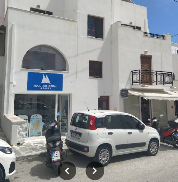

Island #3 and rental #2: Naxos, with a 2020 Fiat Panda 1.2 base model for 35Euros/day. Identical to the one we had there 2 years ago, just white. Decent car, didn't even take a photo so here's it's clone from google maps:
I was hoping for a VW Up! as I have never driven one but oh well.

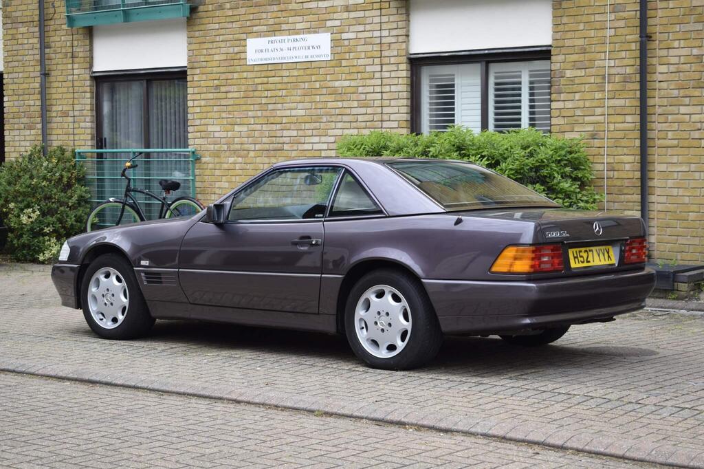

Since the SL was mentioned, it received a bath today. Realistically needs a complete respray too but V8 R129 values (especially in the future) might justify spending the money a little more. I also like it's Smoke Silver color much more than the Coupes...
I'm finding SL500s down a bit this year, but not the best ones, just the bottom of the market has more to offer. Unfortunately I'm still months away from a legal thing finishing so just shoving things on dream list - but plenty of promising M119s on there in four figures still whereas two years ago it felt like £10K minimum 😕

I posted this in another thread - but early, high spec SL500 in Bornite for four figures...
http://www.autotrader.co.uk/car-details/202510026816962
Yeah I've seen it, one of the best colors you can get these in, although it's a color that's looking even better on the W124 and W140 (I still like two-tone Blauschwarz Metallic/Grey a little more though). It's the pre-facelift interior that dates them a little now but that doesn't have to be a problem.

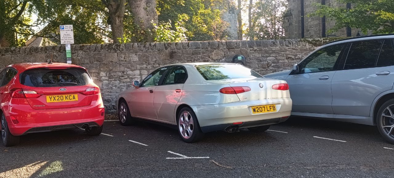

In other news, with the Alfa 166 not blocked in by other cars in it's corner I finally took it for a few journeys yesterday and today. Such a fun car, you  simply cannot drive this car like a normal person.IMG_20251012_154051.jpg.74536a10f4a3808a4ee16358d1cf6f4b.jpg
Where on other cars you cruise along at 2k the Busso sounds more at home at 4k!
Not exactly a big car by today's standards either...

In other news, the Infiniti has swapped places with the ex- @HMC / @bramz7 Alfa 156 that has been waiting in line for an MOT for over a year. I don't have any plans for driving the Infiniti during the cold months and really need to make space around here so the 156 finally gets its moment.
After not driving it for a year its just as great as I remember it. The pulling power of the 20V JTDM from 2000rpm up to 4000 is unreal, the 5-cylinder soundtrack so good. It also helped that despite longterm storage it started right up, no flat tires, weak battery (previously disconnected) or other trouble whatsoever aside from a sticking blinker relay (common fault, fixed itself after keeping the hazards on over night). The longterm ownership of the previous-previous owner really paid off with this one, its a great example. It does need toleave though as there might be a new arrival soon. I'll do the CV boot (and now outer joint after some angry attempts at replacing the former) and see if it needs anything else for the test. It'll need some tickling with the sparkly stick on the driverside sill eventually but it seems solid enough to make it through another test without too much trouble. It'll be up for roffle soon unless someone is interested in an outright purchase.

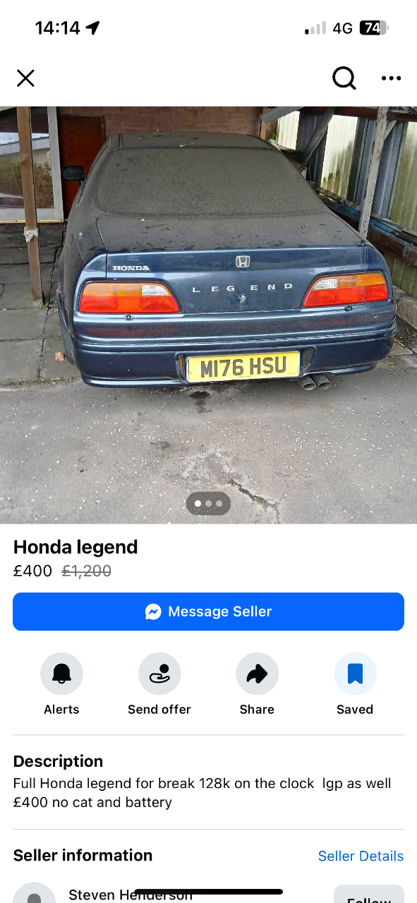

what a shame, were these v6 ? or just plain old v-tec ?
They are all a 3.2 V6, UK models are automatic only but most other markets could have them with a 5-speed manual as well. The US and Japan even got a more powerful version with a 6-speed eventually. Normally they are quite desirable cars but there doesn't seem to be a single one in the UK that's not a rot box or bodged to not look like one.
