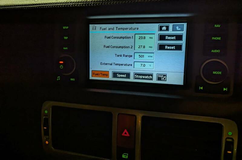

If you ended up around 24-25 mpg I'd say that's very reasonable. That kind of thirst wouldn't put me off - it's miles better than the old Rover V8.
I was seriously babying it to get that. 65mph on the flat might return 25mpg but as you go above that it starts getting thirsty. At 80ish on the way back from Scotland I was getting 20 on the nose pretty much. The old rover v8s are thirsty but I think one of the saving grace for this car is the 6hp26 gearbox. Theyre quite a modern gearbox for the age they are achieving lockup in 1st gear etc. not far off manual MPG.

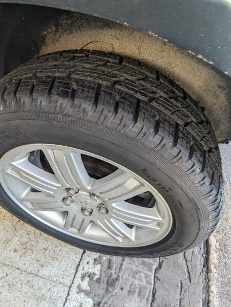

New rear tyres on the back for a grand total of £60. Bought a tyre for £35 off someone and the spare had a branny spanker on it. £25 for someone to mount the new tyre and swap over the spare. Had a look at the suspension components and by god they're beefy. Happy.
Got a wheel alignment tomorrow so we will see if that's out.

Love this, and great to see the care being lavished. What's the deal with The World's Greatest Evil (aka mis-matched tyres across an axle)? Or did you manage to get one that matched the spare?
Too early to call dibs?
All tyres are now pirelli scorpions.

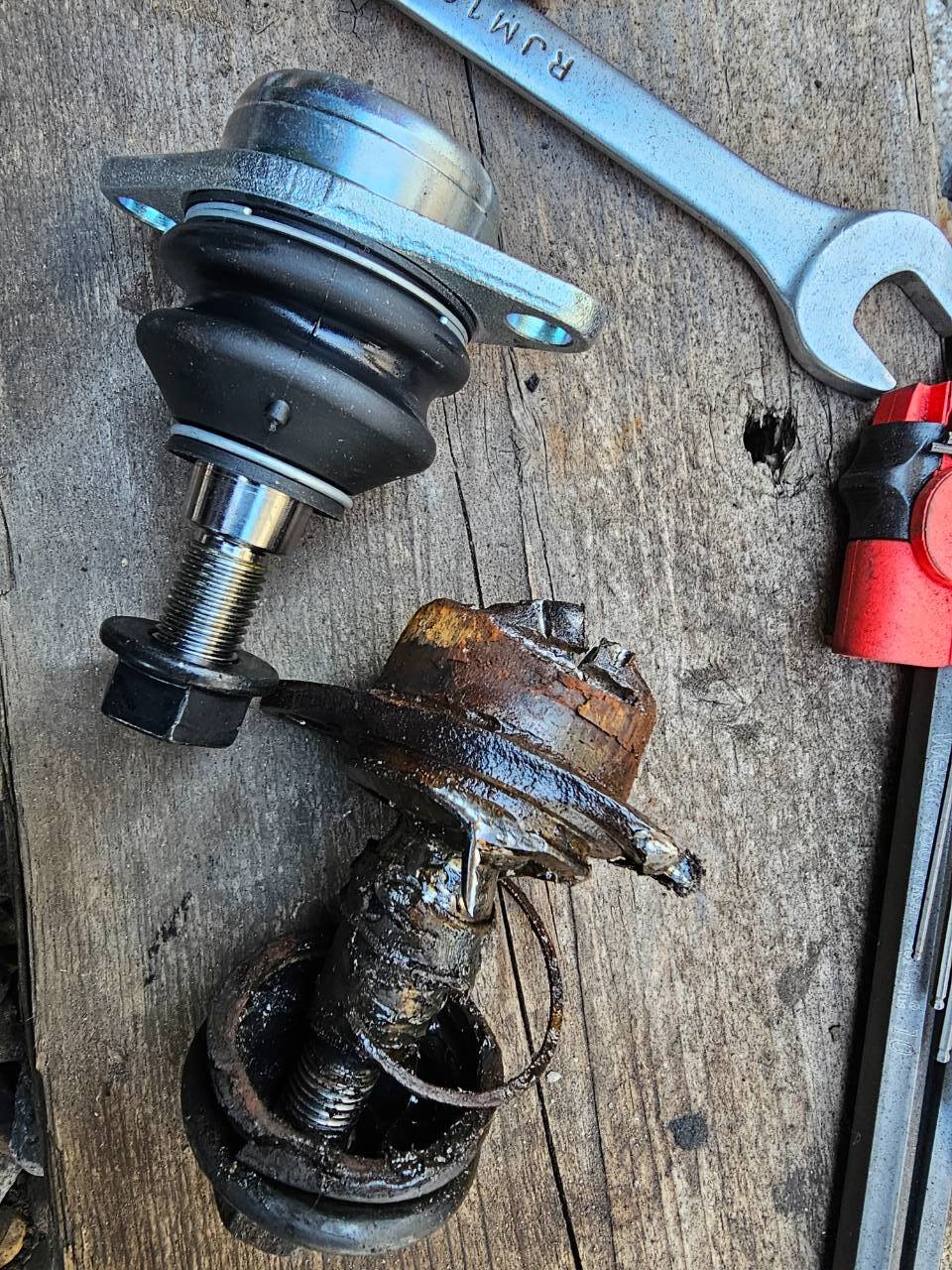

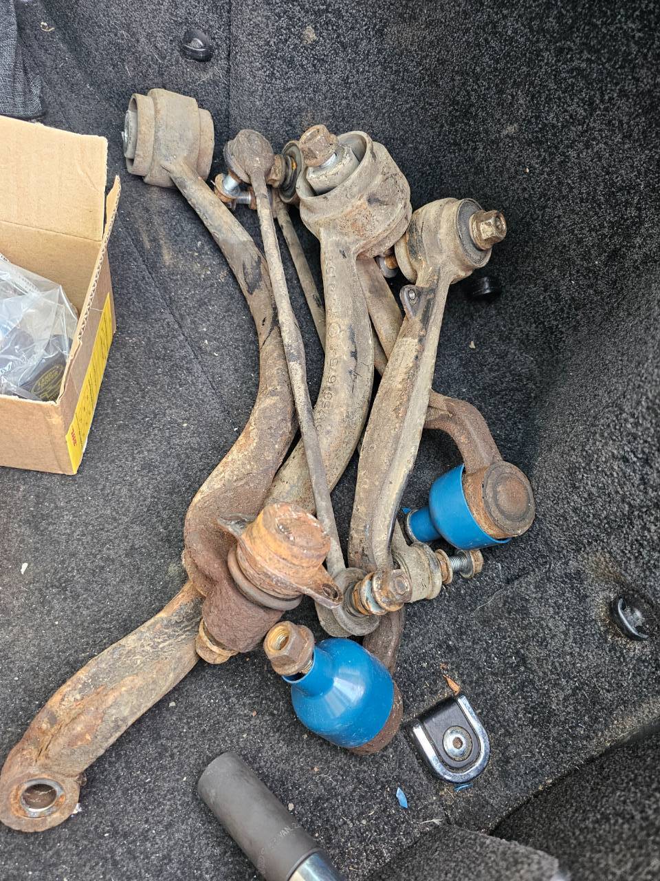

Since getting it off @DirtyDaily I've replaced every suspension arm on the front and back, fitted a brand new pair of front Pirelli matching tyres, genuine oil filler (due to air leak) and many other bits and bobs, have a few pictures
Obviously all the above were replaced with brand new items (as seen stuffed in the large box of parts)
