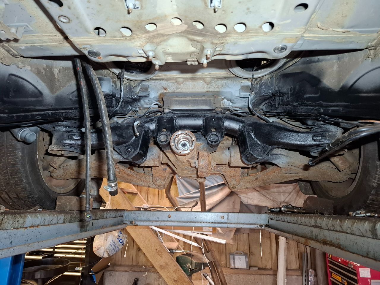

The only not strictly necessary work I did was to needle gun and repaint the bits of rear subframe which are only accessible with the tank out.

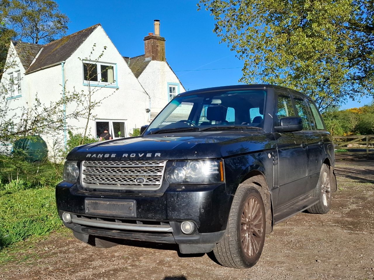

Exhausts etc. Refitted today, and took it for a blat around the farm (sans plates as I don't have any yet!)
By God it shifts.

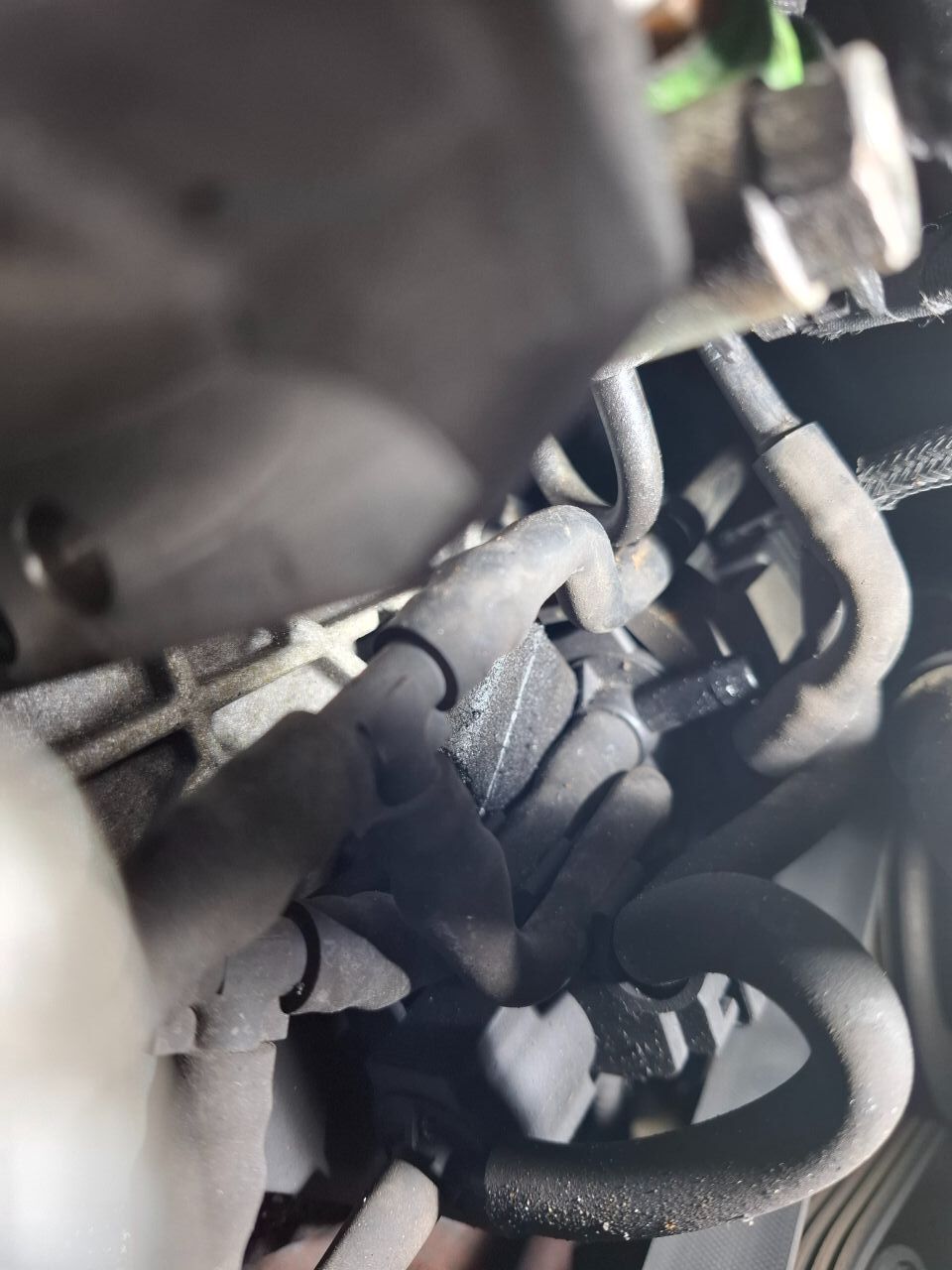

Immediate white smoke and restricted performance. Seems to be a TADTS - when removing the intakes on the 4.4 you inevitably disturb some vac lines for the left turbo. It's cooling off tonight and I'll reattach tomorrow and try again.
It hasn't moved under its own power since Feb so it took a bit to clean the brakes up too but it's rolling along silently now.
If all behaves it'll be time to put the back seats in, give it a damn good clean and service, then figure out what to do with the upper tailgate rust and overspray on the bonnet.

Sure enough found a dislodged vacuum hose near the high pressure fuel pump, which is for the left turbo. Reattached and no more smoke!

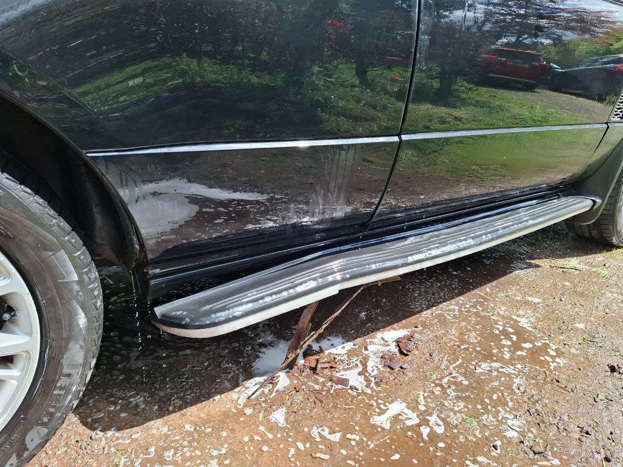

The 5 year old side steps (replaced as the originals were rotten at less than 10 years old) will also be going in the bin as they didn't like me using them to wash the roof today.
