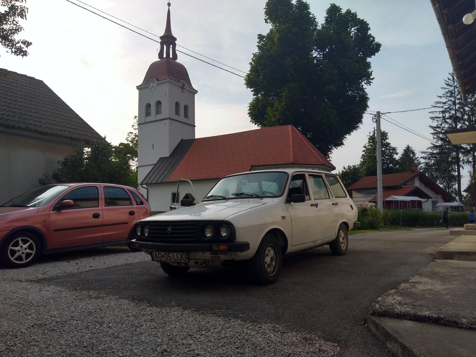

The Mighty Dacia has had fluids topped up and we are ready to go somewhere else.

I'm not sure what it is about the "face" of that Dacia, but from that angle it looks like it's a bit depressed. I can imagine it coming out with a quote along the lines of Marvin the Paranoid Android: "Here I am, 28 years old and being asked to drag myself all the way across Europe"
