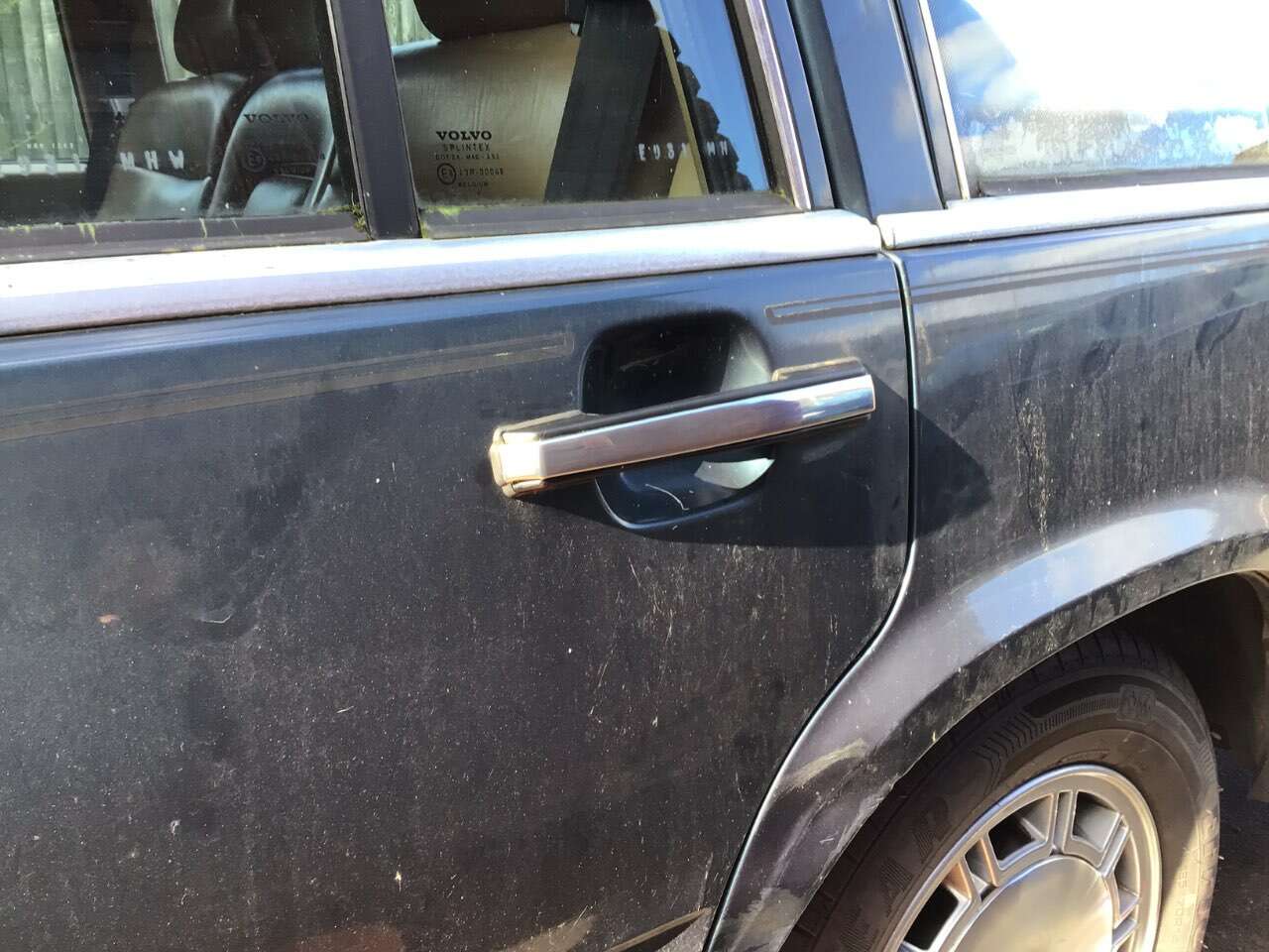

Todays job was to at least make a start on fitting the new door handles.
Decided to kill two birds with one stone and start on the rear doors, as then I can also fix the loose rattling interior door cards while I’m at it.
Door cards on these are really easy to take off, just a few clips, a screw and then carefully slide the brittle plastic handle trims off.
Theres no plastic membrane on these cars, they have plastic covers that clip on over the holes instead which makes things much cleaner and easier. The door handles are just held on with two 10mm bolts and a small screw, these rear doors then have a short link pin that connects the handle to the latch mechanism. This is adjustable and ideally you’re best off not messing around with it… I did not follow this advice! I had to completely readjust it after I was done!

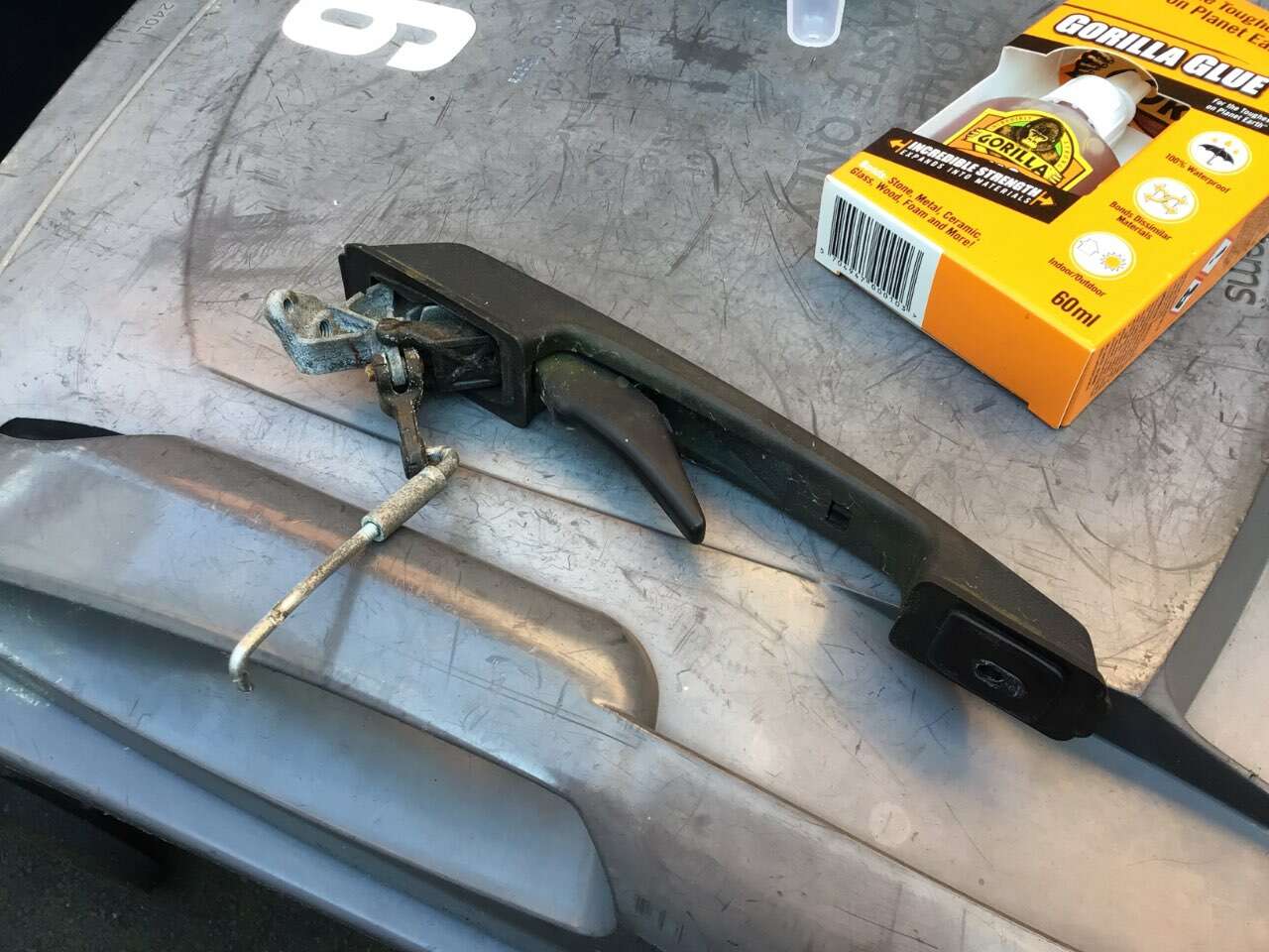

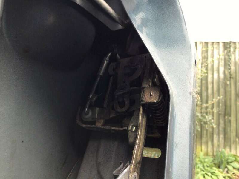

Heres one of the handles removed with the link pin still attached. Probably best I’m changing these handles as this one is starting to crack on the inside mechanism. Eventually it splits and stops the door opening with the outside handle.
Theres not actually a huge amount of space to work in as the handle and latch is right up in the small top section of the door. I lost a lot of skin today doing this!
With the new handle fitted and tested for adjustment I decided to hoover out the door bottoms and spray a load of cavity wax (Dynax S50) inside since I was there anyway. There’s little to no sign of any rust in them but, since I’m there and have the wax I thought why not.
The rusty flakes in the pic are from a steel strip at the top of the door. No idea what it’s for but it’s hidden under the door card normally - that got cleaned back and coated in wax too!
And I’ve also sprayed all the window mechanism, door latches and pivot points with spray grease too just because!

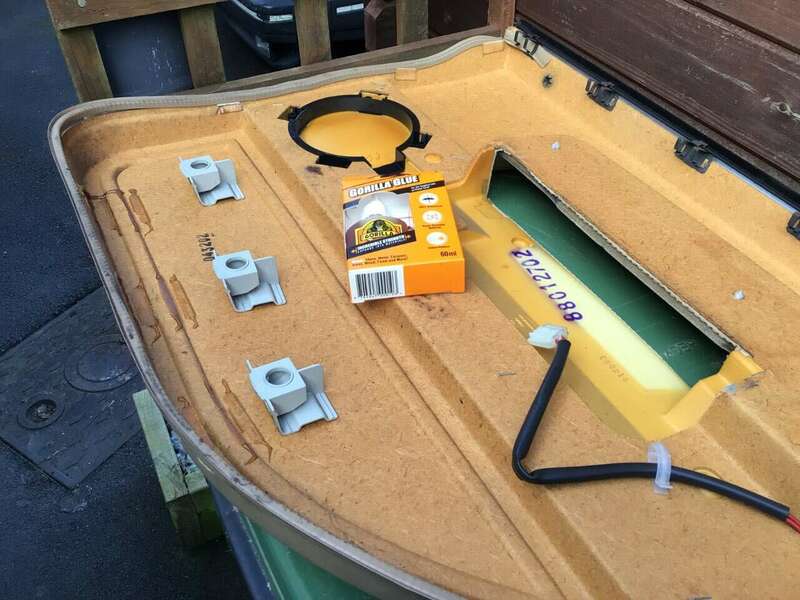

Returning to the door cards, the reason they rattled and were loose became obvious.
Someone has been here already! Looks like they struggled to get the trims off and inadvertently tore the plastic clips on the bottoms off. Normally they’re held on with impact adhesive type glue, so I just smeared some Gorilla glue on instead which took a while to go off (cold weather) but seems to have gripped very well.
Theres also a beige edge protector strip all around the sides and bottom of the cards but this had obviously got in the way before and was just shoved up under the card! I’ll put it back on properly when I put it back together.
And here’s the result!

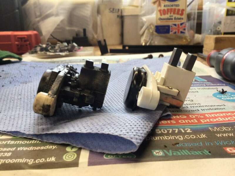

Set of genuine Alternator bracket bushes & regulator pack. These are fairly easy to get but I need them regardless so got him to send some.

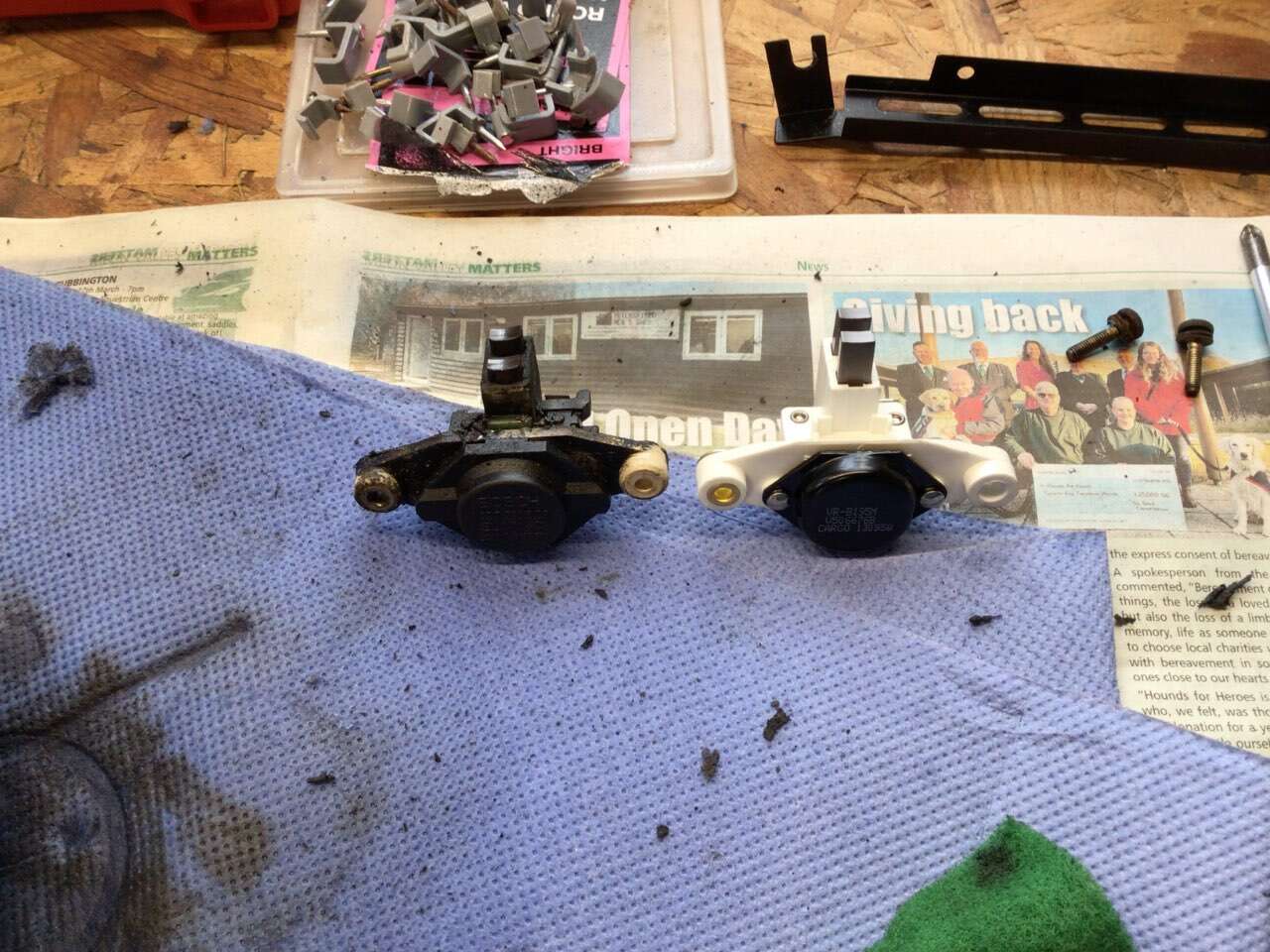

A few weeks ago a box arrived with some bits from the above supplier.
Various bits of new old stock interior trim, alternator brush/regulator pack and set of new old stock alternator mount bushes.

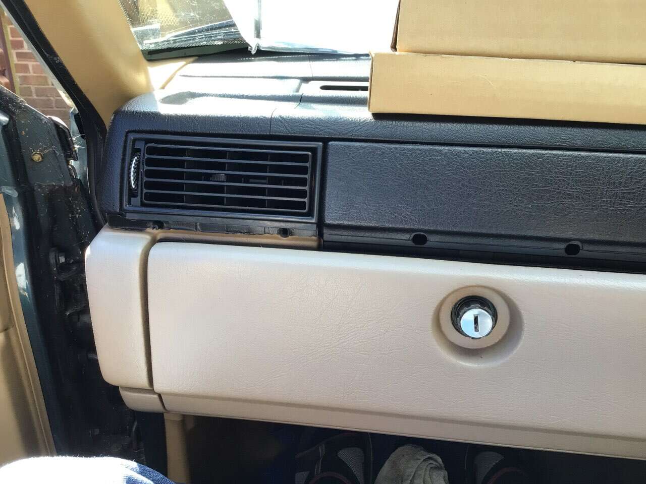

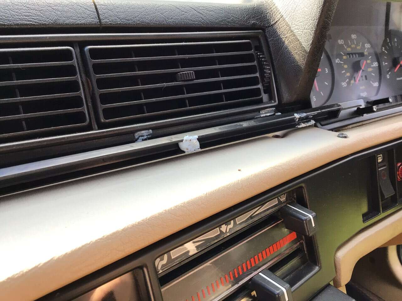

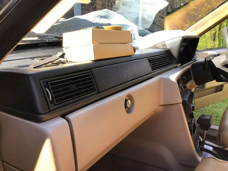

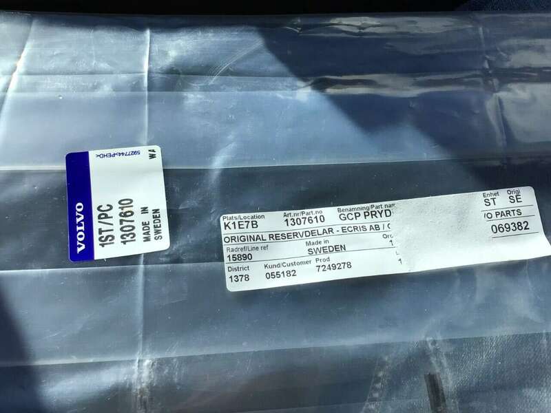

Next job was to sort out the untidy broken dashboard trim strip. This was really annoying as it looked untidy but it also used to flap around and vibrate when driving. All that holds it on are plastic pegs that slot into holes in the dash with rubber tubes around them to stop rattling. On mine the end one had broken off and been ‘fixed’ with bits of blue tack and rolled up tissue paper!? Probably worked for a while but not a good fix really.
The replacement part is new old stock, came in from a Volvo dealership in America believe it or not! LHD and RHD part is the same, just fitted upside down apparently. I doubt these will come up easily anymore as new parts, this one was the last one my parts guy could find anywhere!
Part number if you fancy trying…
And fitted. So much nicer!

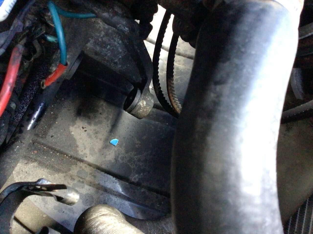

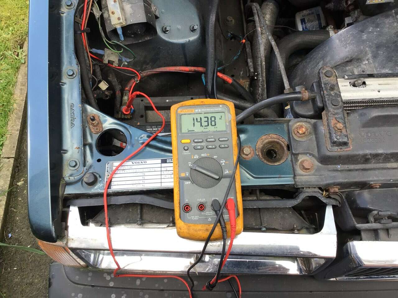

Next job is one I’ve been meaning to do for a while now but just never have!
Digitals!!
Ever since I’ve had the car it’s been charging a bit on the low side. Recently though this has become really quite bad, struggling to make 12.5v.
You can obviously replace the alternator and be done with it but they’re not exactly cheap on these. So getting a replacement brush/regulator pack is the better bet as long as the old alternator windings and bearings are still ok. Mine are thankfully.
It’s a bit of a twat to get at, especially if you’ve got a bad back like I have as it’s right down the bottom of the engine bay, under the rad hose and ATF cooler pipes. And that stupid silver tube for the hot air intake to the air box! That thing pissed me off a lot today!
Here it is loose but with wires still attached. Not much room really. I think it’s meant to be removed from below the car but I’ll be buggered if I’m taking the under tray off so I made it work from the top!
And on the bench. Absolutely minging in grease, oil and crud. It is however an original part so I doubt this one’s ever been removed from the car until now. 35 years!
I gave it a quick clean up but it’s pretty well stained so without painting it it just wouldn’t come up great. For where it is it’ll be ok.
Regulator/brush pack is the round bit with Bosch on it. Remove two screws and pull it out. Easy. Apparently there are a couple of variations on these. Mines an 80A Bosch unit.
Inside, it’s not easy to see, but I’ve cleaned everything with some contact cleaner and a scotch pad to get rid of any tarnishing or corrosion. On this one the copper slip rings that the brushes rub on when it’s in use were grubby but not too bad. There was a slight ridge in it from wear but it should be ok for ages yet.
Here’s the two brush/regulator packs!
Pretty clear what the problem was! The original brushes were utterly worn down and probably struggled to make good contact with the slip rings inside. There was literally no meat left on them! Compare to the size of the new ones. I think I got my money’s worth out of these!
Before that goes back in to the car though it’s worth checking the alternator mounting bracket…
On these theres a pair of rubber bushes between the alternator and its bracket. Exactly like suspension bushes, these wear out and go soggy with decades of oil and heat on them. Then they don’t hold the alternator square and the belt tension pulls it out of alignment which then either destroys the belts or wears the alternator bearing out. Worth changing these since the alternator is out really. You can get polyurethane replacements of these but I just replaced like for like.
Changing them is easy, just remove the bracket from the engine (3 bolts) and press them out/in on the bench. I used a vice, penny washers and big socket.
Old ones, and part numbers…
You can see the bracket and two bushes here - hence doing it off the car is easier!
After that it’s just a case of reassembly, making sure the wires all go back on right, and the tensioner bolt is ok.
Then fire it up and see if you’ve cured it.
Job jobbed I think!
