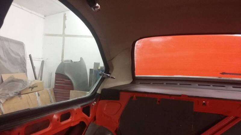

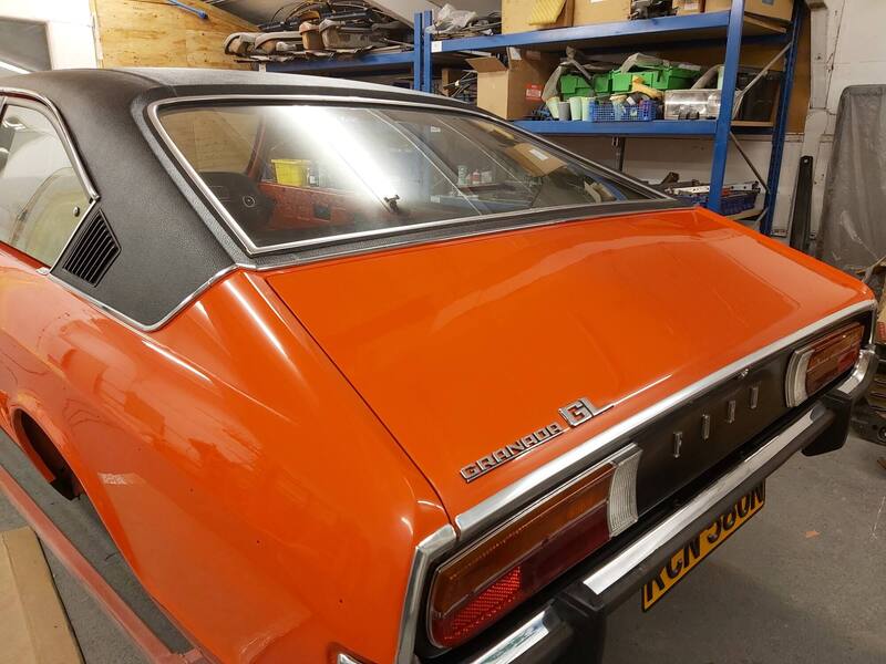

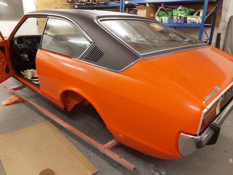

Next I've fitted the rear windows.  This is probably the worst bit of design on the whole car.  The window is held in by the pop out catch at the rear and two very small bits of metal on the B post.  With the window popped open it eventually falls out while driving so they will remain shut from now on!  This is a well-known fault with the face lift coupe.
20200104_165002.thumb.jpg.edacb3f68282028dee0e5f9c83f949c3.jpg20200104_171605.thumb.jpg.3beef4aa7793f3659f108dee4fa1be4c.jpg

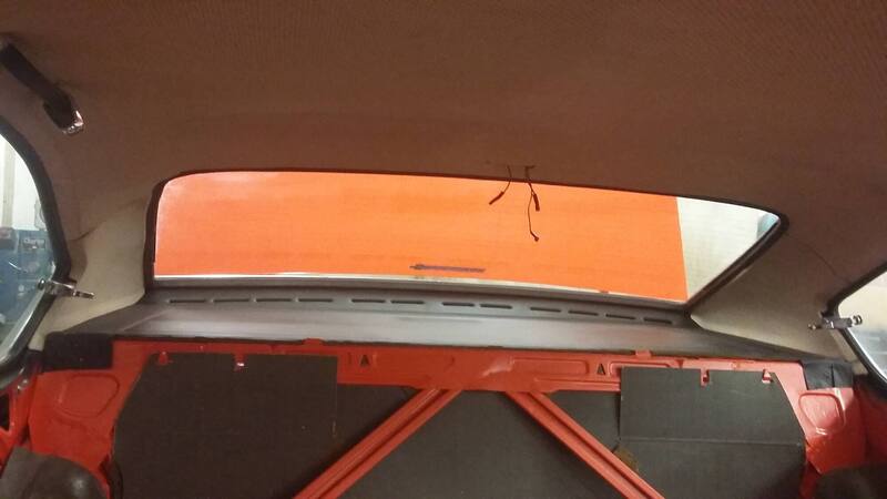

I've also fitted the remaining trim pieces inside the rear of the car.  Starting to look quite nice in here now.
20200104_171914.thumb.jpg.0c93d4a70a4419917a82512f24dcfef6.jpg20200104_171922.thumb.jpg.c46d234ded88d0f83c0b11e4eaa0d088.jpg

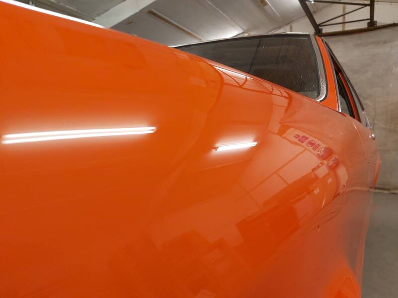

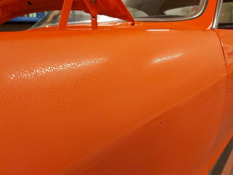

Polishing the paint is a slow and scary process.  I've never done it to this level before but it won’t polish itself so I've made a start.  All the bits I've put on the outside of the car so far have been chosen because they don't really get in the way of the process.  There is nothing fitted to the sides of the car so I have access for polishing.

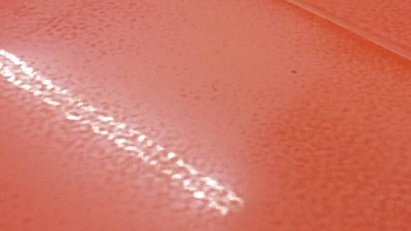

Here you can see the finish as it is off the gun.  Deep shine but plenty of orange peel and when you start looking there is a fair bit of dirt in places.  I expected this as I'm a novice painter.
First thing to do is use a de-nibbing tool to remove any spots of dirt & dust.  I'm using 2000 grit on the tool as it's what’s in stock.  You end up with loads of little dull spots after completing this.
Next I use 1200 grit paper on a DA with a soft interface pad.  This takes down the orange peel and also removes any small bits of dirt and dust.  Be careful of the edges!
Next I move to 1500 grit on the same tool and sand until I have a flat matt finish.  All the time I'm terrified of seeing primer but if you study the picture I'm really removing only the very top surface of the paint.  There is no danger of rubbing through provided I stay off the edges and stick to the method.
20200111_113820.thumb.jpg.daf18eac4cc40e7d34ba1935b20667dd.jpg20200111_114953.thumb.jpg.3154a14dc1eb630de9714c40c27c1f2b.jpg
Next I move onto 3000 grit 3m Trizact disk.  This removes all the 1500 grit scratches and starts to move us back towards a shine.
After this I should have gone to a 6000 grit Trizact but I didn't have any.  I've ordered some so will have a go next weekend.  In the absence of those I moved to polishing using 3m green & blue pads/compounds and a decent polisher.
20200111_132906.thumb.jpg.010299ad024334bcf2c0d1451f78a40e.jpg20200111_134410.thumb.jpg.2a1b05b1f96861d17f71796fd824ab0c.jpg
Not bad for a first go.  I didn't make any major mistakes but due to lack of confidence I've not fully removed the orange peel near the edges and a few small areas.  I also needed to spend more time on the polishing stage.
I'll revisit the again with 1500 and follow up with both Trizact disks.

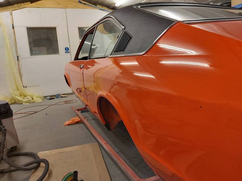

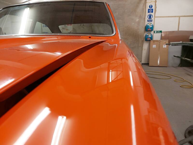

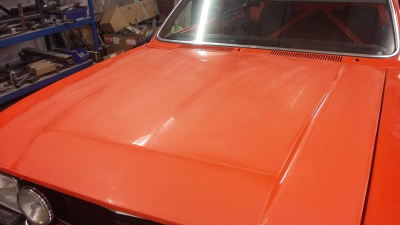

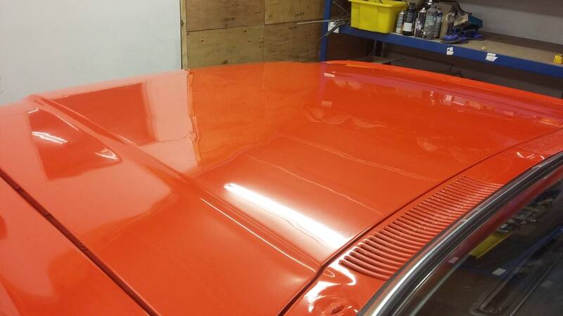

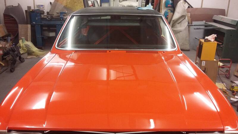

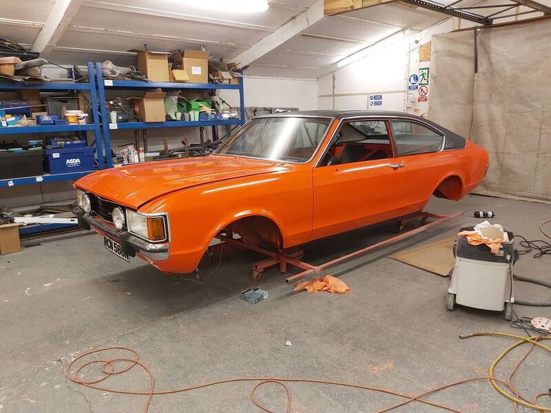

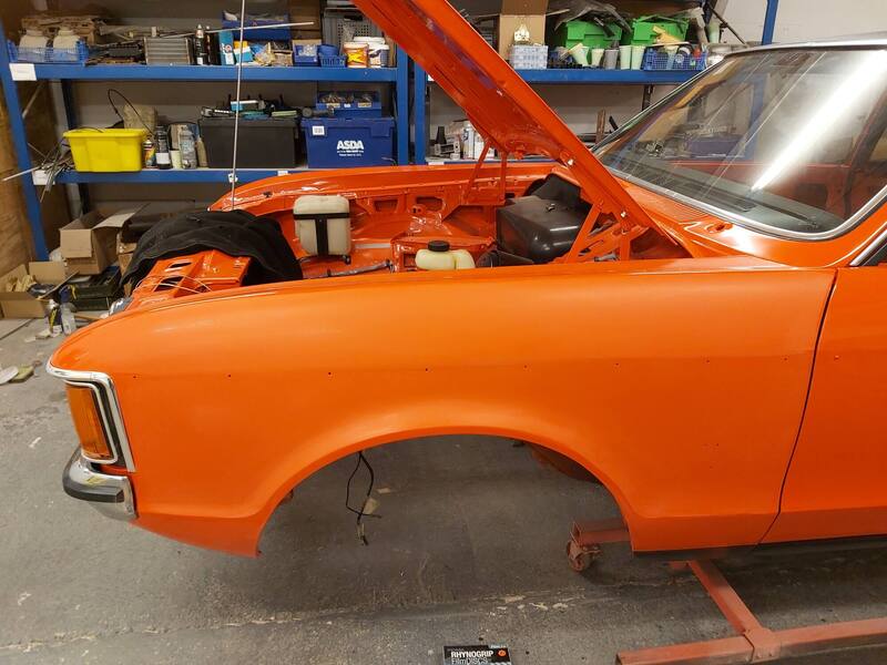

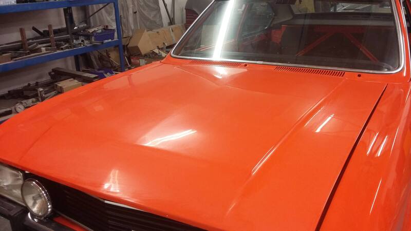

Got quite far flat & polishing the car today.  The bonnet, boot lid and drivers side are now complete.  About 6 hours of work.
First I spent some more time on the bonnet and got it looking better.  Pleased that most of the surface imperfections on this panel have now gone.

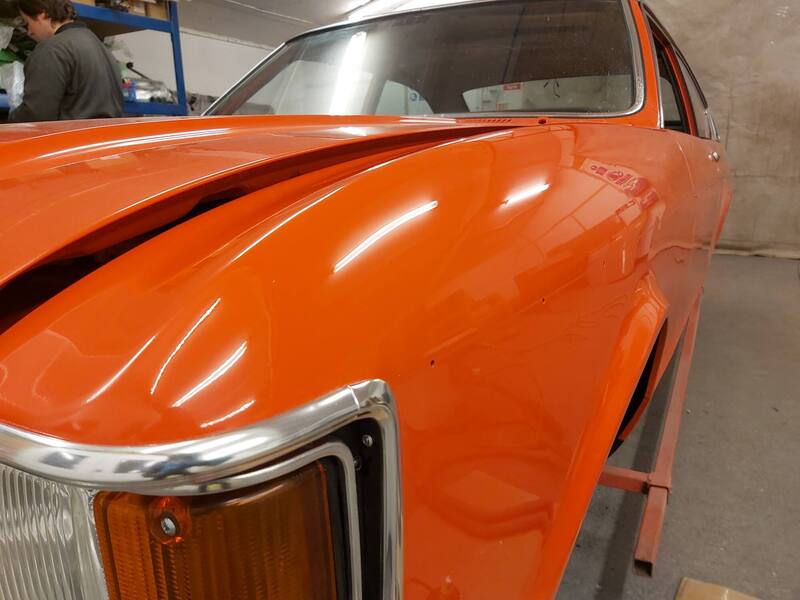

Next up was the front wing.  The shape of panel means I have to take more care and use a combination of machine & hand polishing.
First pass with 1200 to take the top of the orange peel off.  I then use the finish below as a guide coat for the 1500 grit stage.
20200118_103201.thumb.jpg.cd24401cc83371463a95278731c77aba.jpg20200118_104740.thumb.jpg.f416ac0ac9c4fb08692293c6536e4e40.jpg
Second pass with 1500
3000 grit trizact disk
6000 grit trizact disk
Polish with 3M green mop & compound
20200118_113438.thumb.jpg.65f21a7a71ff2bbcdf6b5ae79f40b50c.jpg20200118_113621.thumb.jpg.de39d96fd21ff4aed1895ee9414e1173.jpg
20200118_113633.thumb.jpg.1beafebb1cf620c48835537f921dcef8.jpg20200118_113643.thumb.jpg.ef6620ef98ef6d5563229e2d257d273c.jpg

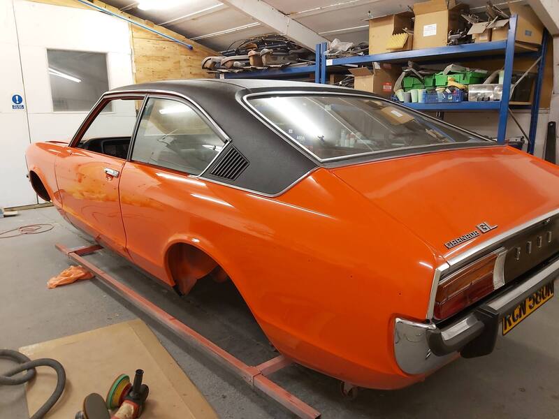

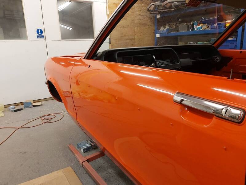

Worked my way down the car and did the door and rear quarter.  The quarter took a long time, its huge!
20200118_124551.thumb.jpg.381f570b4ea197df211591e259d09c23.jpg20200118_134656(0).thumb.jpg.fcc538a0616f157a8ced7848eb45a8f3.jpg
20200118_141049.thumb.jpg.63001355907fd88ddbedfc102ccc1251.jpg20200118_141110.thumb.jpg.f64caa2ba73486d773e167f0191ac693.jpg

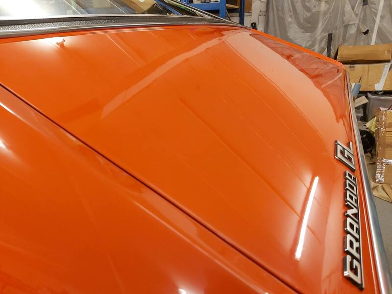

Then the boot lid
20200118_154130.thumb.jpg.75d5b7777d48971859b330e3e0d4059e.jpg20200118_154141.thumb.jpg.9954d51830756ecfd5339b5520a46dd6.jpg
That completes the drivers side.  I'll do the other side next week.
20200118_171206.thumb.jpg.e1b8d4e214a6ebf577cd7d4a793726fd.jpg20200118_171218.thumb.jpg.424ecbe8638fcad6fe5d6ebb07d26a3e.jpg
Very pleased with the result.  Removed most of the orange peel & surface imperfections in all the panels I treated.  Looks like a professional job now, amazing what you can do with the right equipment.  There were a few bits I was worried about but they just polished away.  Good learning experience all round, looking forward to the other side.
