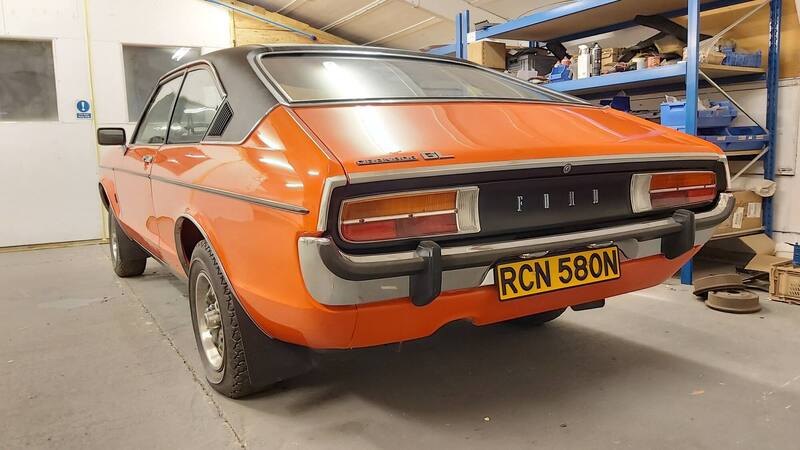

1975 Ford Granada Coupe - Lots & lots of tinkering

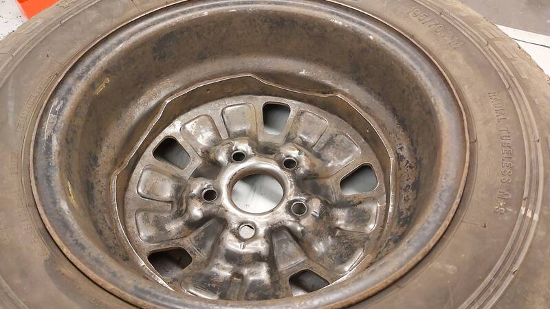

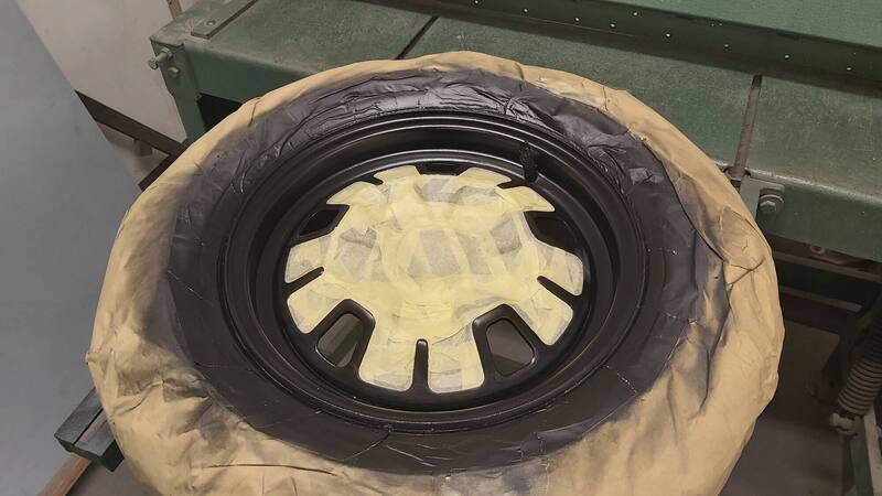

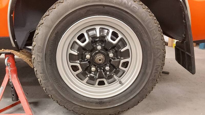

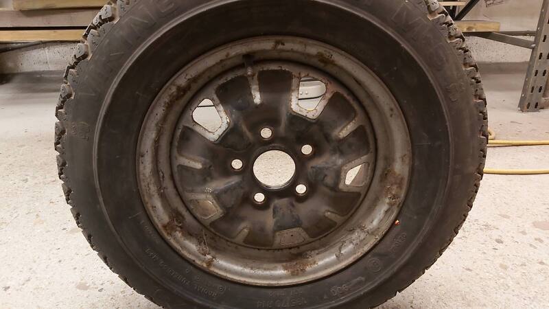

I popped the chrome and caps off the wheels.  They were a bit of a mess, cosmetically challenged you might say.
20200718_131655.thumb.jpg.54bd198ad40b92ab580e4d354130d8f7.jpg20200711_140418.thumb.jpg.c61666528e102bea9f6f58fd9353004c.jpg
I could get the tyres taken off and run them down to the blasters but I'm trying to save a few quid.  I can do these myself, just a matter of time.
I removed as much rust and old paint as possible.  They've survived well considering nobody's touched them for 45 years.
20200711_140341.thumb.jpg.0dd5f1436fe8d047058bee702464500f.jpg20200711_140353.thumb.jpg.e012bd1a5cdcdaa871ffc49526bb3c31.jpg

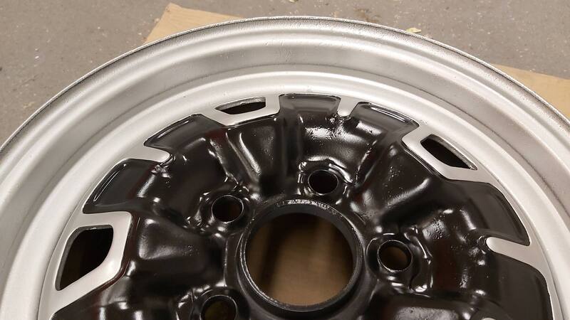

Applied a rust treatment to the entire wheel.  Turns to a black paintable surface once it's finished doing its stuff.
Masked up the tyre and valve stem.  The tyres will be replaced but I don't want to stare at overspray while I continue to use the old ones.
Heavy coat of etch primer.  Then some sanding before a heavy coat of satin black.
Then masking and lots of it.  Wheels of this style are a pain to paint, but the results are well worth a thorough masking job.
Some strato silver and a splash of lacquer completes the wheel.
The spare doesn't have a tyre on it yet.  Very pleased with the masking job, I touched in any imperfections with a small brush before applying the lacquer.  Took about 13 hours to do all 5 wheels, glad its over!
20200718_181346.thumb.jpg.bf6cc26f132343e70d7708f5dc7accb7.jpg20200718_181351.thumb.jpg.bb91558c0fb7e2b127cec0800e65a5dd.jpg20200718_181403.thumb.jpg.d1717036c8e6bb20216d839b7b793fae.jpg20200718_200822.thumb.jpg.67e89fe581ab24692606f08356193edf.jpg
I'll fit the centre caps and chrome embellishers at a later date.

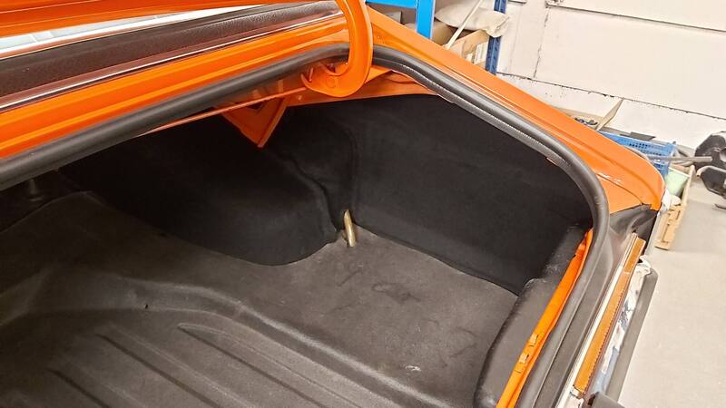

I've also done some upholstery in the boot.  Originally there was black carpet and it's all knackered.  Cut and glued in some new stuff.  I've used some campervan type carpet that can be stretched and molded to complex shapes.
Still a way to go yet.  Gets better with each weekend, well chuffed with the wheels.

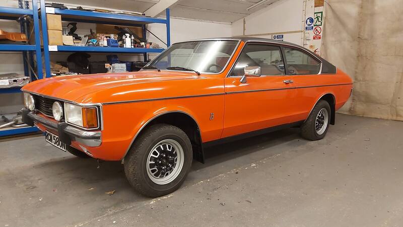

Excellent work on those wheels! They're such a defining part of the Mk1's look.
I wonder how they did them when new?
Great job, those wheels look absolutely fantastic.
I always thought those wheels looked the best on Mk1 Granada's, it's quite a "heavy" shape but they lighten  the look of the car somehow & make it look sportier.
I wish manufacturers today could just make cool looking steel wheels, I really don't like alloys &  plastic wheel trims piss me off.
I reckon it's steel masking mold. Plop down and paint as you would.
From the factory ones I've seen they used a masking mold.  A factory wheel has plenty of imperfections from the mold being tossed on.  With sheet metal they just lob the panel in the jig and let the sparks fly.  I guess the paint shop used similar methods.
A more robust mass-production version of this (a kit for MGBs).
I had a pic somewhere of the 70s 13" 8-hole sports-wheels being painted. They made millions of them. Wouldn't fancy the job of hand painting all those with black enamel and a brush.
You used to be able to buy a mask for Ford 13” sports wheels painting, often sold in the little kiosks at car auctions with the gallon tins of tyre black and sticky numbers for windscreen pricing.

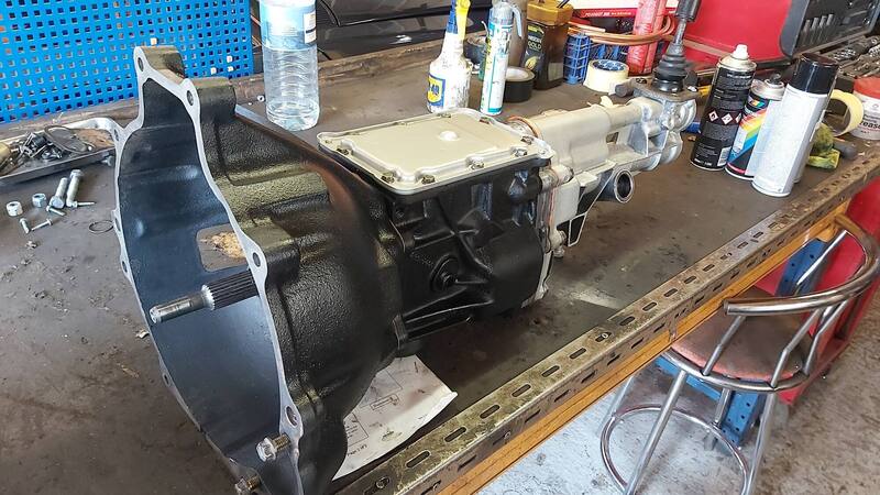

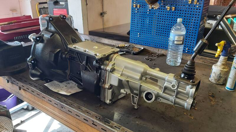

Time to look at the gearbox...

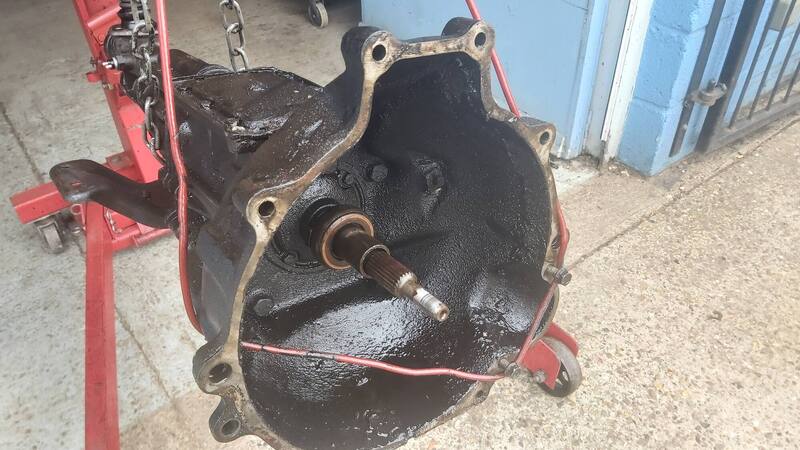

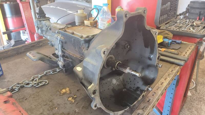

I have the original 4 speed unit which I think is a Type E but I may be mistaken.  I've driven many Capri's, Consuls & Granada’s with a 4 speed box.  For me personally they cry for 5th gear at 70 and Ford's reluctance to offer overdrive or 5 gears in the late 70s/early 80s really shows on today’s faster roads.  I'd planned to put a 5 speed in my car from the beginning of this thread.

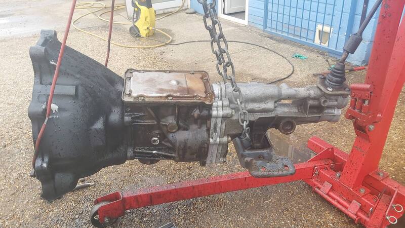

Fortunately working in my profession the right gearbox is never very far away.  Here we have an early 5 speed type 9 from about 1983.  It came from a 2.3 mk2 Granada which I have driven so I know it’s good.  Being a 2.3 it’s got the right input shaft and bell housing for my engine.  Should be a straight swap.  It’s covered in oil from the 2.3 it was attached to, so much oil I'd say that engine leaked from day one of ownership.
1013427203_20200725_112010(1).thumb.jpg.388a952962c8f303a718ef04301a5d49.jpg20200725_112017.thumb.jpg.5523718e866a76bc176fadc8c98891d2.jpg
After a massive degreasing session it came up quite well.
20200725_115752.thumb.jpg.9b973b650cc806eb9885117af7a5c6e2.jpg20200725_115805.thumb.jpg.d728d277918868a4b2378e9309ad53fa.jpg
I'll take some of it apart and replace the essential gaskets and oil seals.  I don't think it leaks but I'd rather put some fresh gaskets & seals in it,
20200725_122531.thumb.jpg.02b122244bb84d2bd61bdd35d7d9709e.jpg20200725_135215.thumb.jpg.ea39d341215c930404ae0f736a44808b.jpg
Only issue is the bolt for the cross member bushing has seriously corroded into the tail shaft housing.
20200725_141323.thumb.jpg.442872bee8344e60accbdd7107e093e3.jpg20200725_141906.thumb.jpg.572d8be7c5cd671c830bb1bff0f832e4.jpg
Despite several attempts at removing the sheared bolt with 19mm nuts and welding it just continued the shear until there was nothing to weld to.  I drilled the rest out and re-tapped the hole.
Lots of cleaning, degreasing and a few seals & gaskets.  Primed & painted all the various parts ready for reassembly.
Chuffed with the results and it still goes in all the gears!  I left the gasket between the box & intermediate plate because you have to remove the main shaft to replace it and I didn't fancy that.  I'm no gearbox expert so I always get a bit concerned when I start messing about with them.

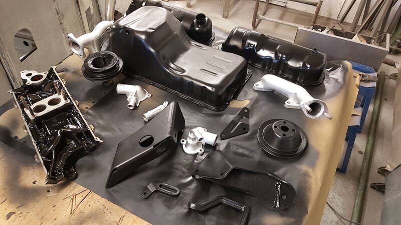

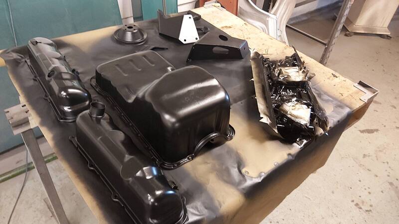

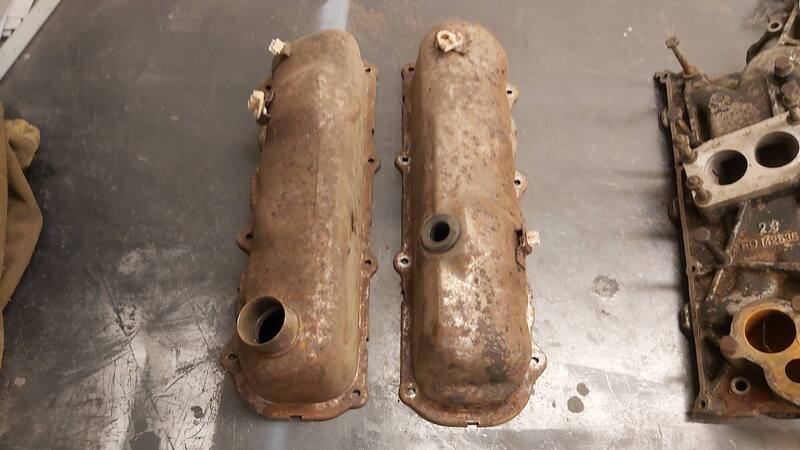

Started the process of cleaning and painting all the various mechanical bits left.  Nothing complex but it certainly takes a while when its all this rusty.
20200808_085532.thumb.jpg.e252f09a2ad512e869b80df688a3af5f.jpg20200808_085540.thumb.jpg.dddf498d7fa08af7330480cadafdb687.jpg20200808_085554.thumb.jpg.e14390878a671cc622a3f5d0b7f88156.jpg20200808_085604.thumb.jpg.22e4c3c404df44567c30f53c87204ba9.jpg
The alternator will probably get rebuilt as its the original unit.  I've been let down by too may ebay/cheapo/generic alternators & starters on classic cars.  If possible I try to save the original ones as they end up being more reliable.
20200808_115012.thumb.jpg.6c8902f31a738df57957bfc2166bcc5c.jpg20200808_115154.thumb.jpg.b93c1bd12a893f8e798d5ab4c868e33a.jpg
Lots of cleaning with various air tools and brushes to get everything rust free.  I've not painted the rocker covers or sump on the inside as I don't want to risk anything getting into the rebuilt engine.  For now I've coated the insides with oil to keep them fresh while in storage.
20200808_131810.thumb.jpg.813331228d1c6420203fffc07e6ac1db.jpg20200808_133341.thumb.jpg.db025c78ffd8665d8f0be4d87861836f.jpg
Is that just a standard satin black paint or some exotic mix to replicate the factory finish?
Years agp I remember reading about a chap who restored a mk3 capri. He experimented with thinning down the coating applied to brackets etc to try to match economy driven measures in the factory with the colour not clinging as thickly to certain bits of contour (!) His obsession seemed to be replicating the factory assembly as closely as possible so curiously although he had very high standards in some areas he aimed lower than best practice to achieve his aim.

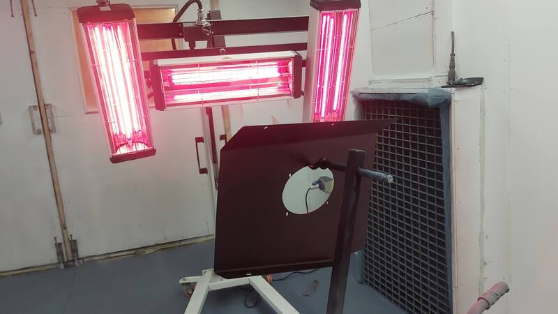

I've gone the other way and while sticking to the factory colour scheme I've been taking more time with the paint.  Everything is taken back to bare metal, etch primed and given a heavy top coat with lacquer on top in some cases.
For the engine I'm just going with satin black for brackets & tinware with gloss black enamel for the intake, block and heads.  A factory finish looks amazing but in practice lasts about a year.  I want to drive the car quite a bit so I'm doing everything I can think of to make the finishes last as long as possible.
