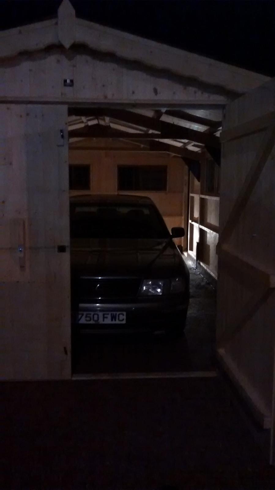

dollywobbler Posted February 20, 2018 Author Posted February 20, 2018 Hey, remember this? It's STILL here! Invacar and 2CV turfed out of the garage, as the Honda needs discs and pads. I'm hoping that'll cure a slightly sticky nearside caliper, but will naturally investigate once I get the wheel off. My garage no longer feels quite so large... chaseracer, Coprolalia, RobT and 1 other 4
loserone Posted February 20, 2018 Posted February 20, 2018 Have you ever tried to fit the LS400 in there? I planned our garage around having an MX5 in there, which I'd got rid of by the time it was built and had been replaced by an LS400. It was pretty depressing to see how little space was left around it..
Noel Tidybeard Posted February 20, 2018 Posted February 20, 2018 your garage lighting seems a little feeble there mr wobbly! barefoot 1
dollywobbler Posted February 20, 2018 Author Posted February 20, 2018 I doubt I'd be able to get out of the garage if I did manage to squeeze the Lexus in... Lighting isn't great, but LED inspection lamps are cheap.
