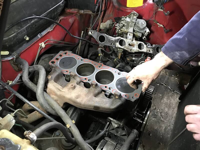

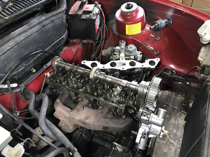

On the basis that refitting is the reverse of removal, have some photos.

Yes. Extremely well. I only wish it stopped as willingly! The brakes have certainly not benefitted from 15 months of unemployment, but they’re good enough which is - in fairness - a metaphor for the entire car.  The manual choke cable needs running into the cockpit and affixing discretely, which is a job for another time. Meantime, I can just hold it open and get the wife to start it for me (!)
Alf is concerned that it’s a bit Cammy. I have to say that, at full throttle, it sounds wonderful; a real parp erupts! It is now wonderfully responsive and, best of all, dry as a bone.
As always, my thanks to Alf. I’m not sure why he suffers a fool such as me so gladly - but I’m forever grateful that he does.
its a pinto- fraud built them with square camshafts! ?
this is what a pinto should sound like
This is a brand new Cam Shaft! It’s a genuine FoMoCo item - exactly the same part number - and came all the way (in its original box) from Eastern Europe. I was absolutely delighted with it - hoorah for the internet!
