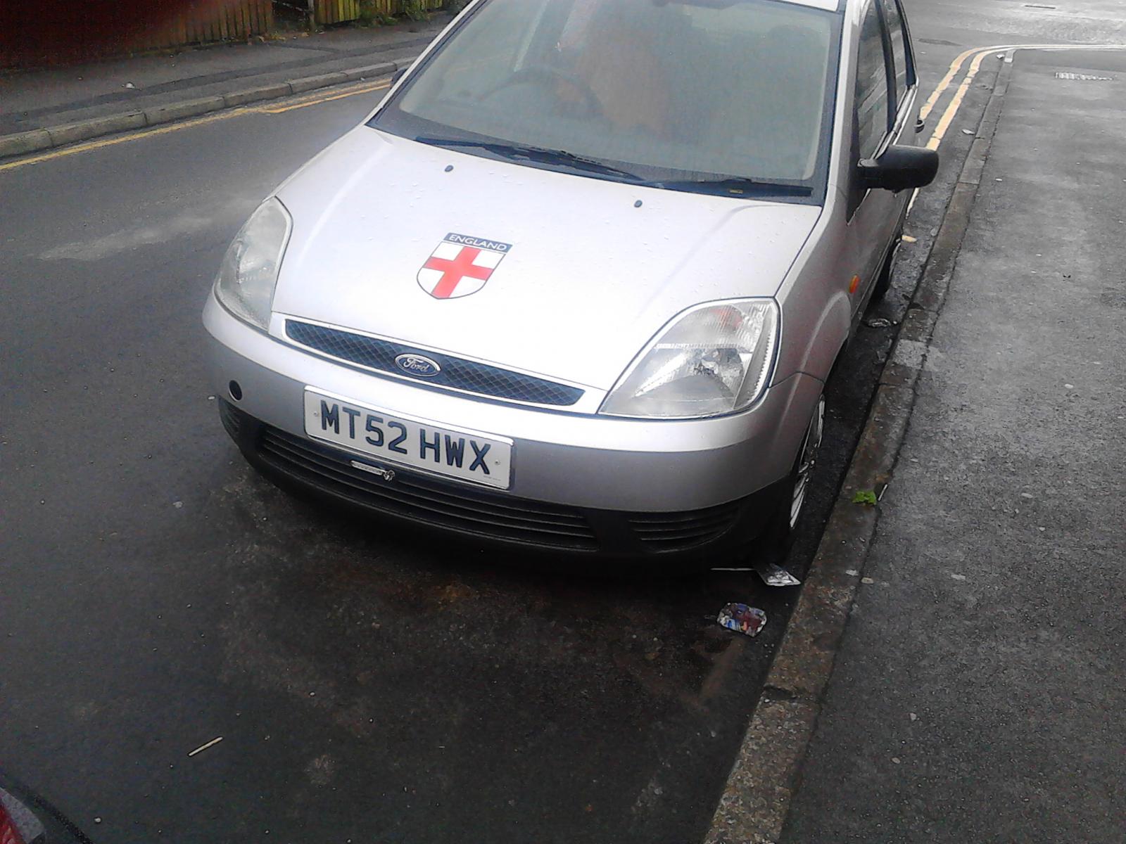

heres the pictures,went to breakers,got a coil pack,plus leads,due to the old one had a chunk missing out of it,!!!got a new no name o2 sensor £20, :-D did a compression test all cylinders around 200,so no damaged valves,got some spark plugs,fitted them,removed old coil,leads,someone had tie wrapped the previous leads,fitted other coil plus leads,misfire now gone,running great,someone on the prv had mixed up leads 2,4,causing the misfire,plugged cde reader in cleared codes,gave it 50 mile drive all clear :-D now to front tyres,both very worn,and one buckled wheel,wheeltrims i got on clearance  £3.00,few dents,who cares...
