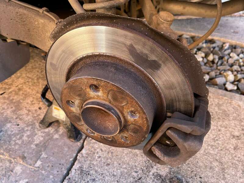

First up: Mrs 83C’s Mini Countryman. Easy job, set of rear pads and wear sensor.F34ED07A-5384-479A-862F-8251BFC4DA20.thumb.jpeg.e40d7e9d22fccbd40b8969bd90de8d57.jpeg
Discs are ok at the moment, will probably want doing next year. Of course, it couldn’t just be a simple job, took the n/s/r wheel off to find the inside scrubbed away. Therefore:
Tyreforce in Shrewsbury were spot on, took the wheel down there and was in and out in less than 10 minutes. Not bad at all for an odd size needed asap, usually have to wait a few days and order something in.

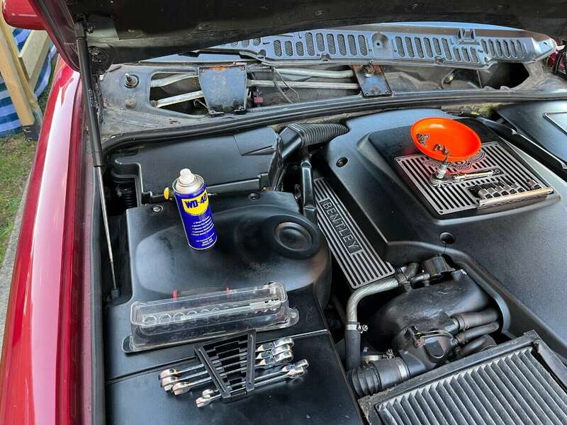

Next up, the wipers on the Arnage. The biggest problem with these cars is finding any information at all about them, parts numbers and whatever else are a pain to find. Parts can be found from the likes of Flying Spares and other specialist breakers/parts suppliers, but they tend to carry a £howfuckingmuch price tag and not much in the way of information.
Tools out, scuttle panel removed. Helpfully the fasteners holding the wiper mech in place all appear to be made of cheesium, as the two hex-head bolts I tried undoing both started to round out rather than undo. Lagged in WD40 and fingers crossed.
Decided to see instead what could be done with the motor in situ, and access is awkward but not impossible. Next stop was trying to find a part number.
Looks to be a Marelli TGE422. Not sure if the ‘G’ is important or not, but I can’t find a listing for a Marelli TGE422G. Can find several references to a 422 B, or a 422 M or other suffixes, but even the MM catalogue doesn’t list the Bentley application, as these are all the 422 applications listed:
I’m fairly sure many of the common parts on the Arnage will be variants of mainstream stuff, but obviously being the Bentley version the main difference will be a ridiculously inflated pricetag. The only spare wiper motor from an Arnage that I’ve found comes with the mechanism and is over £500 as a ‘recycled’ component. Searching for Mk.1 Freelander wiper motors gives a new motor at less than £40, which is much more palatable. Question is, will it be a direct swap or are there differences such the wiper sweep or wiring? Looking at photos it looks the same, so I might just bite the bullet and buy one, ideally from a local source where I can send it back if it isn’t right.

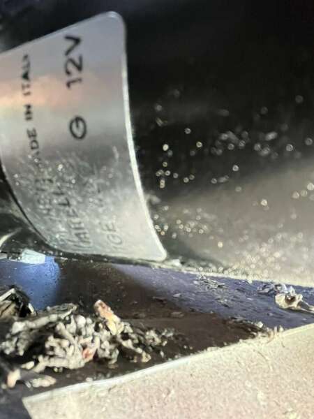

More windscreen motor musings.
I seem to be gaining far more knowledge than is healthy about Magneti Marelli TGE 422 wiper motors. It seems this one is a bit of a bugger to deal with, and is rarer than other variants in having six terminals in the electrical box rather than 5. And there are at least 3 variants of 5 terminal motor too. Unfortunately with this one, there isn’t even a plug for the loom, it’s like the wires have been direct-soldered to the terminals and then the whole thing has been filled with foam:
Nowt more I can do with that. So, on to the gubbins underneath.
Looks fairly gunked up. Question is, how does the park switch work, and is it even part of this bit? Either way, it’s getting a clean:
I’m guessing the two terminals to the middle and left are contacts, the terminal to the right hasn’t got a contact on it and there doesn’t appear to be remnants lost in the grease. Going to clean as much of the grease off as possible.
Anyone know what grease is best for putting back into a wiper motor?
I would try Dielectric Silicone Grease, I dont tink you can go far wrong with that. Garage shops sometimes have small sashet;s  of it, and its white in appearance.  Bought  a small 50 Gram tin to use on a Video Cassete Player mechanism a few months back, £3.90 from Ebay. It was overkill for what you need. Good luck.
