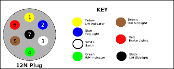

dollywobbler Posted June 3, 2016 Author Posted June 3, 2016 As this is meant to be a towing vehicle, I thought I'd use my trailer board to test the electrics. Not a sausage. Followed the wiring back. Oh. Someone went to the trouble of removing the interior panels to thread this wire in, but then didn't actually connect it up! How odd. Now I need to work out what the wires do.
oldcars Posted June 3, 2016 Posted June 3, 2016 Is that the wiring that goes to the socket on the towbar? If so this may help.
JohnDeere Posted June 3, 2016 Posted June 3, 2016 An hour ago, I didn't know mechanical airbags existed. Now, I've discovered that there are TWO of them on my driveway! XJS is also so equipped. Must remember never to thumb the steering wheel... Wow, just read up on that - also never knew these existed. Presumably they are just as effective and reliable - otherwise we'd have heard horror stories. Bang.
dollywobbler Posted June 3, 2016 Author Posted June 3, 2016 Is that the wiring that goes to the socket on the towbar? If so this may help. Already have that side. It's the vehicle wiring that's the tricky bit. Especially as I can't remove either rear lamp cluster... oldcars 1

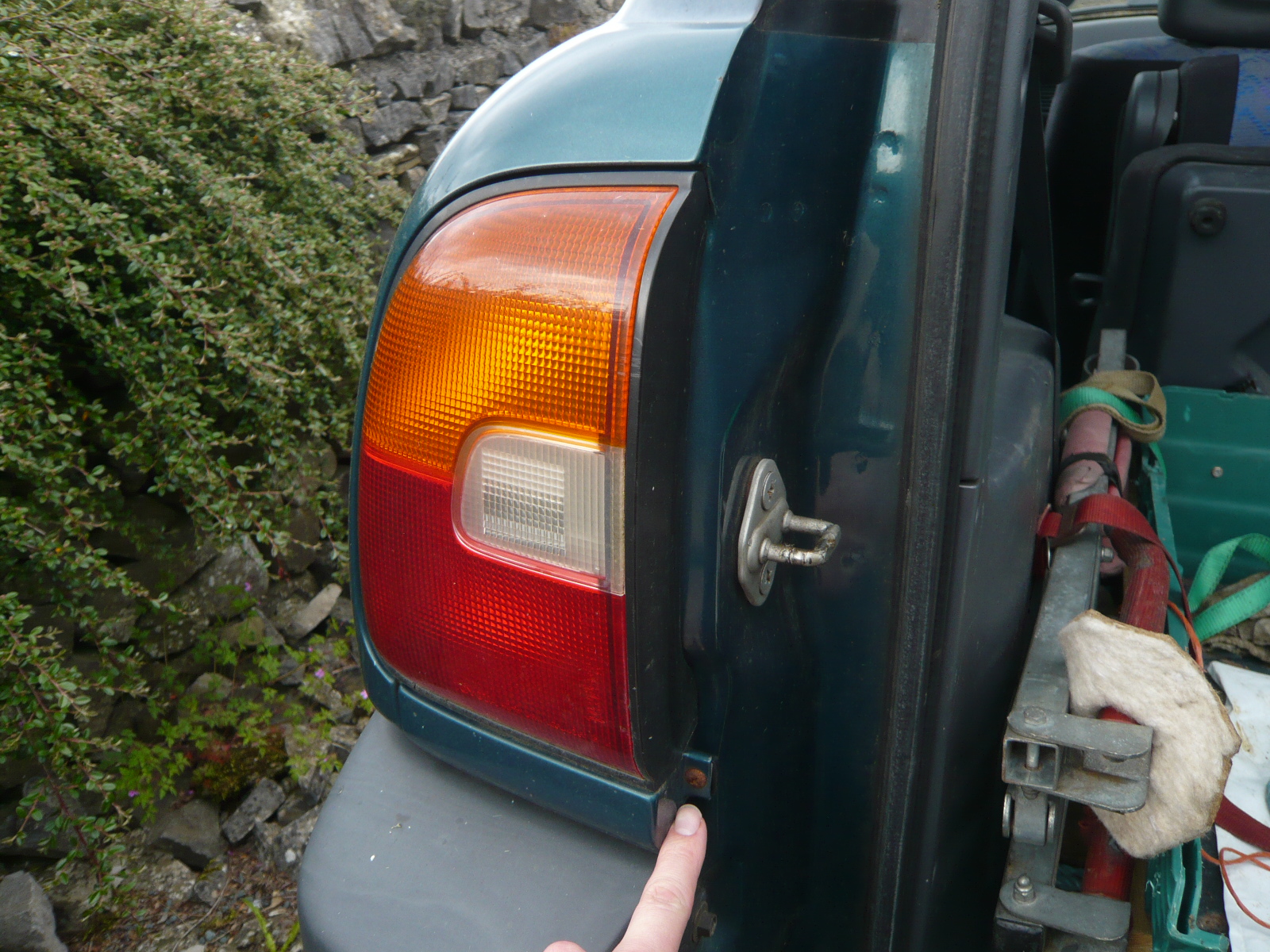

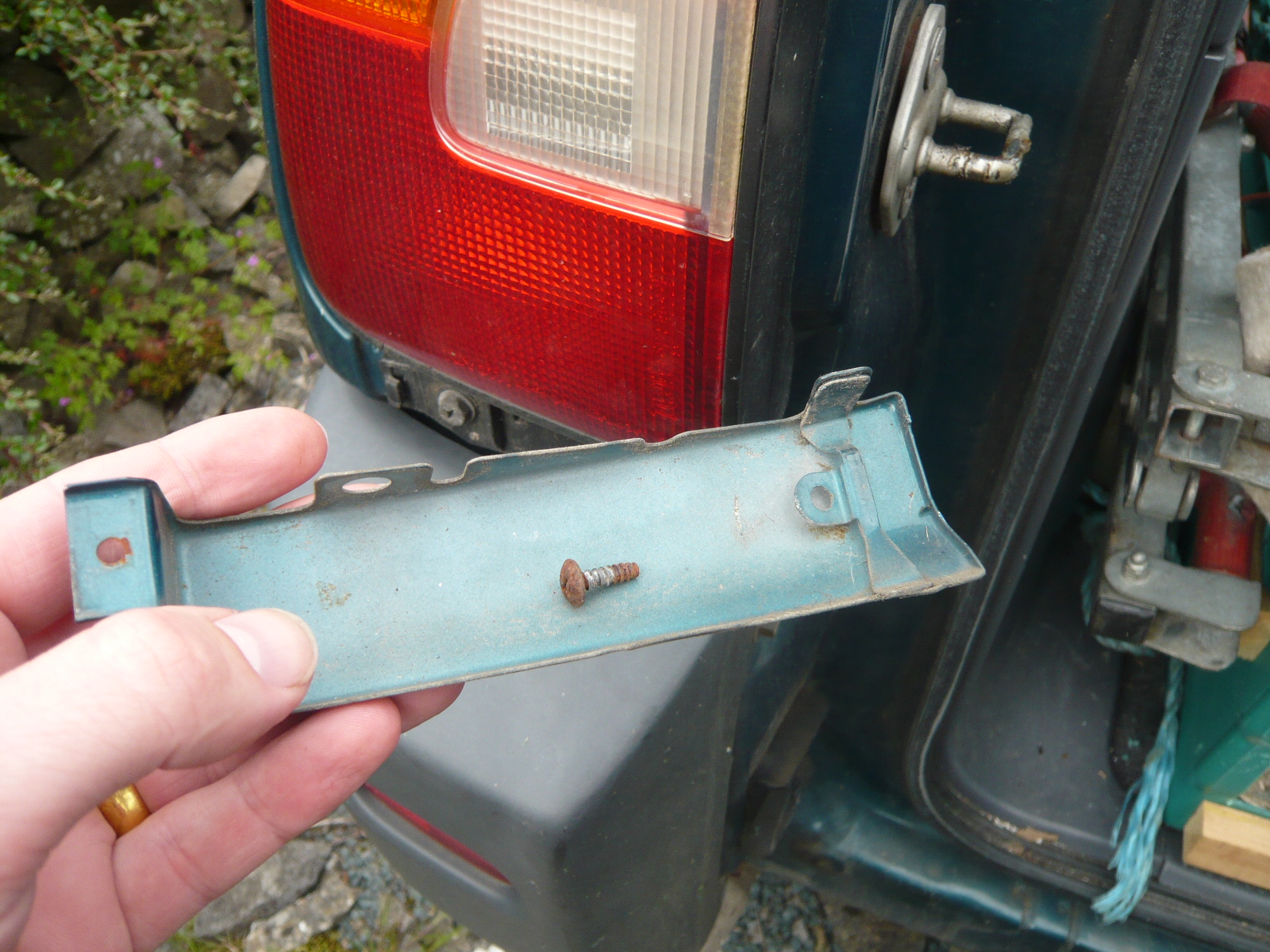

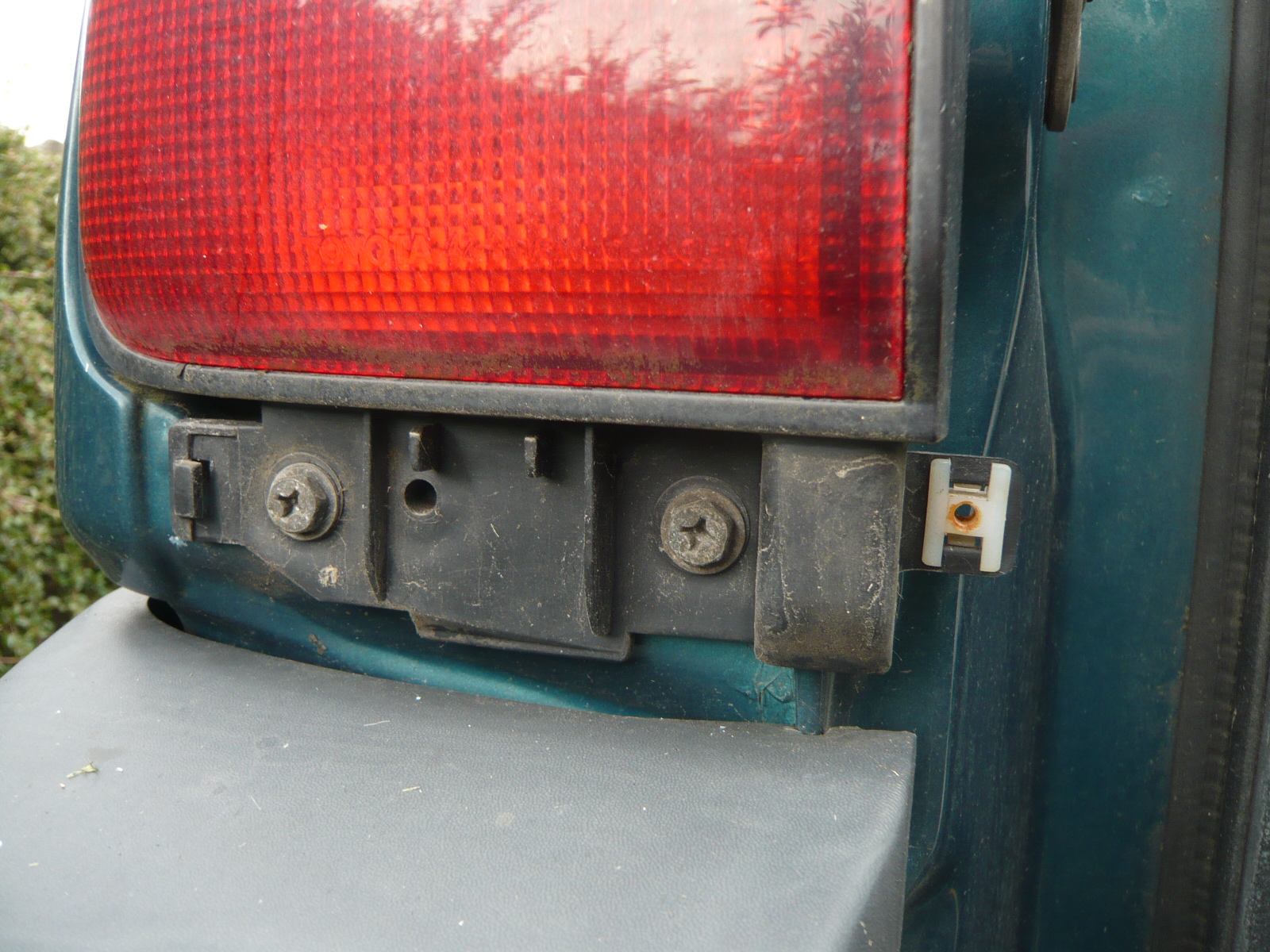

KruJoe Posted June 3, 2016 Posted June 3, 2016 Back light clusters are a doodle to pop out Ian.From memory...Open the back door, there's one screw just below each cluster, that releases a little body-coloured trim strip, which then reveals two(?) screws for the light unit. (Off outside to check now...)
