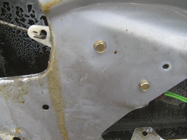

strangeangel Posted March 23, 2019 Author Posted March 23, 2019 Looks like someone's been here before me! The window regular/motor assembly was a boring like for like swap so I didn't bother with pictures. The window positively whizzes up and down now. The central locking solenoid, however... Arse. The wiring connectors were the same, though, so time to get bodging. The hook was bent through 90 degrees courtesy of two pairs of mole grips, and an extra hole drilled in the door to suit the new solenoid. Sorted! djimbob and Dave_Q 2
