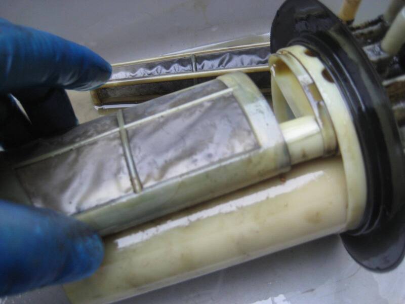

strangeangel Posted January 22, 2017 Author Share Posted January 22, 2017 Now the top of the reservoir is off, the filters can come out. Carefully pop that little clip off and rotate the round filter to allow it to come out: Link to comment Share on other sites More sharing options...
strangeangel Posted January 22, 2017 Author Share Posted January 22, 2017 Bit grimy... Link to comment Share on other sites More sharing options...
strangeangel Posted January 22, 2017 Author Share Posted January 22, 2017 This one didn't feel like it wanted to come off, so I proceeded very carefully, gently waggling it until it moved: Link to comment Share on other sites More sharing options...

strangeangel Posted January 22, 2017 Author Share Posted January 22, 2017 They are all outside soaking in fuel while I have my lunch... Link to comment Share on other sites More sharing options...
strangeangel Posted January 22, 2017 Author Share Posted January 22, 2017 This is better: Link to comment Share on other sites More sharing options...
strangeangel Posted January 22, 2017 Author Share Posted January 22, 2017 Just for reference, here's the plastic disc that lives in the bottom of the reservoir. Link to comment Share on other sites More sharing options...

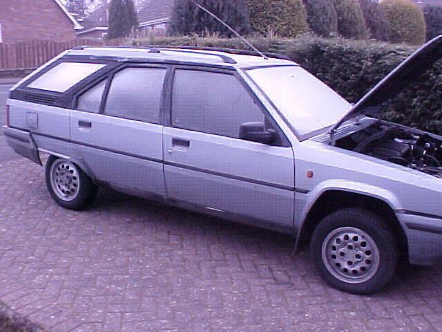

strangeangel Posted January 22, 2017 Author Share Posted January 22, 2017 Well, it's all back together. Here's what I have tried thus far: I primed the feed to the pump, height lever set to High, started engine and tightened pressure release screw,Tried FDB's suggestion of running for a few minutes, then opening and closing the pressure release screw.Tried re-priming the pump, height leve in Low, started engine and tightened PR screw.Have tried operating the (now extremely heavy!) steering at various times.Nearly crashed into MOTHER_SA's motorhome when I forgot I had no brakes... All to no avail, sadly. Link to comment Share on other sites More sharing options...

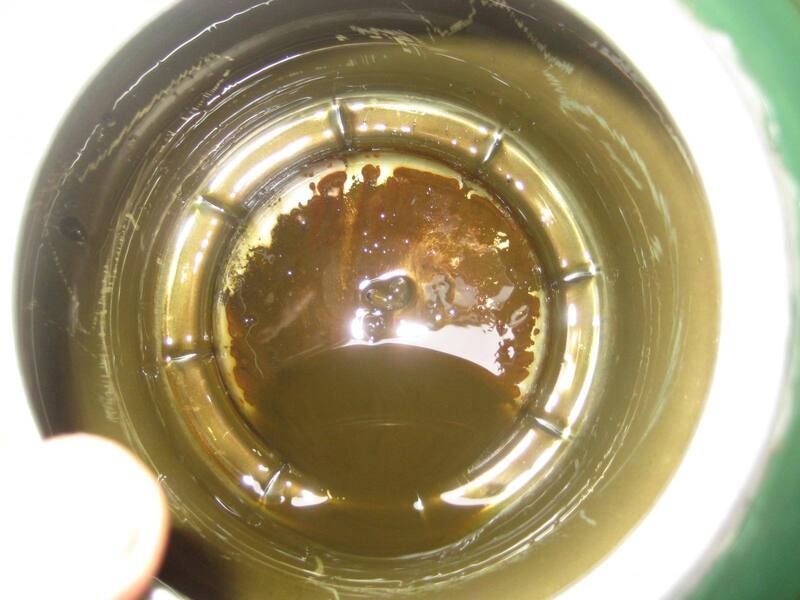

beko1987 Posted January 25, 2017 Share Posted January 25, 2017 Blimey, that lhm is - 43 on the 1 to 10 scale! I thought the dull green stuff in my xantia was bad, that's something else! I'd have hydraflushed the shit out of that! Top work! No idea what the bx method is to rise but I found with the xm high revs for a few minutes got her risen after a blood tranfusion, and the xantia will get the same if it goes stubborn on me! strangeangel 1 Link to comment Share on other sites More sharing options...
strangeangel Posted January 25, 2017 Author Share Posted January 25, 2017 Apologies for the late response, but how long are you leaving it idling after closing the pressure release screw? From what I've read it can take upwards of 10-15 mins for the system to pressurise. Alternatively I found constantly opening and shutting the screw until the rear suspension began to rise worked the last time I had to depressurise the system. I was following FDB's instructions from earlier in the thread, but I will certainly try leaving it for longer on Friday when I next attempt to get the old thing to rise up again; failing that your tip on repeatedly opening/closing the screw. Given the rankness of the outgoing LHM, should I repeat this process do you all think?? Link to comment Share on other sites More sharing options...
dollywobbler Posted January 25, 2017 Share Posted January 25, 2017 See how she goes. If all is well, I'd leave it. If the steering gets notchy again, then going the Hydraflush route is probably a good idea. After 1000 miles or so, have a gander at the filters and see if they look as grim again. strangeangel and beko1987 2 Link to comment Share on other sites More sharing options...

strangeangel Posted January 27, 2017 Author Share Posted January 27, 2017 Fired it up, tightened the pressure release screw and waited. About 10 minutes later this happened: Brakes are also back, but no power steering so far. Cleon-Fonte, RobT, Dick Longbridge and 3 others 6 Link to comment Share on other sites More sharing options...

strangeangel Posted January 27, 2017 Author Share Posted January 27, 2017 Job done then, PAS is for softies It's sorted now, happily. I went in for a brew, had a think and decided (for no good reason) to try starting it up and moving the steering lock to lock. Got in the car, fired it up, grabbed the wheel... and the PAS was already working! EDIT: just seen your post DW, looks like I was thinking along the right lines! The level is still OK, and when I go back out to put the pipework back on I shall do a few cycles of the height lever. Link to comment Share on other sites More sharing options...
beko1987 Posted January 27, 2017 Share Posted January 27, 2017 Forcing the steering round must have purged any old crap out of the system! Do lots of citrobatics now, bleed the brakes, then lots more citrobatics and check the filters! strangeangel 1 Link to comment Share on other sites More sharing options...
