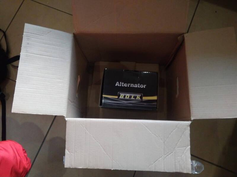

strangeangel Posted October 25, 2017 Author Share Posted October 25, 2017 The new alternator arrived, packed like this and lying at the bottom of the box: And, lo, it was knackered. I asked for another one to be sent, but could it please be packed properly this time? GENIUS. Miraculously, this one survived at the hands of Smashy McSmashface The Courier and was duly fitted. So charging has been restored, but I still had to play the will-it-won't-it-rise game for 10 minutes or so. I did disconnect one of the big LHM pipes from the reservoir because it was in the way, but I was careful not to lose any. Then again, maybe it wasn't best pleased about being left on axle stands for a week? Who knows. It's working again, which is the main thing! dollywobbler, UltraWomble, djimbob and 5 others 8 Link to comment Share on other sites More sharing options...

Eddie Honda Posted October 26, 2017 Share Posted October 26, 2017 this one survived at the hands of Smashy McSmashface The Courier Bolk + Mister Auto = YODEL? Thank fuck they use An Post here. Lacquer Peel and strangeangel 2 Link to comment Share on other sites More sharing options...
strangeangel Posted October 26, 2017 Author Share Posted October 26, 2017 Bolk + Mister Auto = YODEL? Thank fuck they use An Post here. Dunno if they use Yodel as well, but these were delivered by Parcel Force. Eddie Honda 1 Link to comment Share on other sites More sharing options...
