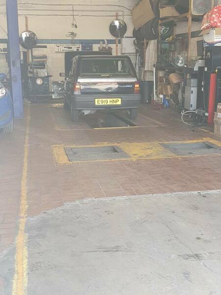

Well today was MOT day for the Panda.  After the hectic but fun combined collection and MOT caper last year I was hoping for a more sedate MOT day. today. sadly it wasn't to be

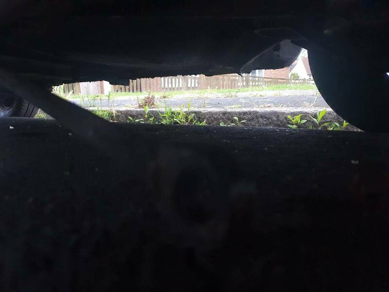

Plan was to take it to work this morning then MOT on the way home but after a few miles on the A2 there was an acrid burning smell and whisps of smoke from under the bonnet when I pulled up. I didn't fancy risking it through Dartford crossing so came home. It didn't smell like oil or coolant, it smelt electrical but smoke was from front of the engine. I then remembered that when I did the rocker cover gasket I used an engine degreaser to get rid of the thick build up of oil from years of leaking. Figuring it could be some of that I didn't wash off properly I got the bucket and scrubbing brush out and all seemed well so I went to the office late morning.
After work I headed to the MOT garage M25, A13 . Car driving ok but seems to be a little hesitant still on the power. something for the list to investigate.  Then it went a bit wrong

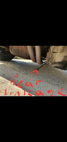

feck.  few hundred metres to the MOT station and the gear linkage fell apart.
so instead of a triumphant day and another years motoring the journey ended in ignominy :(

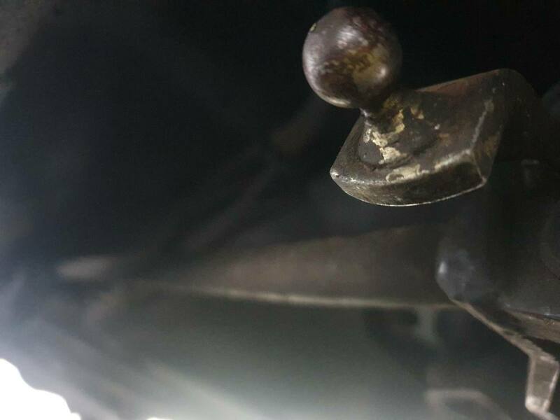

Hmm it looks different. The rod from the gear leaver has a round eyelet with a single bush inside (unless something dropped off).  The other end has a domed pin.  It looks like the bush fits in the eye and then push fits onto the domed pin
EDIT. As I see it now, the part with the domed pin is missing from the diagram on eBay
Quite a spectacular failure by the look of it. Usually that little red bush just gradually wears and develops play until the ball starts popping out, looks like yours has broken in half! Right pain to fit, it's a hardish plastic piece with a lip both sides (one side is missing in that pic) you have to get through the hole in that rod without crushing it.
I missed this the first read through. Yes its a spectacular failure, I got no indication it was getting sloppy until two changes before it failed.  New one felt more like rubber than plastic but looks hard as you say. Might have to try Edd China's jubilee clip method with some hot water and maybe red rubber Grease

Mixed day today. finally got a chance to crack on with the replacement bushes.  I bought a set from eBay but it seems like mine has slightly different variations of bushes.  However there was enough to refresh most of the bits that need doing, just one bush short
I also fitted the shifter mechanism @spartacusleft with the car
new bushes seemed to go in ok, warmed them up in hot water and some red rubber grease and they popped in with the vice without the Edd China jubilee clip method.   Popped them back on the balls with mole grips.  They didn't seem that tight to me so I hope I didn't damage them during fitting (or maybe too much grease?l. anyway the shift feels a lot tighter now so will see if they pop off again
