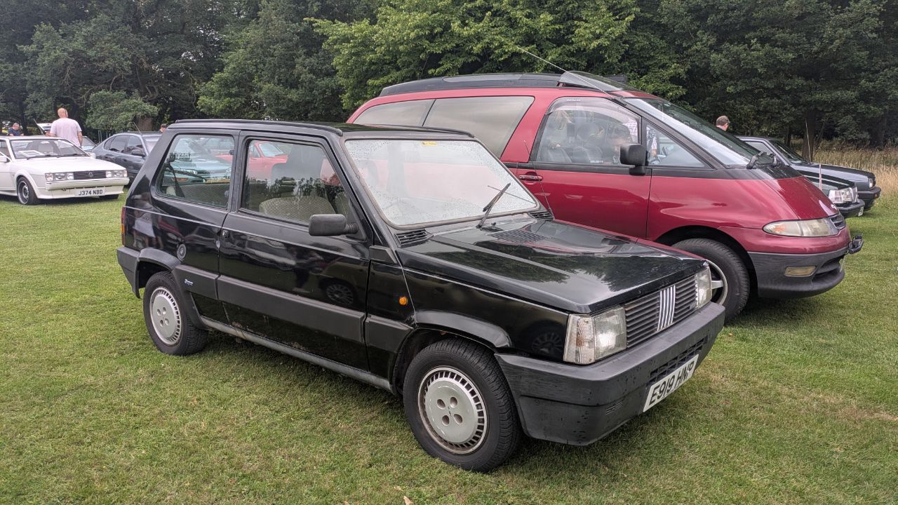

Spruced the Panda up a bit with a quick wash and some bumper black and took it to a local car meet I run.
great seeing it looking shiny again and out and about

It was nice to take it out today to FotU. I had a few people ask me questions too which was nice
@wesacosa good to catch up on it!
How is it now Tom? You on top of it?
