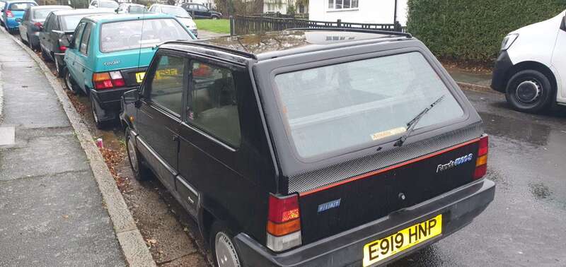

I'd booked the MOT for 8.00 this morning at my usual place. I'd took the day off yesterday to do some final fettling which upon reflection wasn't a great idea.  I'd decided I thought the water pump was maybe starting to seize up as it sounded a bit noisy so I thought I'd change it.  Luckily @rob88htold me it was a silly idea on Thursday so I thought better of it.
I did however look to check the transmission oil level to make sure it was ok after changing the CV boots, which on these cars seal the gearbox oil in) and as I opened the filller plug I was greeted with this
Hmm doesn't look good
I dropped the whole lot out and it was a mix of normal looking oil for the most part with some more spurts of this.  I couldn't decide if it was emulsified or just aerated but I binned it off anyway.  Spent 3 hours yesterday driving around looking for some suitable gearbox oil but seems classic box friendly stuff isn't something anyone carries in stock anymore . General consensus on the forums is that EP GL4 will probably blow your gearbox in to a million peices and GL5 definitely will.  Some even swear by just sticking 20/50 engine oil in but that seemed a step to far for me. I'd discussed this previously with @Grumblespeed and he suggested engine oil wasn't his favoured option so for now I've just stuck GL4 in but might just use as a flush and put some GL3 or classic friendly GL4 non EP in at some point
Next worry was the weather. My MOT garage is on the north side of the Thames and I'm on the south. Its only 7 miles if Woolwich ferry is working but a bit more through Blackwall and a few more again via Dartford . I'd heard a storm was coming but hadn't realised how bad until last night. Woolwich ferry and Dartford bridge closed. Shit
Had the worst night sleep last night and was a nervous wreck this morning.A mix of my chronic loss of confidence in my car  work and worry I'd be stuck unable to get home. I was close to cancelling but decided to take car for a spin around the block and see how I felt. It felt ok so fuck it, I just carried on driving to the MOT garage . The wind and rain had eased a bit which helped, although it was much worse once north of the river. Car ran pretty well although last 2 miles it felt a bit hesitant (although by now the wind was howling so could just have been a strong head wind) and there was a nasty smell which I think might have been a rear brake sticking on which was fixed* with a couple of blows from a hammer
Upshot is the car passed.  I think the rear sills are going to need attention before the next one (even if its just wire brush and Vactan rather than sparkly stick) but passed muster this time
My only sensible route home through Blackwall tunnel was thankfully clear but the wind and rain were getting worse so no time for a celebratory picture I just pointed it south and stuck my foot down
The Italian tune up seemed to have sorted some of the running issues but I think the timing and mixture might need a final tweak to get optimum performance
But its legal again and I'm thrilled. Its also off Mrs Ws place on the drive where it went for a couple of weeks top,  in June 😬, so she's now talking to me again 🤣
Its celebrating by joining the working* fleet and annoying my neighbours

Hopefully this has helped get a bit of my confidence back. I drove a £150 Favorit to Monaco and back in 2019 and now im a nervous wreck going for an MOT 🤣. But thats for another day........
