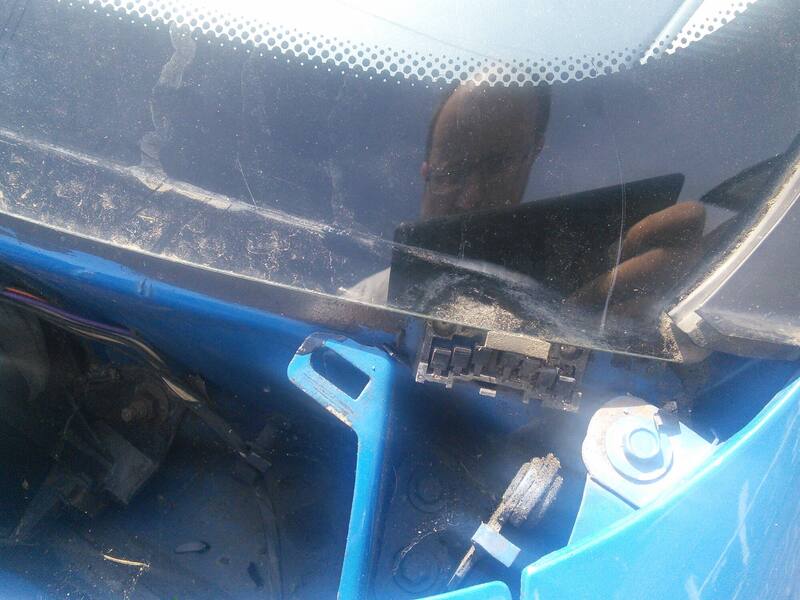

Taking this apart again ahead of the screen replacement tomorrow. This is a shitter. Really is.  ALL four of the remaining plastic/metal retaining screws have snapped the plastic on the cowling - these screws should have come out with the cowling when you remove it. There were originally 5, but one has already broken. I guess it might be possible to add a plastic  washer to widen the screw retaining point so it actually still grabs on to the cowling/grille.
IMG_20200617_101720.thumb.jpg.3d1fd118b42590bc0c12960fb28bf94f.jpgIMG_20200617_101710.thumb.jpg.96ba44e09a3b887e0cd6aca0b556ca2a.jpg
Though, below this to me is conclusive evidence that the screen was not installed correctly last time - remember the TSB above
Quote
When installing a new windscreen, it is possible for the front face of the locator blocks (also known as `piano spacers') to create a high pressure point which may result in the windscreen cracking, particularly when installing the cowl top outer grille assemblies.
Well look at this, it has cracked EXACTLY where the piano spacers/blocks are. I'm pissed off.
IMG_20200617_102149.thumb.jpg.c7466cbec6733869032e3b8757d1b368.jpgIMG_20200617_102158.thumb.jpg.dda3ad93074b6d5c7b28d9cffade1491.jpg
Those locators should have been removed. You can see I'm fed up in my reflection, lol.
6 of 1 and half a dozen of another - I am at fault, I over tightened the screws for sure - but, if they had installed the screen as per Ford advice - the problem would not have occurred.
Here are examples of where the cowling has snapped.
