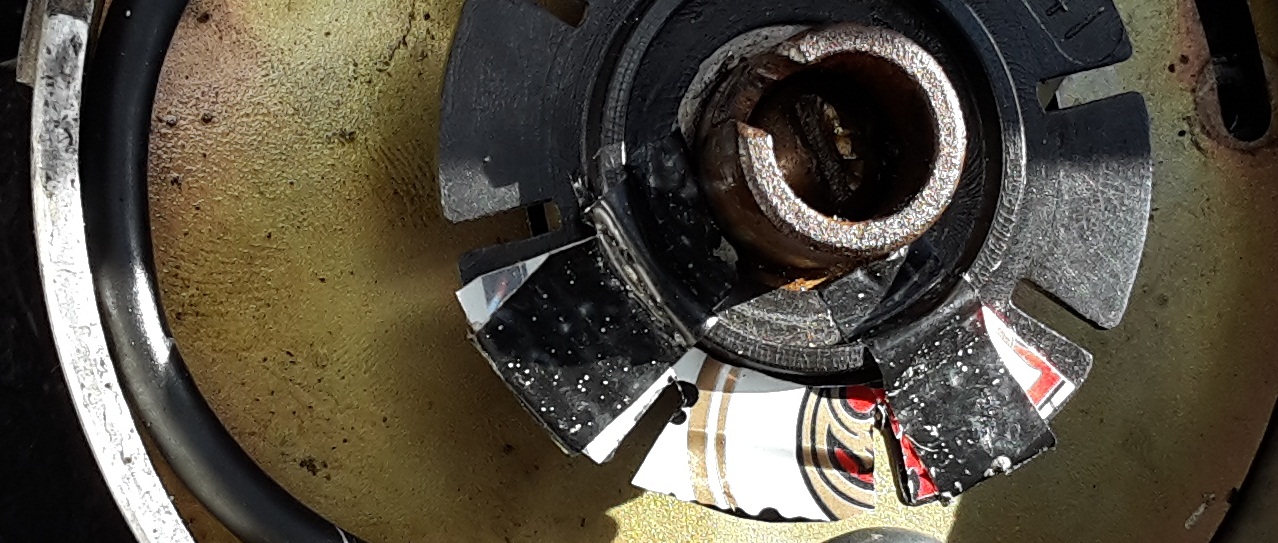

broke the ignition chopper on my Stag in a field in France, Le Mans Beausejour to be specific.
Fellow camper Matt fixed it with a pair of scissors and a discarded wife beater tin.
Cost = zero
Did it get me home? = you bet
