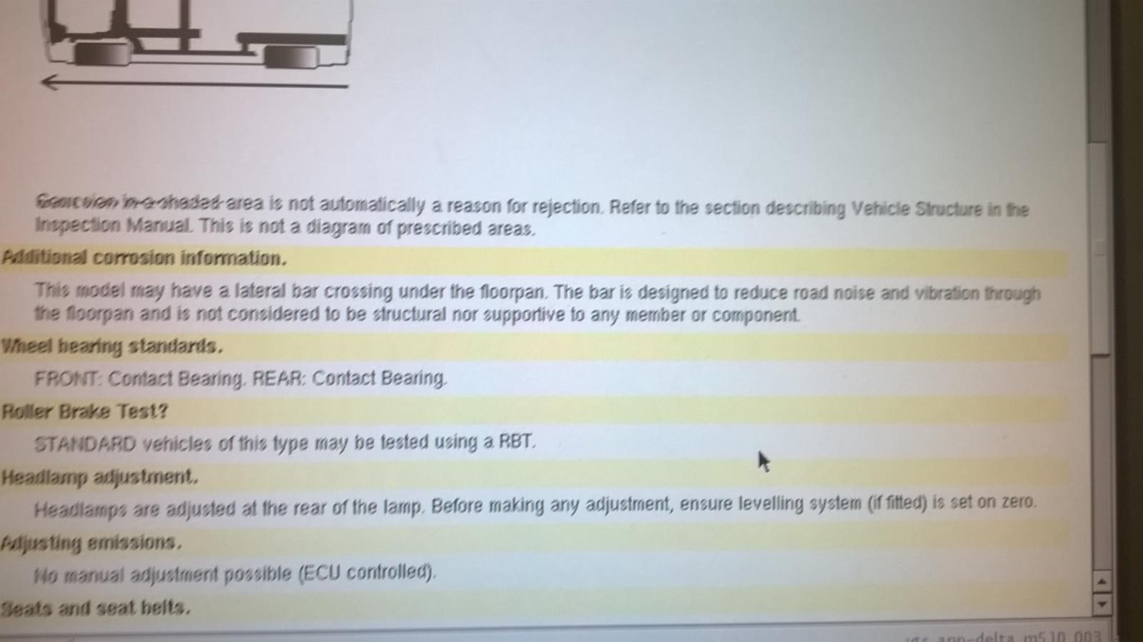

Our 1.6 Coupe gave us a years trouble free service, 45MPG, working air con ,and really quite a decent drive for 250 notes.. Now passed on to my daughter for whom it is cheaper to insure than a 1.2 8v Punto. Rear cross beam thingy isn't an MOT failure. Timing belts are a bit of a pain to change and the value of the cars means most folk wont bother,and they do snap. When they do it's diy-able and less than £150 in parts.
I always thought it was a fail as it's corrosion within 30cm of the suspension mounts . Seen plenty with it missing but I've always changed them . Must be there for a reason
I think its in the vsi ,but remember reading it , will check at work in a bit.
