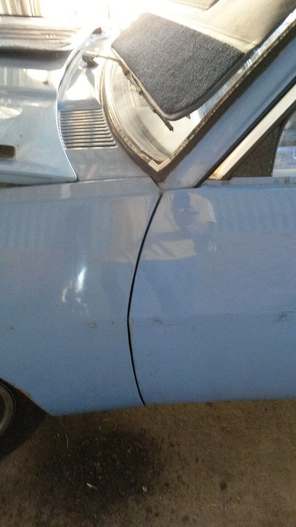

After the wing came off, it was possible to re fit it in a better position so that the panel gaps were better.
Quite pleased about this, as I thought the wing was a pattern part due to the bad panel gaps. It is actually a genuine wing that was just fitted in the wrong position!

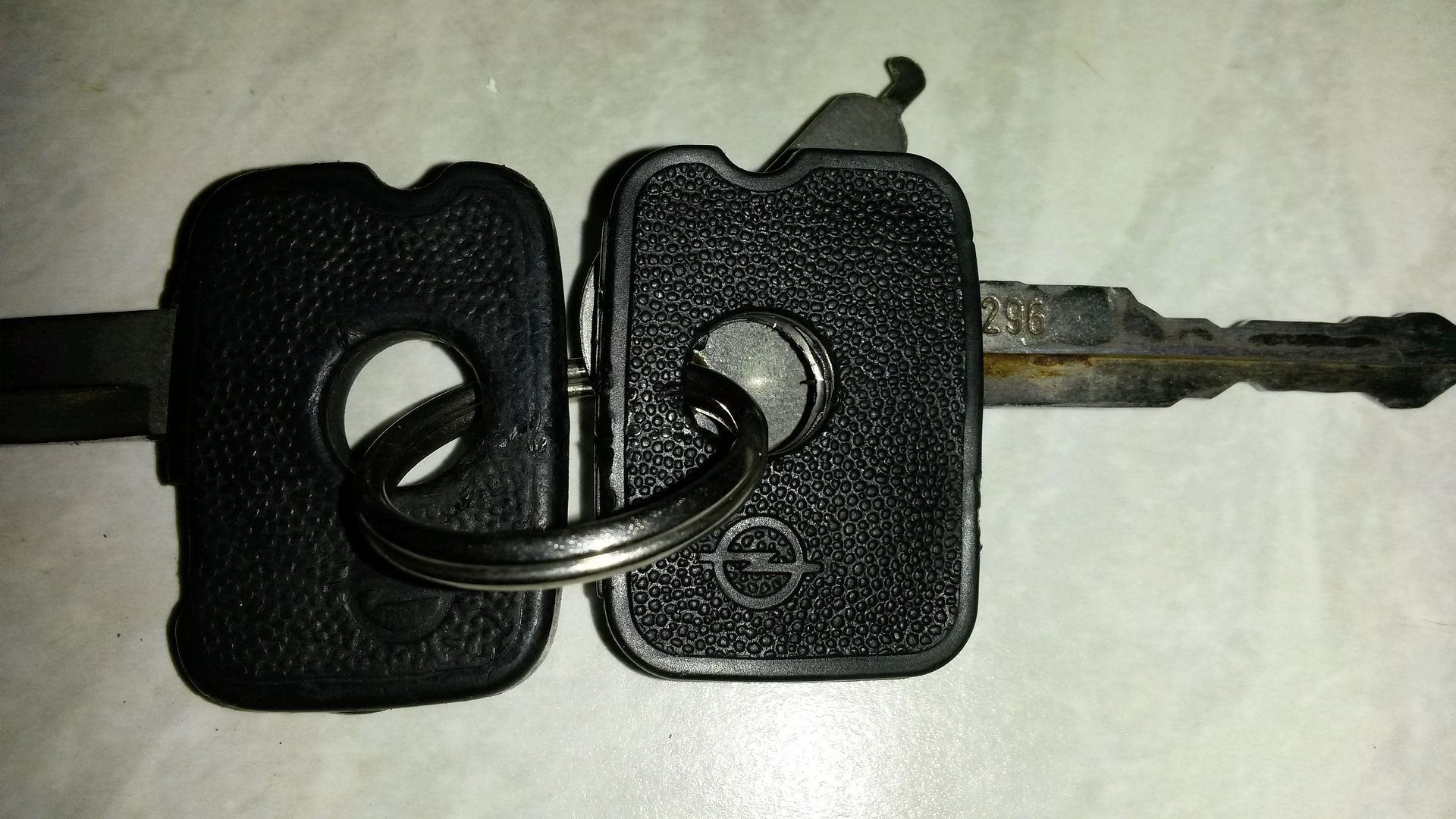

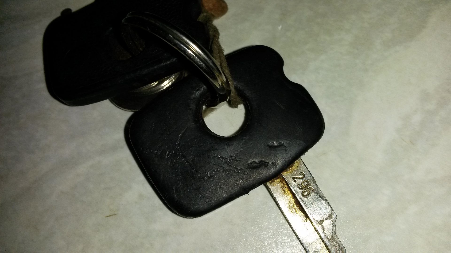

My key refurb kit arrived from Germany recently - two replacement key grips - bought as my main key was getting a bit worn and sloppy.
Before
After

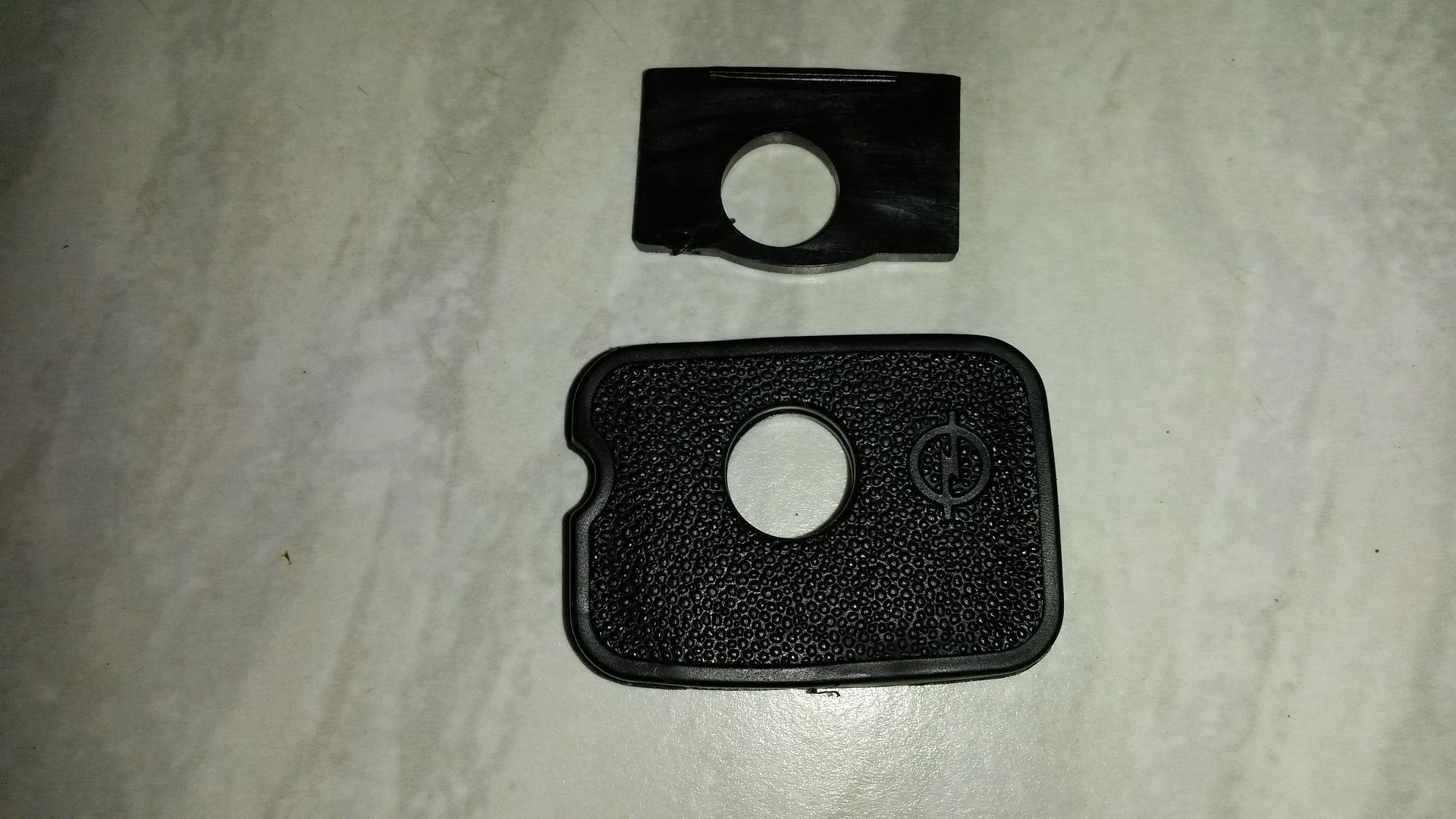

Comes as two pieces that slot together using the original key blade.

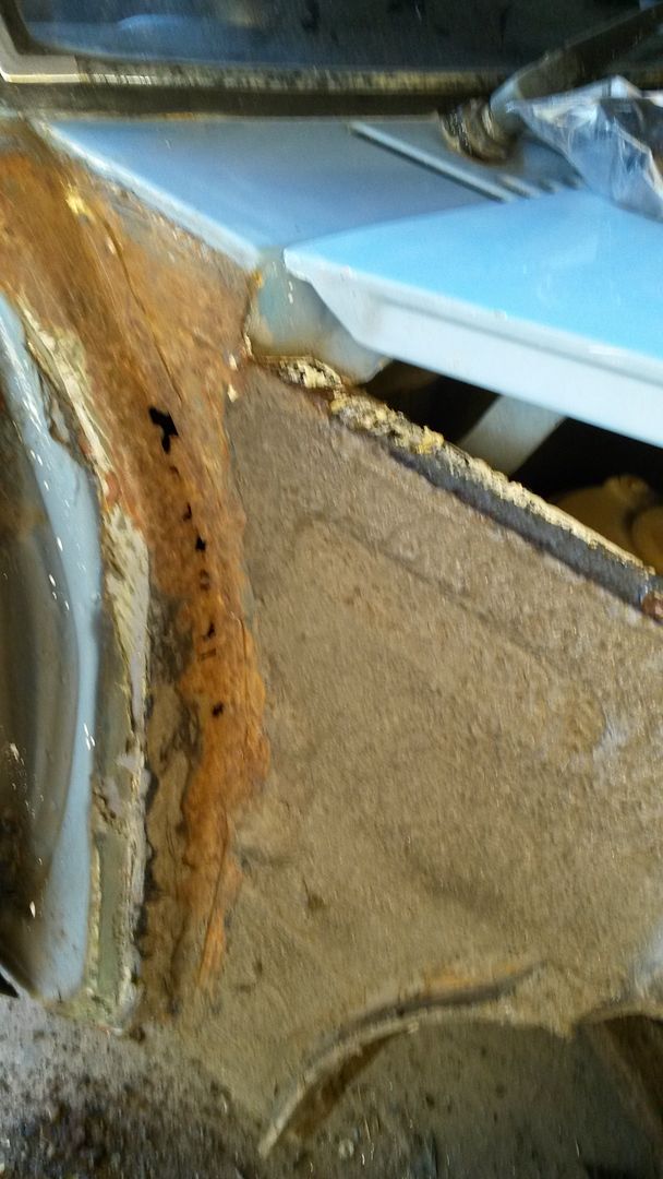

Not all good news today, after removing the driver's side wing, another area needing attention was revealed.
It's a pretty easy fix to do though, so I'm not worried about it!
There's practically nothing to do on this thing, it's unrealistically sound!

After the wing came off, it was possible to re fit it in a better position so that the panel gaps were better.20150929_174221_zpslenyzl5f.jpg
Comes as two pieces that slot together using the original key blade.20150929_185713_zpslgv7tu8j.jpg
Not all good news today, after removing the driver's side wing, another area needing attention was revealed.20150929_174257_zpsltlwtn7c.jpg
Not too bad really.Did somebody mention FE victor? Pah! Until you have had a senator/royale of that era you don't know what rot is.
