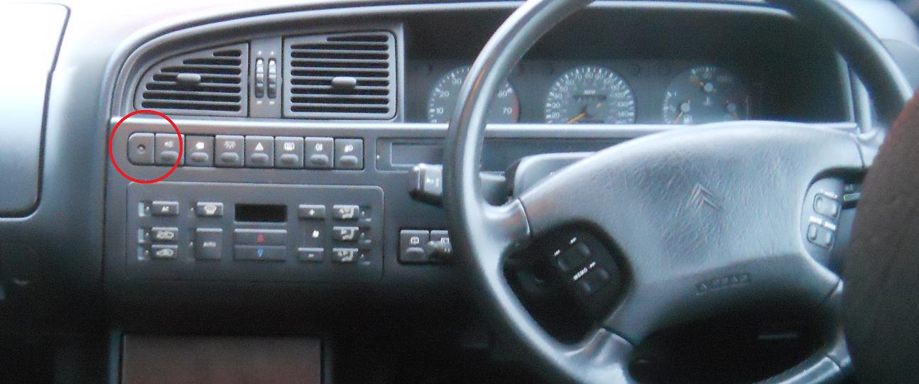

XM - not the big red light of doom but what is it?
There is a little red light on the left hand end of the row of switches with the hazard lights etc.
I only noticed it because it is now on whereas before it wasn't. My diagnosis of this has got as far as the fact that I let my wife use the car without telling her not to touch anything that looks like a switch.
I checked my (now loose leaf) owners manual and all the pictures of that part of the dash just show a blank panel.

It's the light that illuminates to show the light on the left hand end of the row of switches with the hazards lights etc is working.
Does it have a symbol on it?
Alarm tell tale blinker type thing?
Does the car run OK?   If yes, masking tape?
Alarm.
Turn on ignition & quickly press the button next to it. Maybe.

I've had Xantias, it could be someone has activated the internal sensors for the alarm which could be cancelled either by pushing a button or running through a daft sequence of events with the key and other buttons and so on.
Check with the FCF - someone on there will tell you more than you ever wished to know about it, but you'll learn how to get rid of it without pulling the thing out and causing potential elecrtonic PSA paroxysms.
I hate all alarms, especially when they're hard-wired into ECUs as on some older Audis (and perhaps many later ones too).
It is the alarm tell-tale. The reset procedure needs learning. I've had to do it a couple of times on mine, but can't actually remember what the process is now.

OK, the ignition on and press the button next to the light didn't change anything so I disconnected and reconnected the battery and then locked and unlocked the doors (with the key because the plipper isn't working this week) and that seems to have sorted things out. It also gave me the chance to set the clock to BST and reinsert the radio code. Hopefully that completes my maintenance schedule for this year.  :-D
  • 1 year later...
Thread resurrection because it's done it again. Only this time the disconnect battery and lock/unlock routine hasn't worked and whenever I open a door the headlamps flash. Could this be caused by low battery (I have just driven 20 odd miles so it should have charged up a bit) or the fact that a helpful friend tried to put the jump leads on the wrong way around?

The zx did this when the alarm was going off (but the sounder had been disconnected so no siren)

Do these have a key switch on the slam panel hidden under a blanking plate for disabling the alarm like on the ZX? There's one on my Volcane but i'm scared of actually switching it in case it's actually le sweetch disablameunt du voiture permeunantaimant. Because Citroen.
