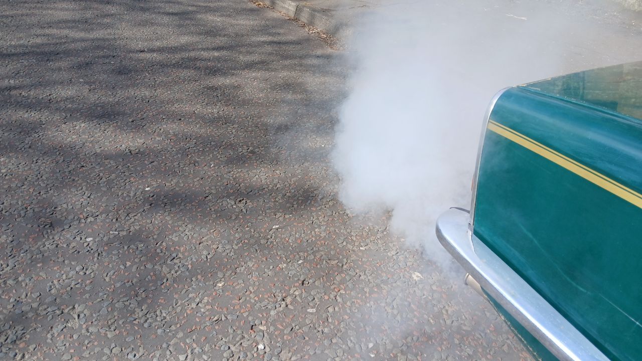

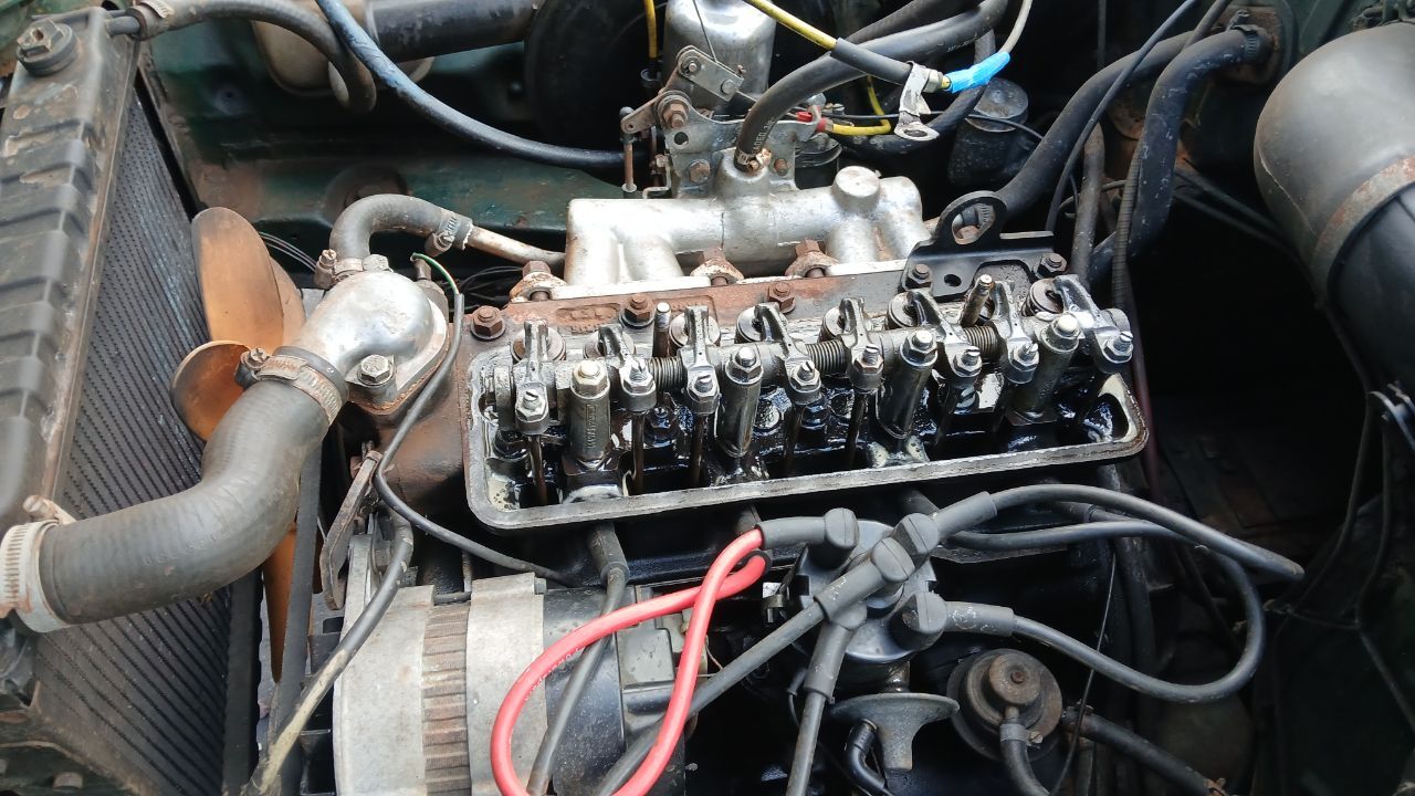

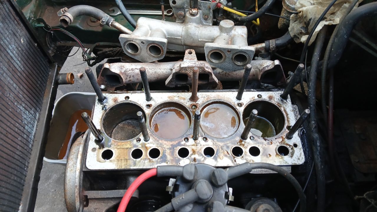

It started today but briefly only ran on two cylinders before clearing. Odd.
20 miles later it became apparent that this was probably due to two cylinders being full of coolant...
Ah that doesn't look good.  Big end bearing wear is more of a regular tapping/ knocking noise when the engine is under load or when you snap the throttle open hard when stationary.

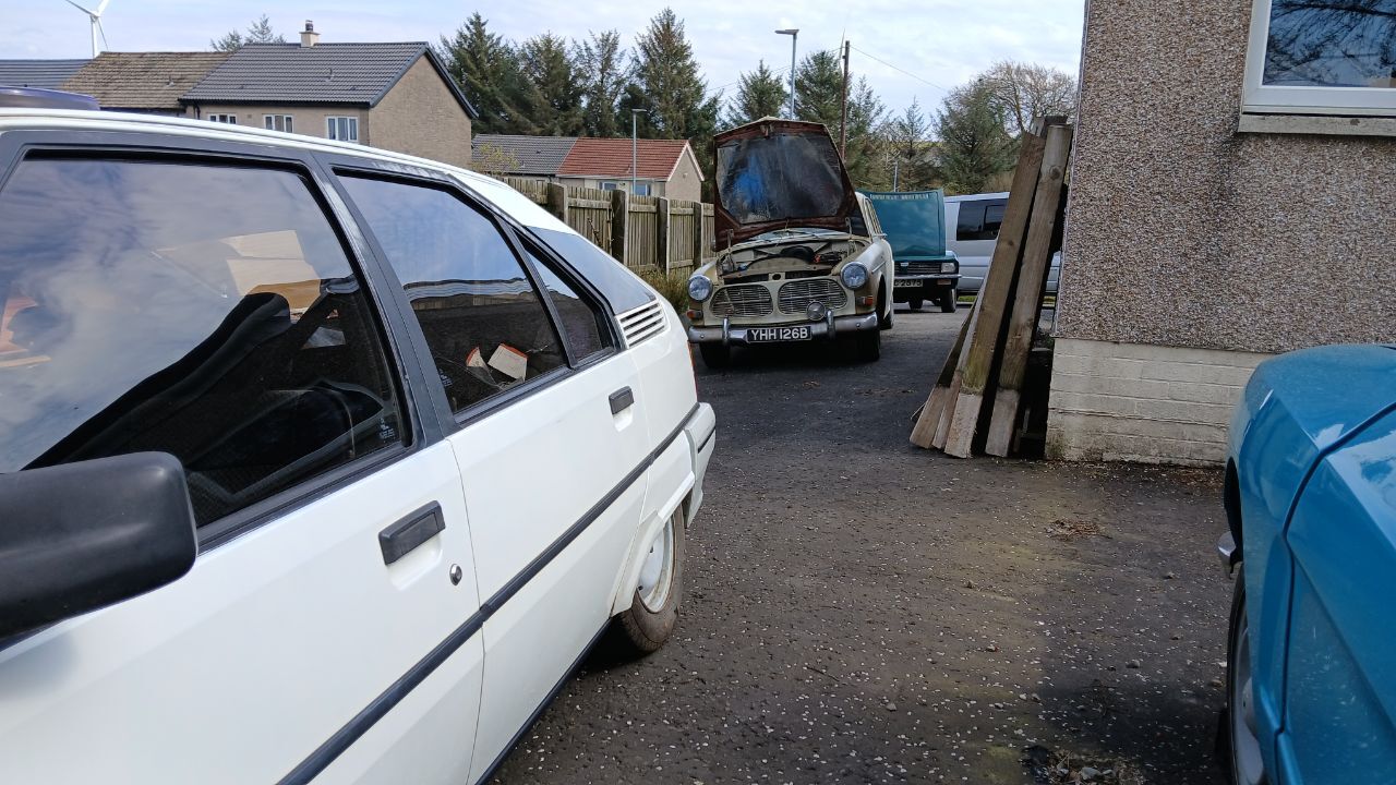

Limped to @juular and @MrsJuular's place.

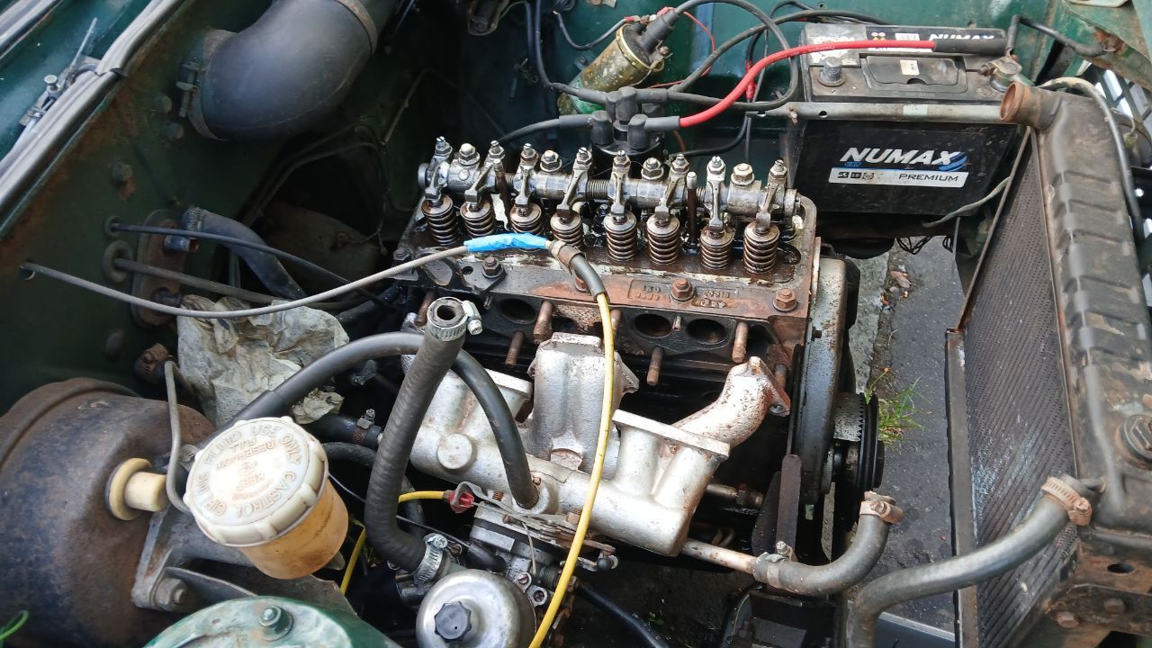

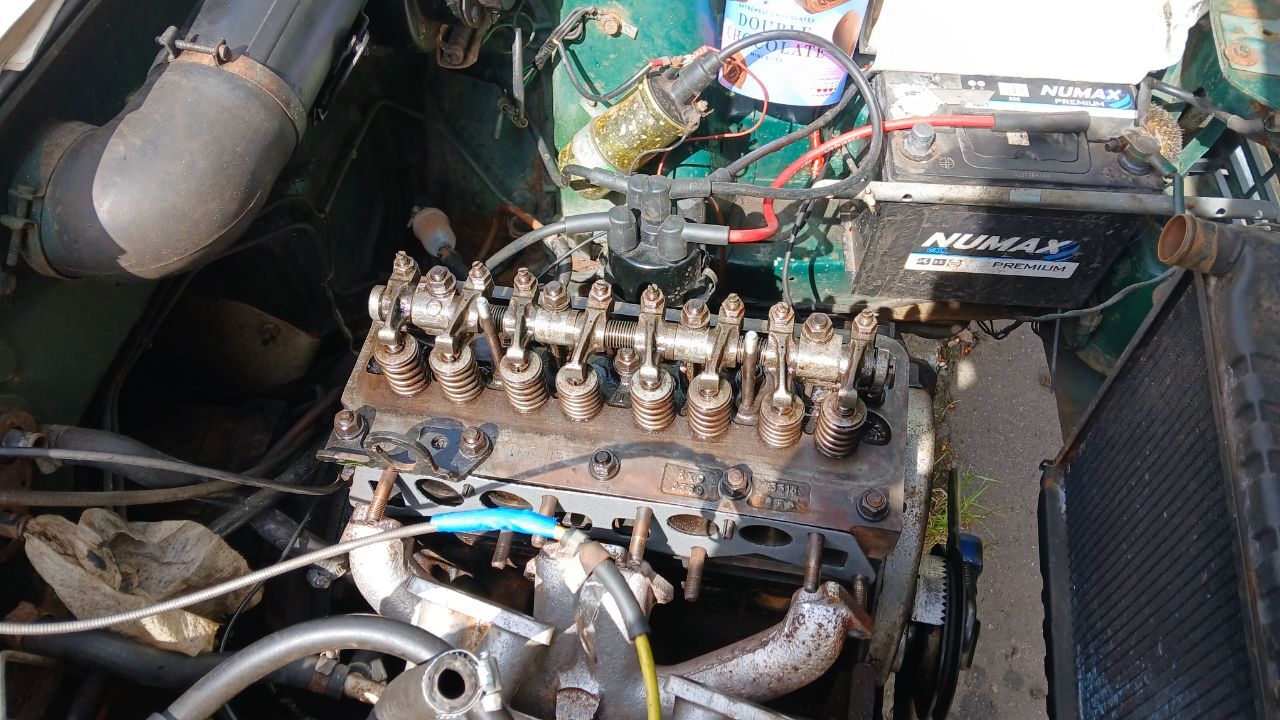

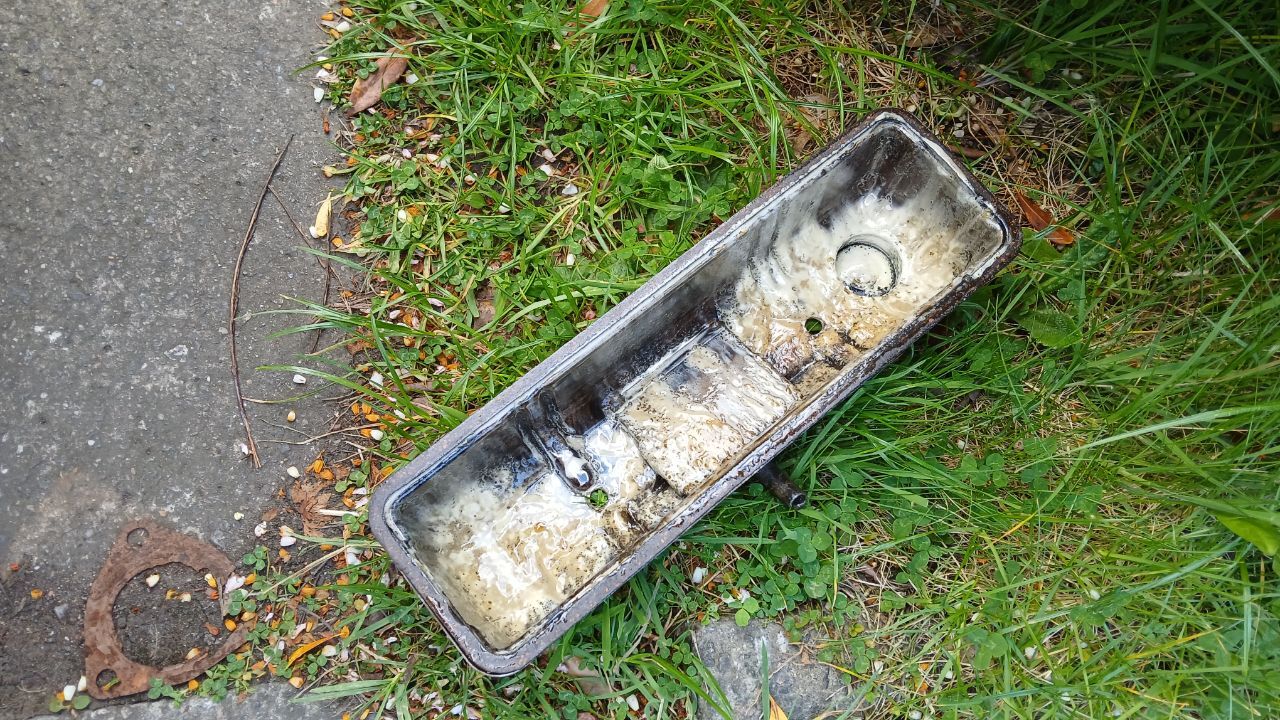

Looked at the head bolts. All tight. Compression in the coolant, coolant in the combustion chambers, so signs of oil/coolant mixing.
Coolant topped up. Removed thermostat to reduce system presdure. Made it home in a couple of hops with a stop to cool down.

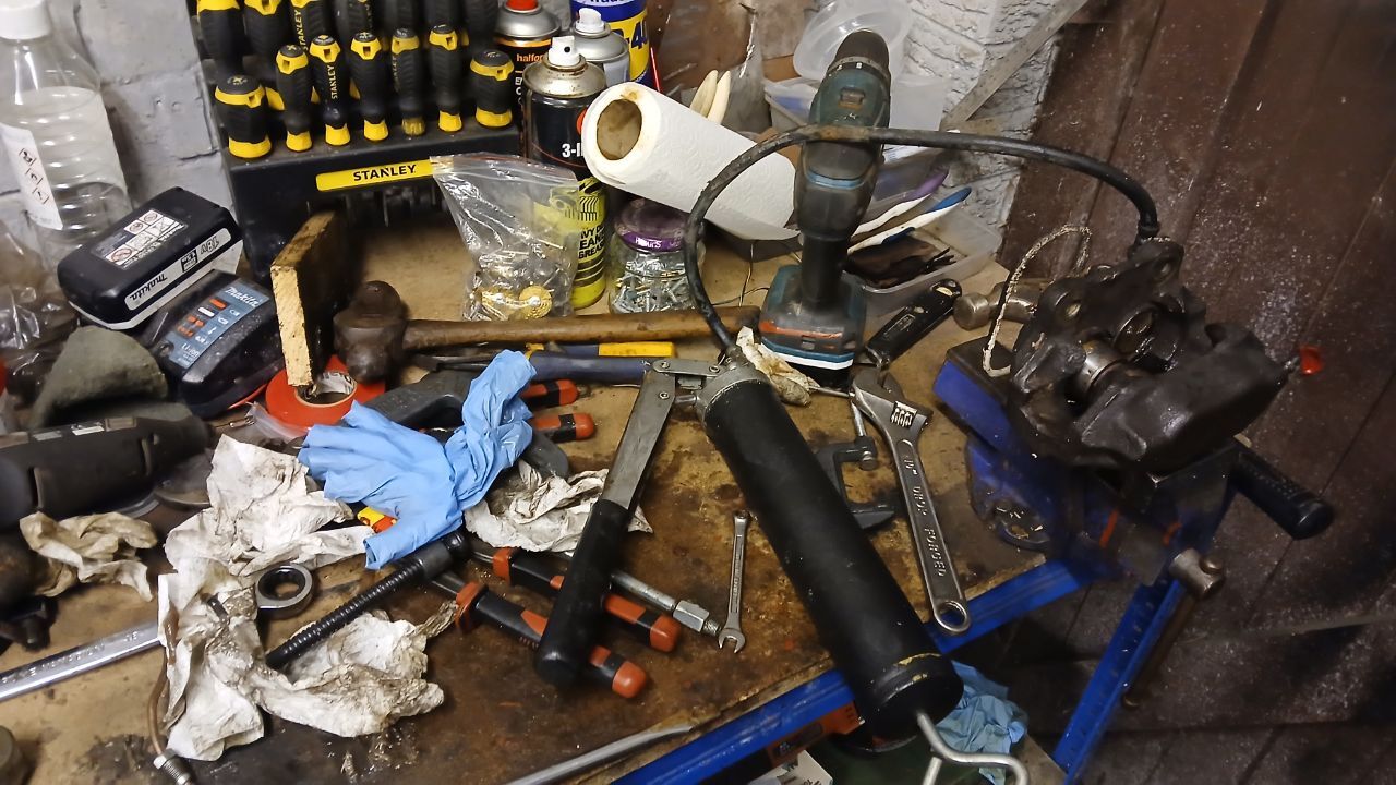

Meanwhile big thanks to @juularfor lending me a grease gun, I hate it.

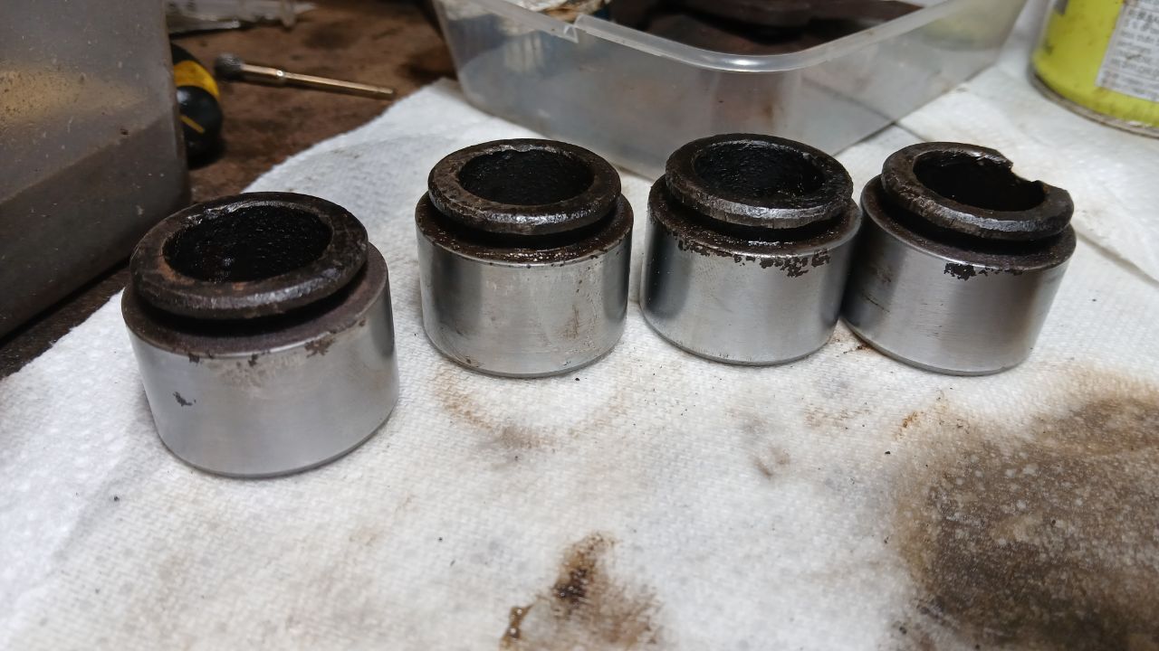

Three pistons liberated so far.
Most of a roll of kitchen roll and about 20 pairs of nitrile gloves used, everything I own and will ever own is now covered with grease...
Also, swung by @garbaldy's place and collected my latest purchase, a car roller.
Was good to have a chat and have a nose around the cars. Not often you see a Mk2 Escort, HB Viva, Pug 305 van and mk1 Mitsu Colt parked together!

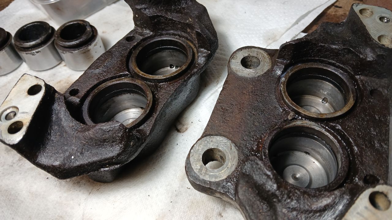

All pistons liberated from the 145's NSF caliper.

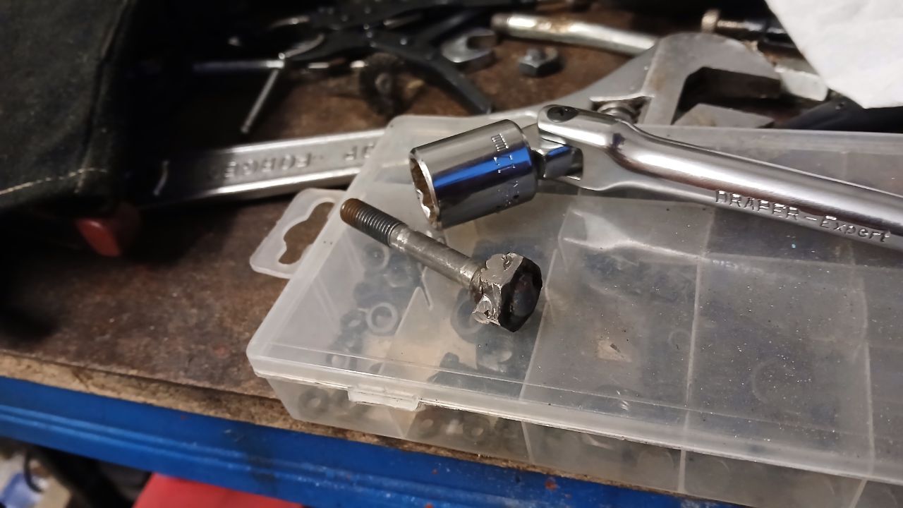

Needed to get into the pistons to clear them up, the manual insists you mustn't split the calipers, and the caliper agreed.
Fucking Germans and Torx fittings... The welder was deployed.
I don't think these calipers had many miles on them. The only corrosion is to the leading edge of the pistons. Likely caused by the dust boots being entirely absent...
Rebuild kits have been ordered.

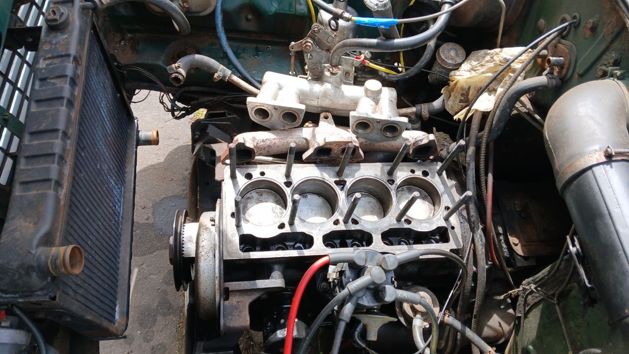

In Dolly news I started the head gasket replacement.
The forbidden mayo...
There is enough wiggle room you can pry the manifolds out of the way of the cylinder head without removing the carb/exhaust, etc.

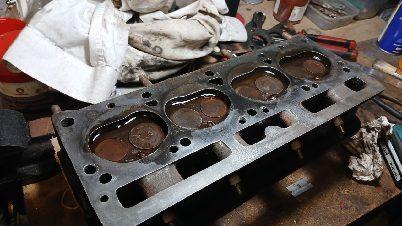

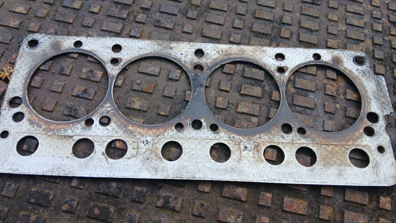

Ah, there's your problem.
Definitely the most buggered head gasket I've ever seen. 3 burst cylinders! Still ran...
If you know Triumph SC parts you'll know that's a cheapo gasket, at the time I built this engine Payen examples were out of stock everywhere. This is also the gasket that failed on my first attempt at FOTU and was "fixed" by retorquing the head nuts, so actually surprised it lasted so long.
Not pictured was the exhaust manifold gasket which had nearly burnt through between cylinders 2/3. I think this is the 3rd one I've blown...

I'm sure a nice, fresh, properly built one is a fine thing. All mine have been built from the cheapest core parts I could find, really everything should go away to be machined, but I'm waaaay too cheap...
If you read the forum threads of people who build these engines properly you see how much more effort and expense they go to. I just fling them together and hope for another year or few thousand miles between failures, and I do drive the car quite hard!
