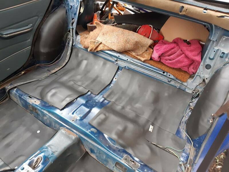

Then installed some closed cell foam pads to attempt to reduce road noise as much as possible.
175769130_744903396192274_5313428358966451356_n.thumb.jpg.c9bcc4ea20d4580c7dccc3319c4f01c6.jpg
176098799_316871949775112_4033541844053883137_n.thumb.jpg.ed607eeac636597a4633f37520fe7d47.jpg

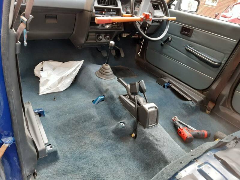

Then carpets and plastic trims back in place.
175918075_317741163021129_8714837601718205301_n.thumb.jpg.f81dff57dd9539458e56211518e19517.jpg

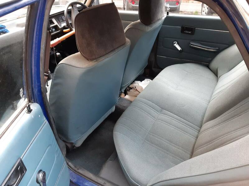

Seats back in.
176471617_3986803078043279_8989752972994520414_n.thumb.jpg.dc41d88403127215efbaf1cdffd6d59b.jpg
175886728_281261490311353_4470798517796955567_n.thumb.jpg.abb8dad22d0f19db62410005fa3a7c94.jpg

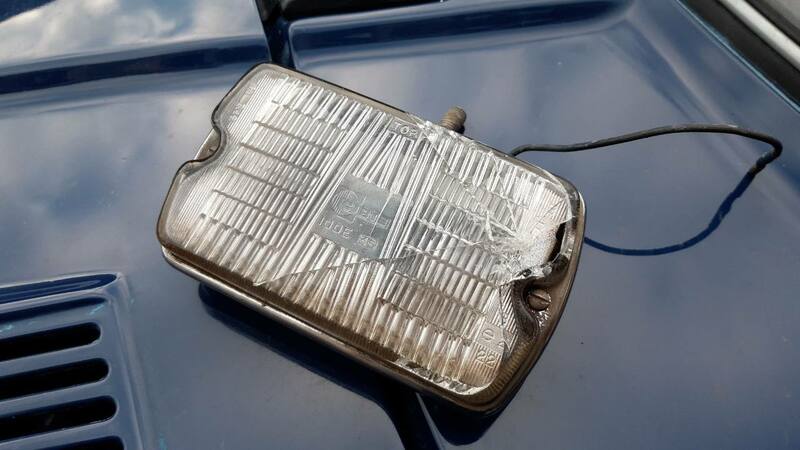

I celebrated the interior being back in by dropping a fog light when refitting.
175655369_207034017565083_1719850017267874678_n.thumb.jpg.2e6db49bbdff52bac2badf2f05ae103d.jpg
Those are £200 odd a pair.
  • captain_70s changed the title to Rusty Triumphs in Scotland - internal screaming - 20/04/21
Multiple possible, repair/replacement options have been sourced for the fogs. Watch this space.

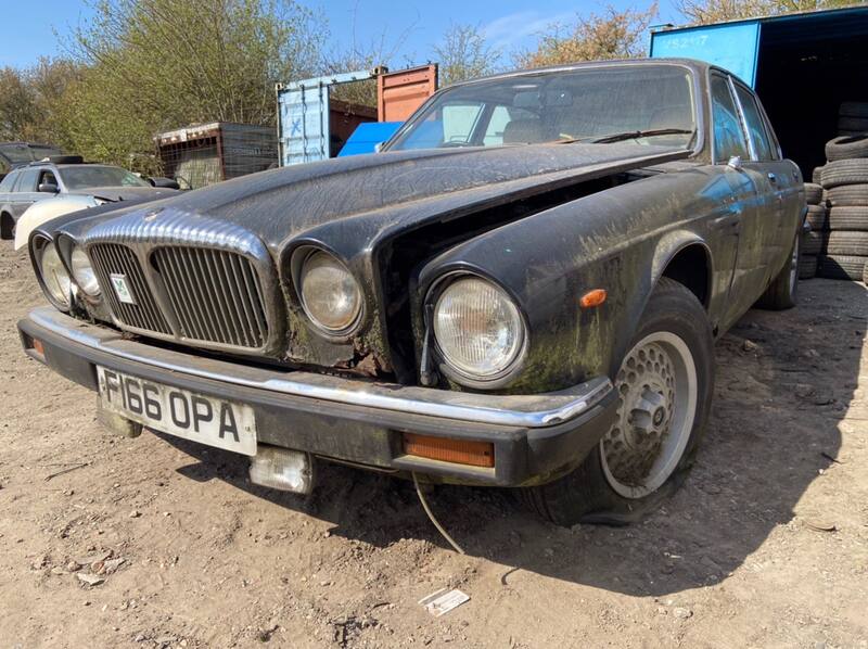

This Daimler has come into my local scrappers.1084BEA6-BFEC-44A9-B41F-24F601E57668.thumb.jpeg.88f20438f005e2612e3e261874a8660e.jpeg
Wait, what’s this......?
That looks the same as yours? The other one is more shafted than Robert Kilroy-Silk.
For a terrifying second there I thought you were suggesting the entire Daimler as the solution and Captain being unable to stop himself from doing something unbelievably heroic*.
Daimler engine in the green Dolly !!! Get that asthmatic single carb donkey scrapped 😂
5.3 V12 for the ultimate WIN.
That makes perfect sense. There’s still one mint condition lamp on the Acclaim, so Capn has everything required to get that Daimler shipshape again.
Buy a foglamp, get a Daimler free! 🤣🤣
Might have been worth it because of the mileage, not so much the horrendous rot. It’s a flintstones special underneath.

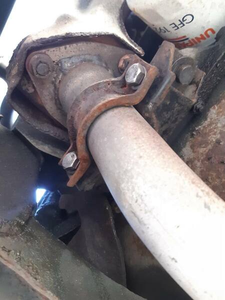

The exhaust rattle was also doing my nut in. Seemingly Mk2 Acclaims (as mine is) have an additional bracket at the downpipe to address issues with excess vibration and stress cracking at the flange (ooh er). Mine has been in the boot ever since I bought the car, so today I had a rummage through my box of random nuts and bolts and lashed it up.
Utilising nature's ramps...
187291987_315852689927268_4395275857731968894_n.thumb.jpg.212e6b2eb94f2b2a68be44118d730554.jpg
Bracket.
Where bracket go.
Bracket go'd.
You'll note it's not actually tight, when tight the downpipe blows. It's a cheap steel exhaust from the only supplier that makes them, so likely isn't the most amazing fit. So I backed off the bolts until it stopped blowing with the car running, it certainly seems to rattle less. I shall test it proper on the commute tomorrow.

Are the bracket holes quite big, just the large washers on the engine block bolts look to be stopping the bracket sliding over and meeting the downpipe? Maybe trim them to a D shape and elongate the holes in the bracket for another BL production line tactic!

Could you wrap some exhaust wrap around that very specific section to absorb any metal-on-metal vibration? Would likely only need a couple of layers just to pad out the gap between exhaust pipe and bracket?
