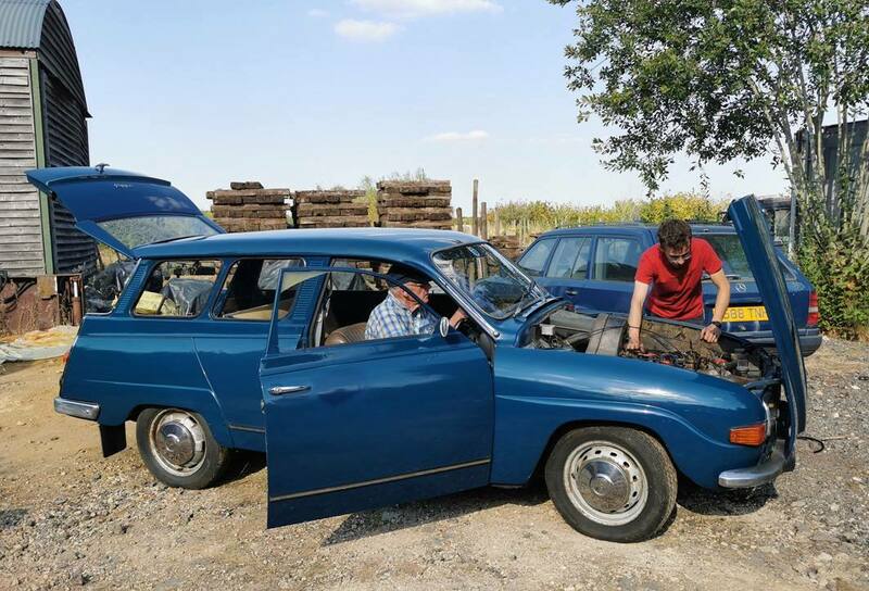

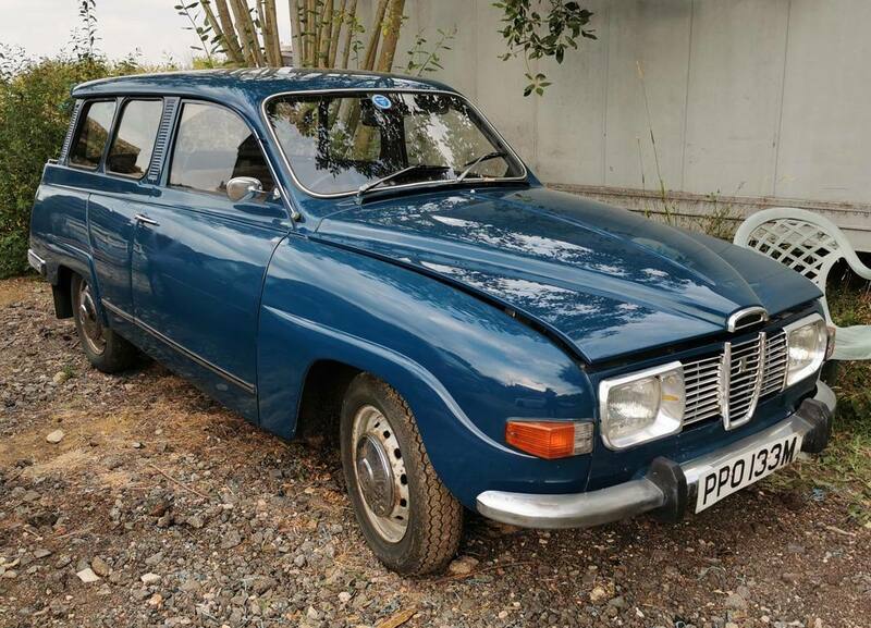

The short answer is yes we got it running.
But and it is a big BUT:
New battery and it turned over just fine on the key.
It spat out oil when we first turned it over, that turned out to be there was no oil filter. We then changed the oil and put on a new filter. I am told the oil did not look too bad for very old oil.
There was no spark and a new set of points and condenser were needed. Usual problem with modern replacement parts the wire was too short and had to be extended with the old one.
It then coughed and spluttered like it wanted to go. We new the problem was  30 year old petrol. We tried to drain the tank and got an electric pump that blew up, yes really blew up a component inside. Investigation of the tank showed the fuel level sender was seized and the bottom of the tank was a thick sludge.
We then went for start up using a can of fuel and it started ok. It ran, then we had a loud mechanical knocking and stopped it. My theory is we had a blocked oilway or even oil pump pick up strainer.
There was no clutch fluid and we added some, but now the pedal is solid and won't move.
The brake pedal also does nothing.

Bugger on the knocking.  Definitely first port of call would be the strainer I'd wager given it sounded healthy when it was running on the easy start just before I had to head home.
Hopefully clutch is just the slave cylinder being stuck and it's not too hard to change.

It was great we got the Saab 95 started but there is some more to do, we have a noise from the engine, fuel tank is out, no clutch and no brakes.
Gaskets are ordered along with other parts so there is a fair bit to do.
Clean fuel tank and refit. Change fuel pipe where appropriate.
Take off rockers and check for oil in rockers
Take off sump and check the oil pick up is not blocked
Replace the water pump
Take off all wheels and check condition of brakes
Clean interior
Refurbish clutch master cylinder and slave
