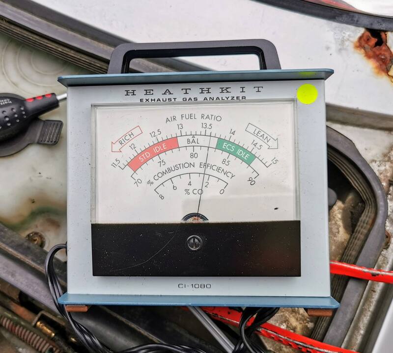

Zelandeth Posted September 8, 2020 Posted September 8, 2020 Trevi update! A slight problem generated by having fixed the vacuum leak found yesterday was that it had dropped the idle speed a touch - which given how badly the car was missing at idle resulted in there basically being a 50/50 chance of the engine stalling every time you came off the throttle. I tweaked the idle speed up a little to compensate for this. I need to look up the details for the carb to confirm that I've done that the correct way...but either way it worked and has stopped the stalling nonsense I had yesterday. Here's the details of the carb, courtesy of my phone as I couldn't get my head into the necessary location to read this! Hopefully those in the know will be able to confirm whether this is reasonably well suited to the car or not. If that solenoid is meant to have a needle or other metering device attached to it I suspect that's going to be the source of our problem as it appears that the entire plunger assembly and whatever was once attached to it is missing. This makes sense as the main jet side of things seems to be working just fine - when you give her some beans she picks up smoothly and especially at the top end feels nicely punchy as you'd expect from a Lancia TC engine. It's just the idle that's screwed up. I'm not going to delve too far into this issue as it's kind of beyond the scope of what I was planning on - but I'd like to be able to at least give an idea of what's going on for the final report I'll hand back with the car. One key bit of information I wanted was to see whether she was overfuelling or underfuelling at idle. Out with the gas analyser. Well that won't be helping matters. The red section on the gauge is the general range expected for carb fed engines...I have a sneaking feeling that the whole idle circuit is fouled up and it's running from dregs from the main jet. Especially as adjusting what appears to be the idle fuel screw has absolutely zero effect on anything - so I put it right back where it started out and left it well alone. It's obviously a fuel mixture issue as you CAN make the car idle smoothly by manually choking the carb with your hand (carefully). She sounds really lovely then actually! Is just starving for fuel if left to its own devices. Unless when I look up the service/adjustment guide for the carb there's some blindingly obvious adjustment that I've missed I'm leaving this well alone and simply noting down "Carb needs attention" and leaving it at that. She starts, drives, stops and doesn't stall every time you stop at a junction - basically back to how she was behaving when she arrived here. Just with all the air now entering the engine via the carb rather than sneaking in through leaks. Right...Enough faffing around with running issues I wasn't told to look into! Onto lighting issues. First one was a nice easy fix! Dirty lamp holder contacts. Sixty second fix. Next up I needed to start pulling the dash to bits. To be honest this has to be one of the easiest cars I've had to tackle a job like this on. Half a dozen easily accessible screws and the whole face just lifts off the dash. A further four release the panel which holds the warning lights and switchgear, likewise four release the instrument cluster. There's even bags of slack in the wiring harness and speedometer cable so disconnecting them is a doddle, and with the steering wheel adjustment dropped down to the lowest level it just lifts out. Before I started on the instrumentation though I wanted to take a closer look at the heater air distribution controls, which I wasn't sure if had any provision for illumination. Hey look a that! It even highlights which mode it's in. Neat. That's one more thing ticked off then. Dirty lampholder. While peering at things back there I was able to confirm that the main swithgear was in fact lit by a single light source and fibre optics. I'll dig my way in to that tomorrow and look to replace the lamp in it to see if we can get a bit more light out of them. On to the dash proper. Getting at a few of the lamps on that is a bit of a pain as Lancia decided that it would be smart to position the control module for the gauge pack on top of several of them. So you have to unscrew that to get to four of the lamps. Not the end of the world as it takes all of five minutes to remove and reattach, but it's still the sort of design decision that makes you roll your eyes a bit. Doesn't this look a bit happier now? Not bad illumination at all. I did annoyingly managed to nudge the tripometer reset while I was manhandling the instruments in and out of the dash. Luckily however I had taken precautions against that and noted down the reading before that. If that reading is being used to track fuel economy, you need to add 34.2 miles to the reading. In addition to the illumination, the fuel warning light apparently was also out beforehand, it now lights as part of the test sequence at startup. What I didn't realise was that the car *knows* when there is a light out on the dash. The big red warning light now lights up green when you turn the ignition on rather than red! Shouldn't be a problem to get this finished and back together tomorrow then tackle the remaining to do/investigation list. [] Investigate fibre optic illumination to see if there's any improvement to be made. [] Investigate non-functioning rear fog lights. [] Reassemble dash. [] Attack a few key areas with Vactan. [] Cooling system drain, flush and refill with proper coolant. [] Get a proper photo for the Dash at Night thread. Oh...Pretty sure I found all the necessary bits in the glove box to reassemble the lower heater vents on the dash as well so will put those back together before screwing the dash back together. Have been quite enjoying getting to work on something new. brownnova, chaseracer, LightBulbFun and 15 others 15 3

Zelandeth Posted September 9, 2020 Posted September 9, 2020 1 hour ago, Six-cylinder said: It is very strange sitting here reading the adventures of our Trevi! Thanks so much for giving me the opportunity to get a couple of jobs done so I can provide the reports! These are the sort of jobs I enjoy so I've been having a great time. Just a shame I've not been able to come up with a quick solution to the horrible idle, would have been great to be able to hand it back running smoothly. Sadly I suspect that the carb needs going over by someone who knows their secrets more in depth than I do. Plus I'm not going to go poking it too much given that I don't want to immobilise the car! It's annoying now, but that sounds like a job for over the winter when she's tucked away in storage. LightBulbFun and chaseracer 2
