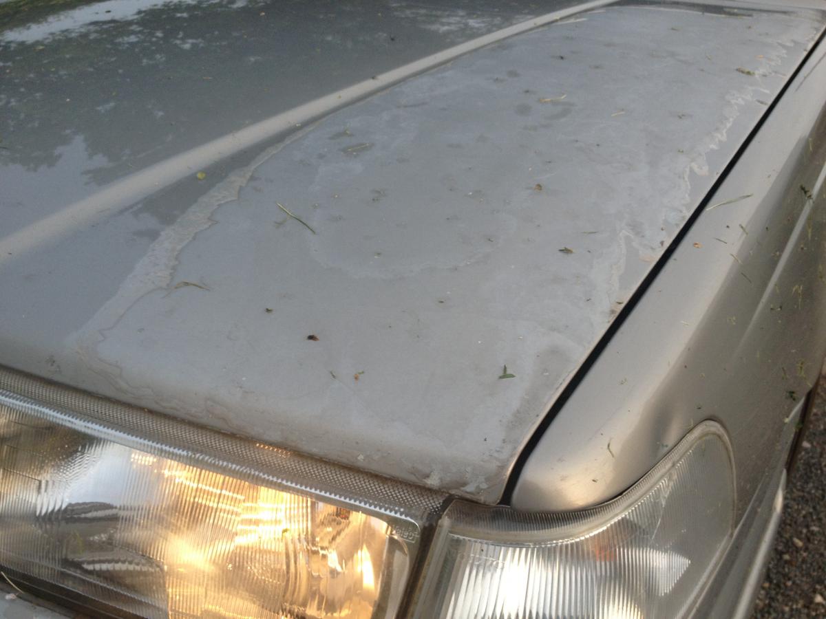

The following day I had word It was still available. I spoke to the poster of the ad, a friend of the owner, who told me the brakes were terrible, lacquer was falling off the bonnet in chunks, and it had been driven into things. Undeterred, made contact with the seller and for the money, as long as it would drive said Id have it over the phone. The problem wasnt the driving, it was the stopping that was a challenge in this particular volvo I would soon discover.

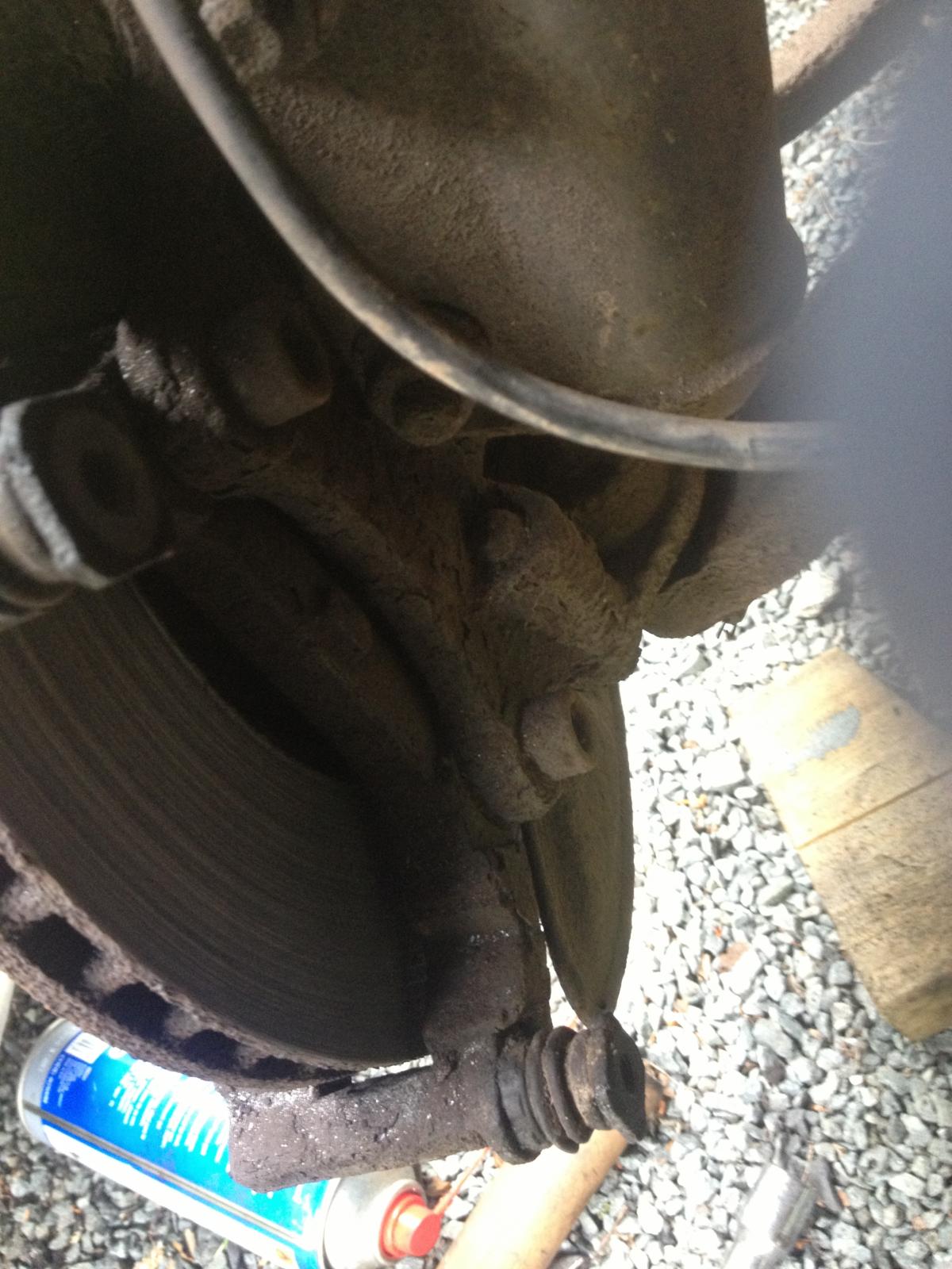

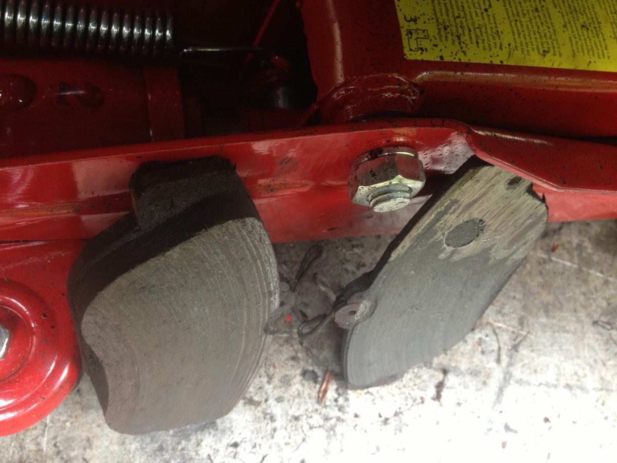

Soon Id popped the wheels off and found neglected brakes, the worst bit being a siezed caliper slide bolt on the passenger side front which has ground one pad to the metal and ruined the disc.

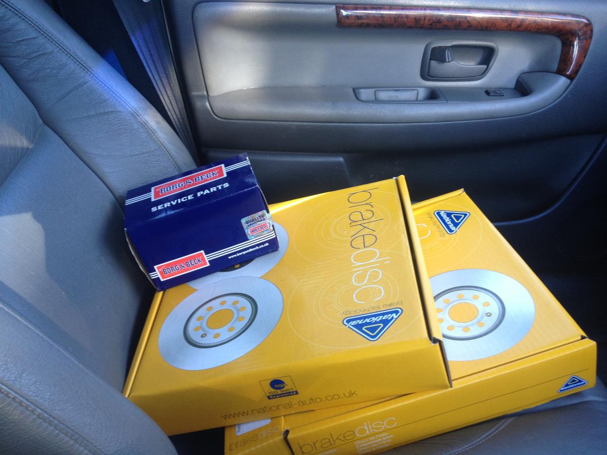

I managed to get discs and pads form a local factor off the shelf for 20 quid for the pads and 55 for the discs. The caliper carrier has that slide pin well and truely seized in it, and suggestions or tips much appreciated!

My 940 had both sliders seized in the carrier. My cure was to take the carrier off, remove the rubber boots, wait for my wife to go out and put the carrier on the gas cooker.

Maybe you have done already but make sure these new discs are right, particularly the offset, before you get past the point of no return.
Sticking slider pins is something these seem to do. Unfortunately short of heat, penetrating fluid and brute force there isn't a great way of retrieving the little bastards either. I've resorted to a bolster chisel and a BFO hammer before.
Buy new pins if you can. Other than that, this looks an excellent purchase for so little money.
New pins definitely. Then you can batter the f8ck out of the old ones. Had to resort to a smaller socket (yes really) and my electric impact driver to get them to budge on the Sirion. Don't use copper grease on the new ones. I'm experimenting with red brake grease at the moment. Not specifically designed for metal-to-metal, but doesn't knacker the rubber boots up.

If it's of any use, I make my own penetrating fluid, half diesel and half paraffin. Nothing has beaten it so far. I use one of those household spray thingys what people use to spray their plants. Actually, I'd love a 960, I've got a thing about 3.0 litre engines.
Lithium grease is best from what I hear. That said, the Haynes book of lies recommends copper grease

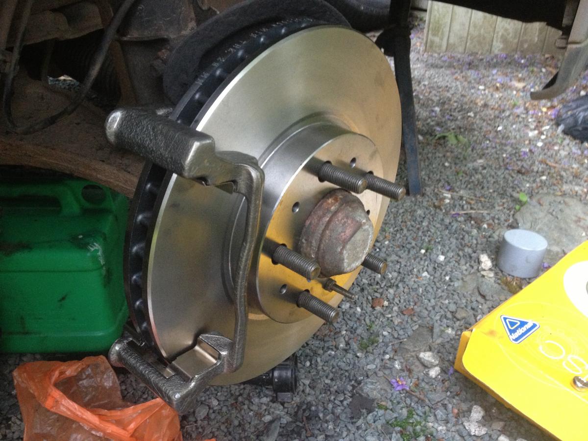

Been busy stripping and overhauling the front brakes when I find the time. After much cursing and hammering away at the caliper carriers and the seized lower slide bolts I gave in and got hold of some new replacements- £50 for the pair.
Old and seized meets new and shiny
With the caliper repair kit arriving I was making good progress....
Right until buying the cheaper pattern discs caught up with me. There seems to be a machining fault with one of them so one sits waiting to be returned to the local motor factors tomorrow. With a chod exchange road trip planned for Saturday it's another week on axle stands for moby ( big, grey and beached on the drive)
