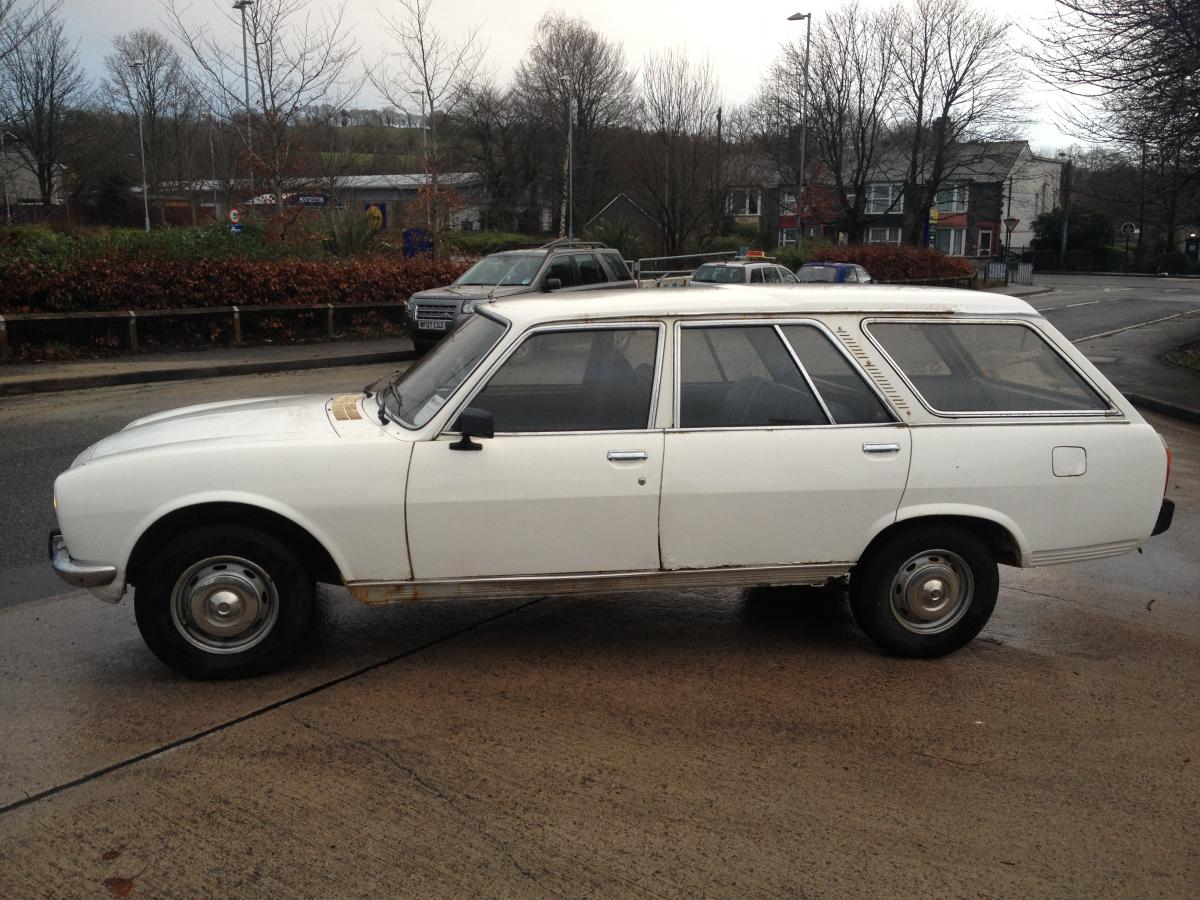

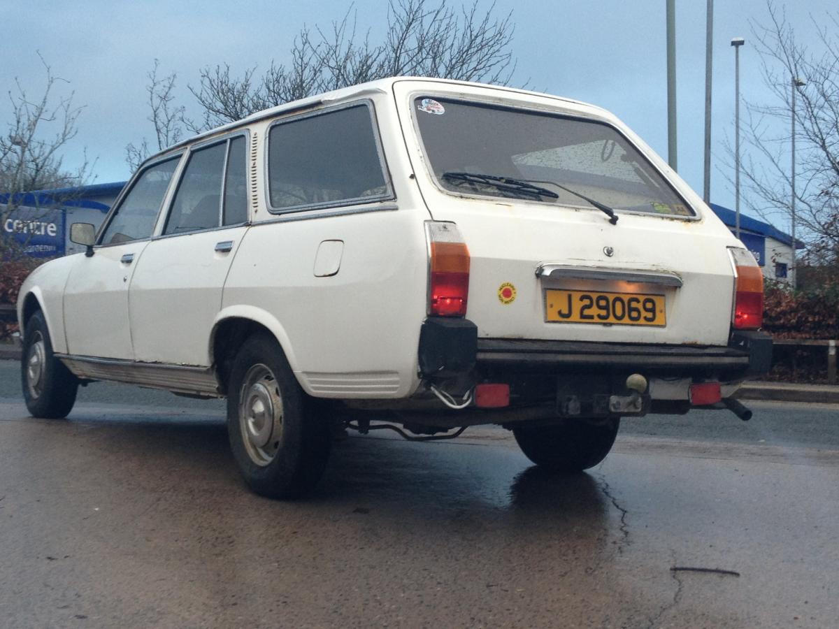

It is a comfy old thing to pootle about in. The springs are soft and long travel and, and the seats are soft and springy in the french tradition. Also due to the simple engineering (all 504 estates got a live rear axle) theres less linkages to have worn and it drives nicely too. However It does have a quoted top speed of 80mph and it gets quite boomy over 60 (could to with a 5th cog, its a 4 speeder though at some point its gained a 5 speed knob- confusing at first!)

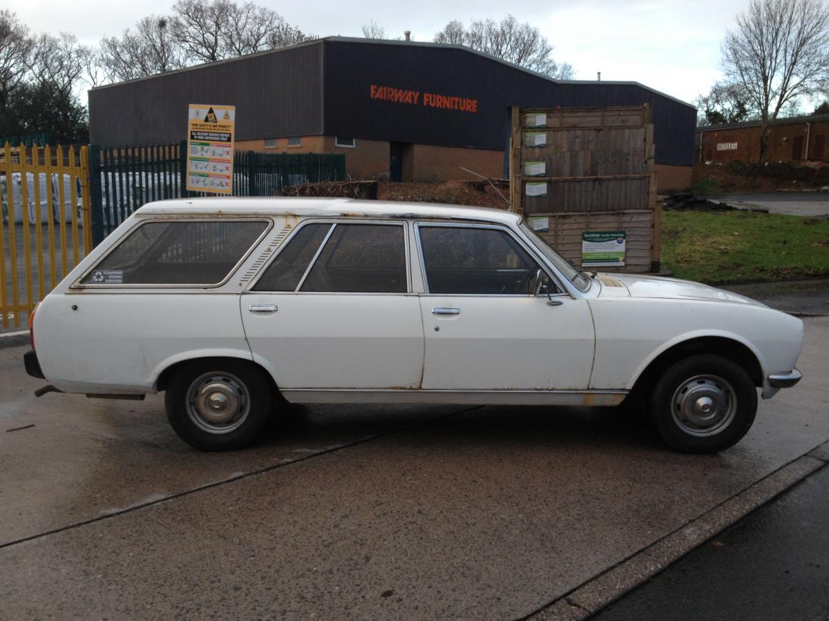

Got a few more pics in between showers today.....
I don't think its been used a lot recently, so some good old wd40 has freed up sticky hinges and locks. It is also quite good at letting water in. Thankfully no sunroof to cause bother, but the rear hatch is a bit of a mess (all sorts of repairs over the years, fibreglass the favoured material) The weatherproofing membrane thing isnt there so theres something to attend to. Previous repairs have sealed up the drain holes too, so a few holes will stop the inner shell of the rear hatch from pooling with water and spilling into the interior.

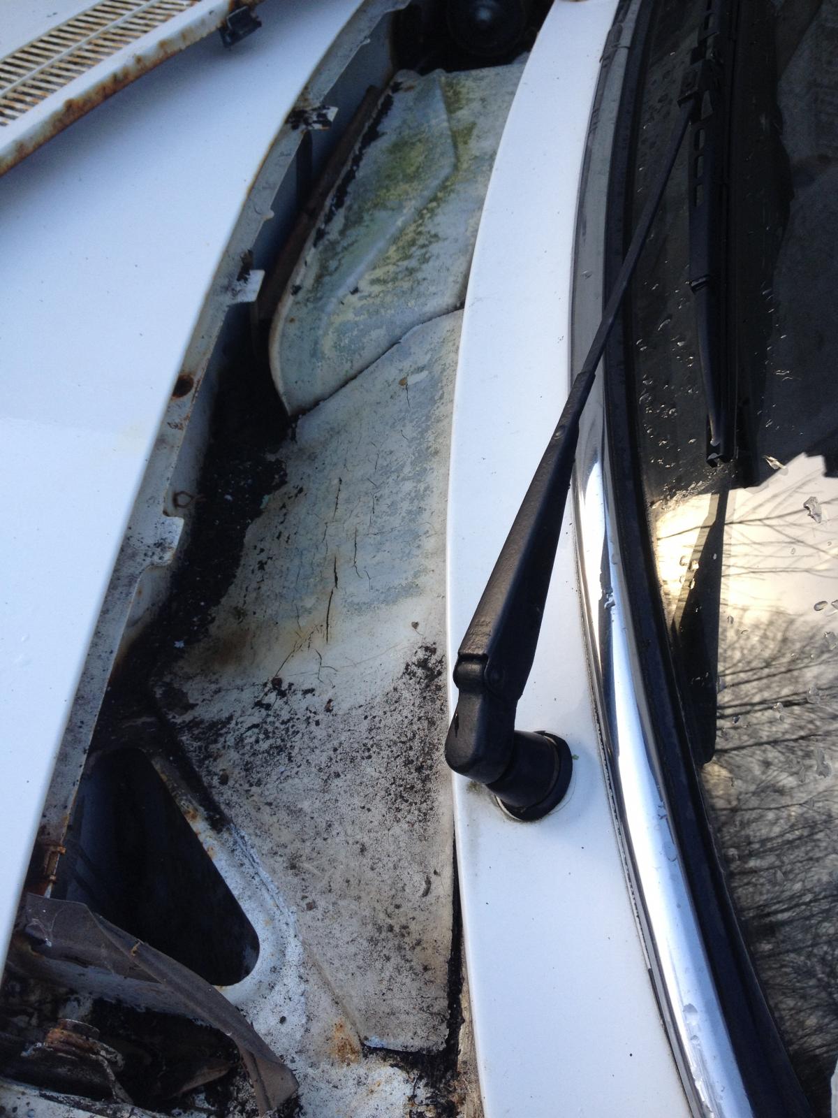

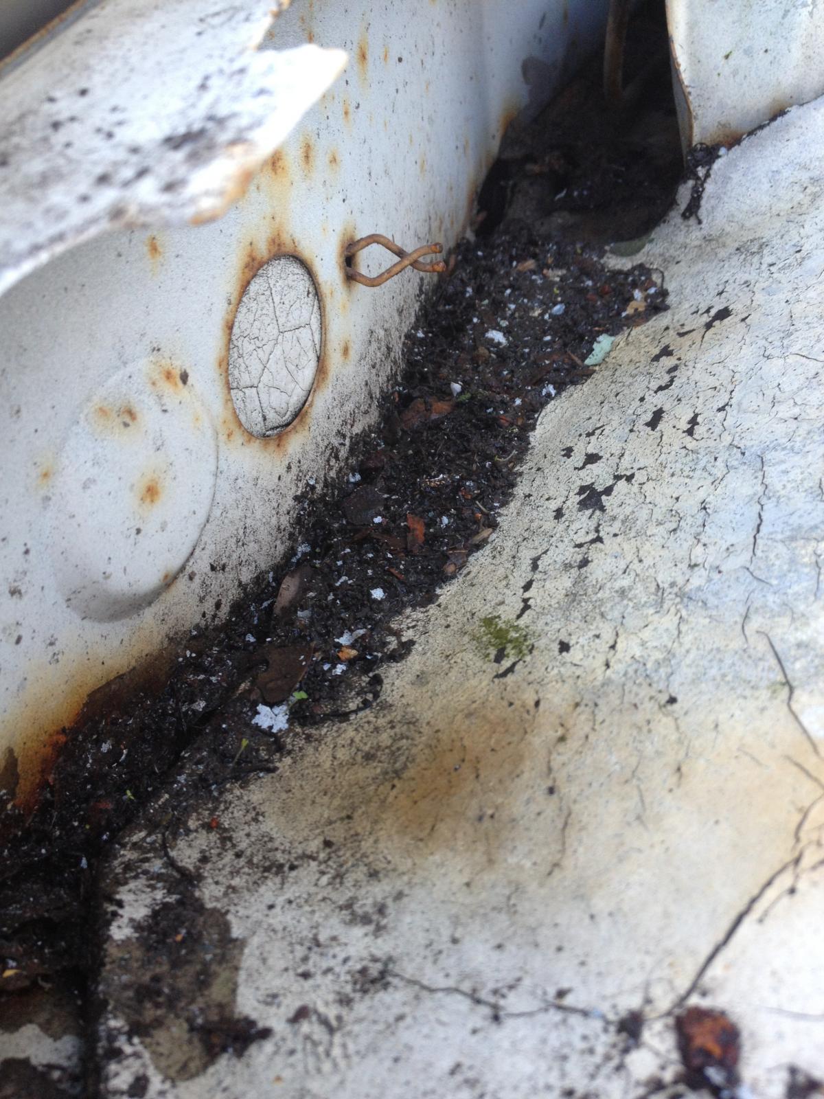

I also took the top of the bulkhead off to see what the heater plenum and nearby metal work was like.....
Apart from a bit of soil and a few woodlice, once cleaned up it was solid. When its all dry in the summer I will probably waxoyl it. The waxoyling will also happen to the sills, main underbody box sections and the single rot free door. The 3 others are repairable but I recon once the rear hatch is prodded about with there will be little left worth salvaging.

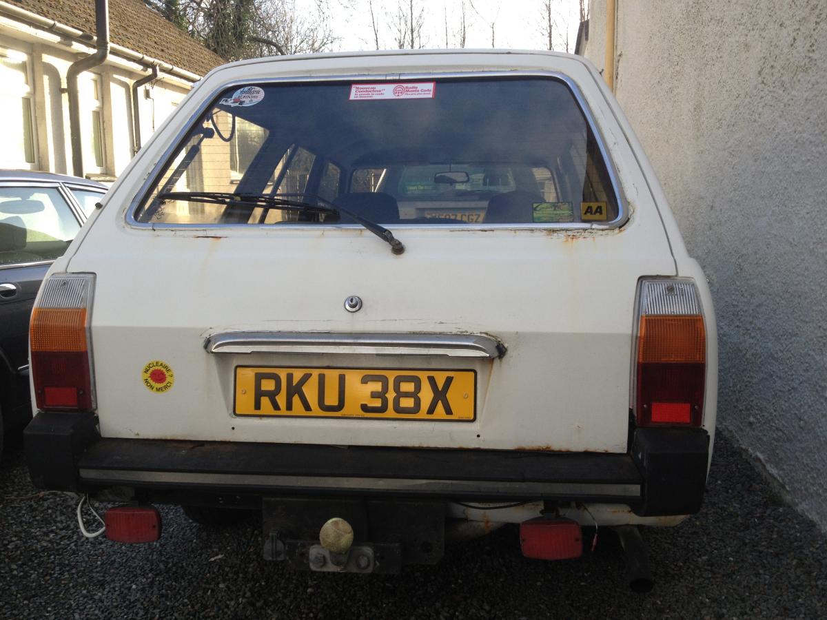

I have in my hands a crisp V5c that arrived from Swansea today. I can haz uk registration!
The 504 is officially now known as RKU38X. To blank looks from the wife, I told her its a nice reg the bods have given me, Whatever was the verdict judging by the body Language! Had some pressed old style font plates made up which are on their way to me over the next few days. Just relieved the 504 is now properly documented and uk legal!

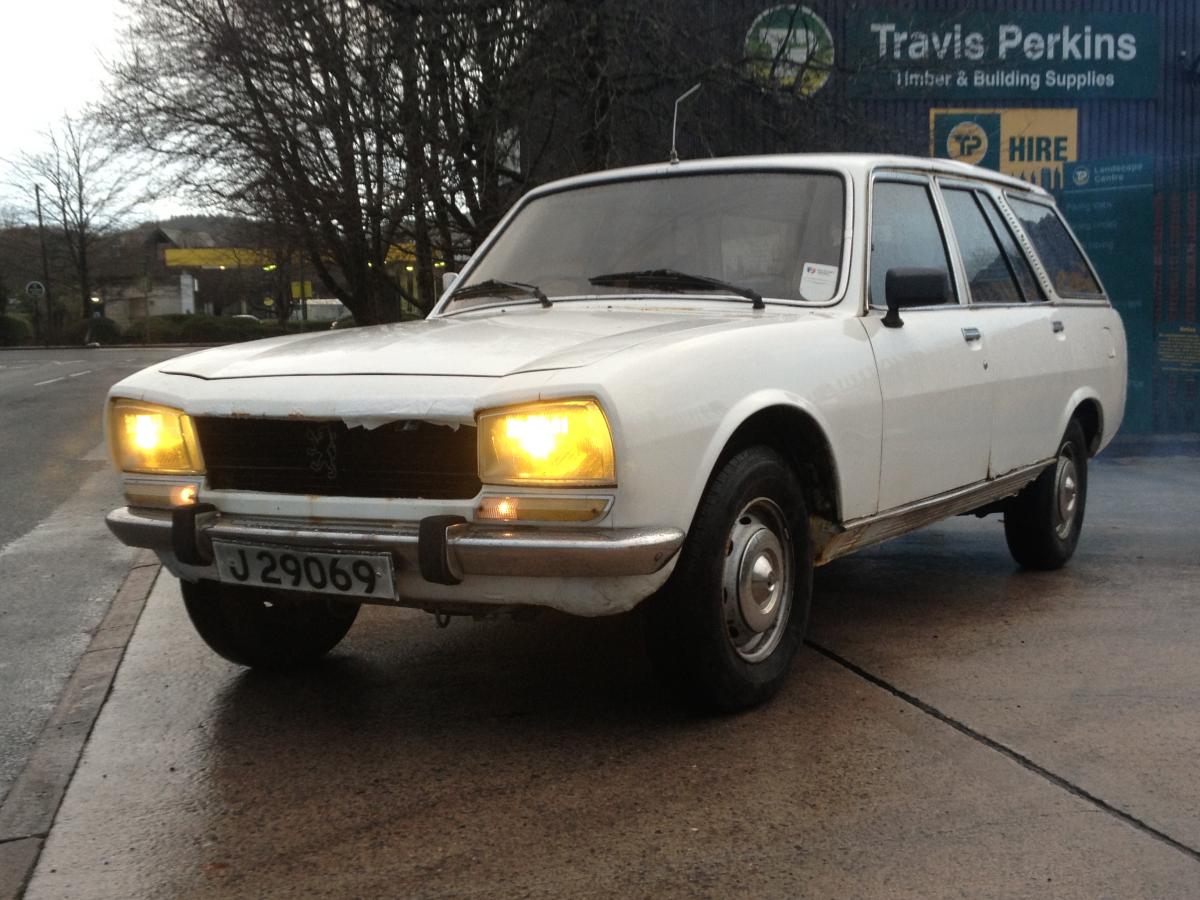

Excellent news.  That Travis Perkins photo has to be a strong contender for next year's calendar.
Where did you get the pressed plates made up, out of interest?  Might be in the market for some of these.  Pics!
This is brilliant, top work mate! Agree with Skizzer, love the Travis Perkins front on photo

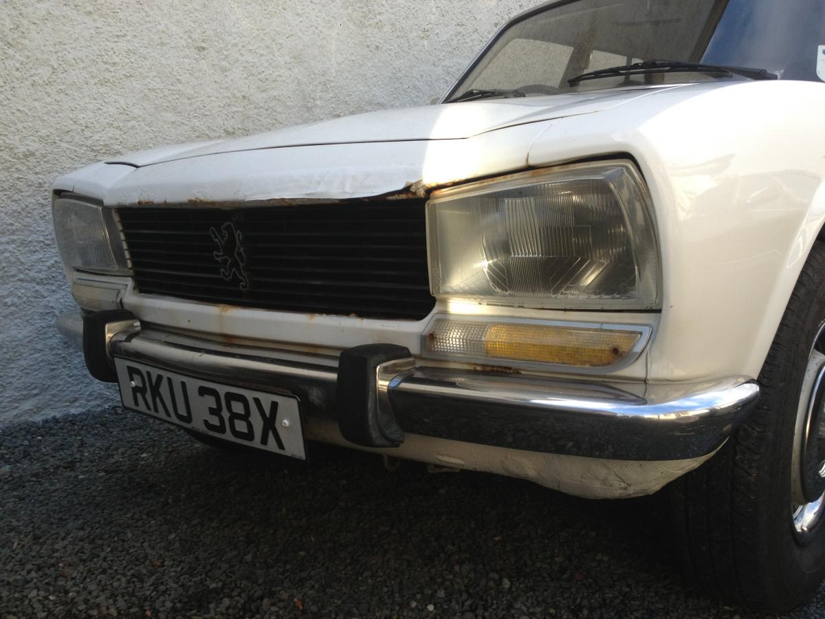

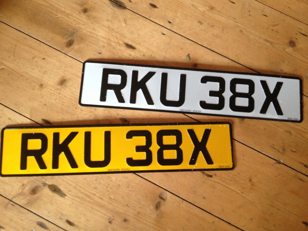

Plates arrived today and I fitted them. Rang the insurance people to give them the new reg. Pleased with the utility press steel plates suiting the car and that my papertrail to get the 504 official is now complete!
Epic plate!  6 digits for free!   It would not be strictly in period but I would have been very tempted to red-line border those for that London street-scene overstayed-the-temporary-reg. look!    Perfect car - I love it....
Serck plates for the win!  I'm considering some of these for the (A reg) Jag, as the old ones are disintegrating.  I think the SD1 looks better with acrylics, but they want replacing too because they've got the new narrow letters.
Those plates look the biz.  Only one way they could be improved really: laying them on the ground and driving the car over them a few times for a bit of "weathering" ;)
Plates are great and well done on sorting it all out. Looks a nice ride and just needs a autoshite dealer sticker.
