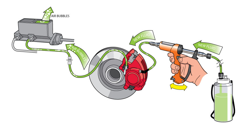

dozeydustman Posted February 3, 2018 Posted February 3, 2018 Have you tried bleeding the system in reverse? i.e. forcing fluid through the slave cylinder bleed nipple with a syringe or pressure bleeder up to the reservoir. Can help with tricky little bubbles that won't go or cylinders with the bleed nipple in a stupid place. You don't need the trigger thing in the picture below, just get a huge syringe and a bit of rubber hose off ebay or amazon for pence.
