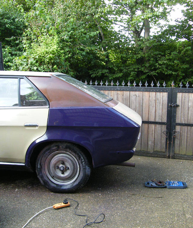

vulgalour Posted August 24, 2012 Author Posted August 24, 2012 Been holding off doing any more on the car today, I'm in no fit state thanks to my knee injury and I need to rest it, scrabbling around on cold concrete isn't going to help that. However, I've sourced some new brushes which are a better quality than the one I was using and a supplier for appropriate thinners so some progress has been made. I'm also going to be tidying up the light cluster and wheel arch trim so that they're ready to go back on the car when things are finished off. Has to look worse before it can look better. The next stage on this panel is to flat it back again with finer paper to see where more paint needs to be applied. I'm expecting the crashed corner to need more paint yet as on the previous flatting back it did reveal some high spots and thinned the paint more than I would have liked. For now, the car is watertight on this corner and as rust free as I can manage so things are improved. Everything that needs to be said about brush vs spray has now been said, I'd like to see that put to bed now. Everyone has made their opinions known, which is no bad thing, it's up to me to demonstrate how good or bad a finish I can achieve on my car with my chosen method. As I've already mentioned, I still need to experiment with paint consistency and application technique before I've got this paint behaving exactly how I'd like, but I'm confident that thinner paint and slightly longer drying times would help achieve a better finish per coat. I'm also confident that I can get a good smooth finish that is comparable to the shine on the beige that with a coat of lacquer will become better than the beige. What it needs now is for me to be able to put more hours in on this and for that I need to not have a damaged knee so I can get back to work and earn some more pocket money.
Morgan84 Posted August 24, 2012 Posted August 24, 2012 May I make a suggestion ? A friend of mine painted his Landrover with a foam roller using synthetic paint,and it floated out into a perfect 'Landrover finish' which looked like it had been sprayed. He used household paint and roller painted his MK1 Fiesta to tidy it up,and it looked pretty good for a couple of years until he moved it along;it looked better than some spray jobs,so maybe a combination of brushing and a small foam roller may offer a good solution to not having brush strokes,and having a smooth finish ready to flat and polish up Brush the door gaps,and roller the large areas Give it your best shot,and hope it comes out as you hope it will
vulgalour Posted August 24, 2012 Author Posted August 24, 2012 Agreed, rollering is better, but if I'm sticking with the cellulose paint I need to find rollers that won't dissolve in it. My favoured method with the paint I used on the Polo was to apply with a brush and dress with a roller as that gave a spray gun fresh finish that was easy to work with and was the method I was going to use on the Princess, but then the roller decided to melt into the paint I was using, giving me a bit of a headache to resolve. If I can find cellulose friendly rollers, or get the same paint the Polo is painted in mixed to an accurate copy of Aconite that would be the best solution I think. I'm off to Sheffield on the 3rd so I'll see if I can drop in to the shop I bought the Polo paint from and find out if he can mix me the purple up to order, especially since I know better how to work with that paint than with the cellulose.
M'coli Posted August 24, 2012 Posted August 24, 2012 Buy lots of foam rollers and change them prior to them dissolving ! Rollering on high-build primer including the door gaps is an excellent way to get an idea as to what the roller disintegration timespan is, then it can be flatted back easily after a day or two using 320 production paper if it's dry or wet'n'dry if it's pissing down. I rollered on the primer for the Avenger but sprayed the metallic topcoat using an electric HVPL, waited a bit and flatted that usin wet'n'dry. I would recommend the roller for primer especially high-build - none of it fucks off into the breeze/the neighbour's car/their washing etc. when it's blowing a gale.
Cavcraft Posted August 24, 2012 Posted August 24, 2012 This won't help but I'm going to tell you anyhow: I once owned a Maxi that had been handpainted in Tesco 'Bamboo' house paint. It was actually far, far worse than it sounds.
hairymel Posted August 24, 2012 Posted August 24, 2012 hey angyl seems you have lit a purple touchpaper my first custom car build in the late 80's was painted in a mgb purple (205 turbo16 grp b plastic kit converted to road spec )

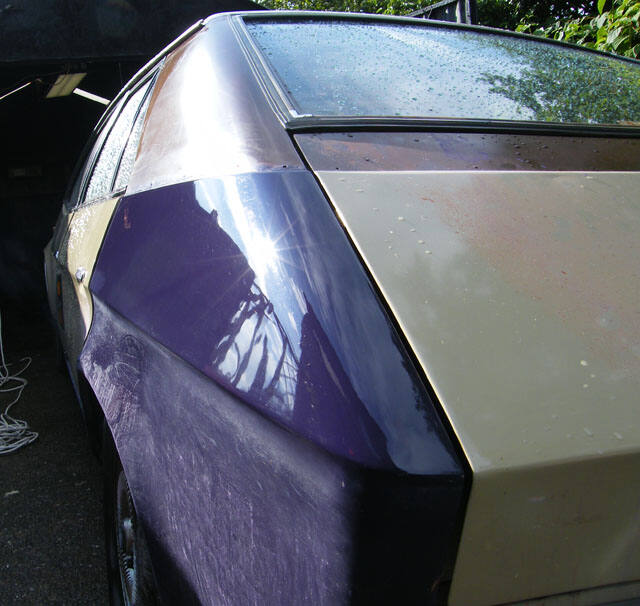

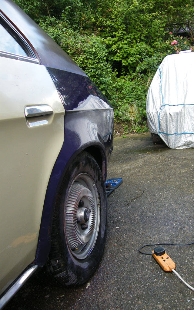

vulgalour Posted August 25, 2012 Author Posted August 25, 2012 Today has been another busy day, interrupted by thunder storms. First thing was to remove the front number plate in order to tidy up the brackets that hold it in place as they're a bit rusty. Got me thinking about how tidy the front looks without the plate. The bolts for the brackets match the ones for the bumper which is handy as I still haven't found the misplaced bolt. For now, I don't have a number plate on the front but I'm considering fixing it to the air scoop permanently... I'm undecided. Then it was paint time. Much sanding down to 2000 grit was done, it didn't take terribly long with two of us working on it. Then cutting compound and the polishing mop to see what we could achieve. Ideally, this panel wants another coat of paint for a really great finish, but it'll do for now. Of course, we couldn't just leave it at that, so the bottom half got done as well. I reckon that's not too bad, all things considered. Final job of the day was to swap the good lenses into the replacement light cluster after cleaning up the chrome on the casing and refit it along with the bumper to tidy up the back end properly. This job and the big storm rolling in put an end to the day's proceedings.
PhilA Posted August 25, 2012 Posted August 25, 2012 Nice finish. Elbow grease pays off. Still not taken by Aconite, but you do realize it'll never look factory. There's no orange peel on the vertical surfaces Part of me now sees the front with a US size number plate being a better fit. I think this place is getting to me. -Phil
trigger Posted August 25, 2012 Posted August 25, 2012 That actually looks better then it should do, well done!
Mr_Bo11ox Posted August 25, 2012 Posted August 25, 2012 Hey fair play to ya that does look pretty freakin decent
Morgan84 Posted August 25, 2012 Posted August 25, 2012 That looks very nice indeed,if you can get the whole car to look as good,you will have a lovely looking purple gem. The whole brush,spray or roller method is irrelevent really,as when you flat,then polish it,you are making it flat,and then polishing it to a flat shiney surface,so any brush or roller marks will be flatted out anyhow.Finish it off with a nice gold pinstripe,and it could resemble a Cadburys Princess 10/10 for effort,and showing that there is more than one way to cook a egg !
vulgalour Posted August 25, 2012 Author Posted August 25, 2012 When finished, I have seriously considered approaching Cadburys or the makers of Ribena to see if they'd be interested in paying me to provide the Princess for an advert. Could be fun.
Mr Lobster Posted August 25, 2012 Posted August 25, 2012 Gotta say, thats well impressive. GR9763846 work.
Lord Sterling Posted August 25, 2012 Posted August 25, 2012 Looks brilliant VA, really nice, how are you planning to do the door shuts and engine bay?
barefoot Posted August 25, 2012 Posted August 25, 2012 I am astonished at that.& take back 90% of my previous comment.
Pete-M Posted August 25, 2012 Posted August 25, 2012 It is looking far better than I imagined, so well done. Gonna be a whole world of work doing the whole bloody car though innit!!
vulgalour Posted August 25, 2012 Author Posted August 25, 2012 @Lord Sterling: carefully Most of the engine bay can be got at without removing anything due to the way BL designed it, which is nice, but I suspect she'll have to come off the road for a couple of days to do behind the radiator. Doors and boot lid likewise will have to come off to get where the hinges are properly, but most of it can be got at with panels in situ as I won't have to do masses of masking off. I spent a bit of time today trying to realign the boot lid as it sits a bit high at the trailing edge but I think the previous weld to where the lock is in the boot lid is making it sit too high, annoyingly. I'll know better when we strip off the three or four pounds of filler and paint off the panel.
