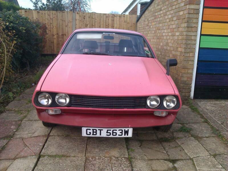

Good news!  I drove the Princess today :D
So far so good.  It's running on fuel that's pretty old at this point which isn't helping matters so the idle is a bit lumpy until its warmed up.  Other than that, all seems good.  Had it up to temperature and no bubbles in the coolant, no signs of bubbles or coolant escaping at the head gasket joint.  The only thing that had stopped me last tinker session was having the plug leads in the wrong order, once I corrected that we were all good.
Haven't gone far in it yet, just to the end of the street and back, because I've got no side mirrors at the moment and you really do need those down here, especially with the massive C pillar blindspot the Princess has.  It's also filthy and the glass is difficult to see through, especially the rear window.  So I need to give it a wash... and the tyres are a bit flat... and I need to put the plastic face trims back on... and maybe empty all the Maestro spares out of it... but it works!  So that's a good thing.
When it stops raining I'll get the mirrors back on it (need to drill holes, I'm going back to those black wing mirrors I really like because they're nice to drive with) and give it a proper clean inside and out.  It's a bit of a Maestro parts shed just at the minute which isn't ideal.

Five mile test drive?  Completed it, mate.
Aside from being grumpy until warmed up (I think a lot of this is down to the old fuel), it behaved impeccably.  Brakes are still excellent, temperature was stable even when sat in traffic, and no sign of any leaks or head gasket woes.  I'm cautiously optimistic.  The manual recommends a high idle for a period of time, or a five mile (non motorway/cabbageway) test run, and since the latter was decidedly more fun that's what I did.  I'll then check the head bolt torques once its cooled down and hopefully it will be fixed.
It was actually a joy to be behind the wheel again, I've missed driving this car, I always do when it's off the road for whatever reason.
