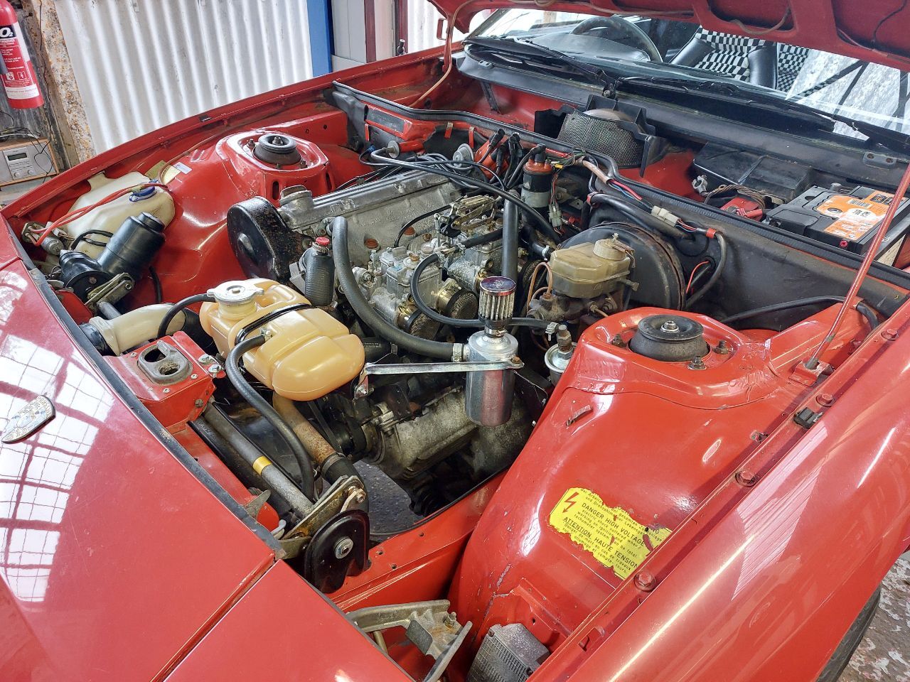

Remaking of the £100 pipe in progress:
PXL_20251019_110140655
Total cost so far - £2.69 for another two pipe clips.
Cheapo Screwfix pipe bender works a treat! Needn't have worried about using 8mm pipe - the pipe out of the accumulator is that diameter anyway.
  • Like 7
Completed pipe now ready to re-fit:
PXL_20251019_121710910
All fixed in place now and no leaks.
Car starts first time.
Pressure sinks when warm, same as before, but it does seem to start fine 🤷‍♂️
Going to get it back on its wheels and see how things go...

Stalled out when idling, so I richened the mixture by 1/4 of a turn on the Allen key, which seems to have done the trick.
Well, it's still not right - not really running properly and wouldn't re-start hot yesterday.
So I've had enough and stuck it in the barn and walked away. I have literally no idea what to do with it otherwise. Total junk.

Probably the only realistic option is to rebuild the fuel distributor. Parts are about £50 for the kit and there look to be plenty of guides online. My hands are really not steady enough for that kind of work though, and I'm not wasting another £500 for a rebuilt one only to find the fucking car's still a bag of shit.

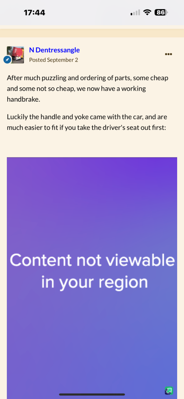

Just found this thread and had a good read through. Not sure of your image hosts @N Dentressangle but most of them are unviewable to me on laptop or mobile; wifi or 4/5G
Imgur have decided they aren't playing by the UK's new internet "safety" rules (where you have to disclose your photo ID to a kindly third party to prove your age) so have just dropped support for the country entirely.
Yeah, it's Imgur being twats.
You can get around it by using a proxy or something like that. It's a PITA

I just need a direction on what to investigate / fix next really. The fuel distributor is the only part left untouched so far I think, so logically it probably needs a refresh. Which isn't dear if it's a DIY with the kit job.
Plus my far more dextrous and mechanically gifted engineer mate has offered to rebuild the fuel distributor for me, so if it IS that then we should be OK.
