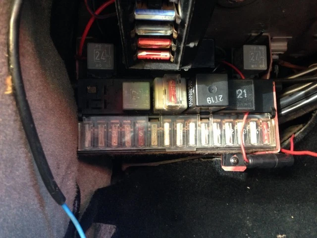

This blew fuses (obvs) but also fucked the indicator relay. Replacing both of those still gave me indicator weirdness - relay going mental, telltale on but no indicators etc. Hmmm. At this point you should know the Porsche's fusebox and relays look like this:
That's the passenger footwell BTW. Usually the battery tray rots through and it all gets drenched and doesn't work. Mine was dry, but had been standing for 25 years.
If you've ever dealt with continental fuses before then you're probably way ahead of me. I went through all the fuses, cleaning them and the fusebox contacts with sandpaper then meths and a cotton bud, and EVERYTHING WORKED PROPERLY!

I love that the fuse box on that is virtually identical to a late 60’s beetle. Only good thing about those fuses is it’s easier to wrap them in foil/wire/nail as a get you home bodge!

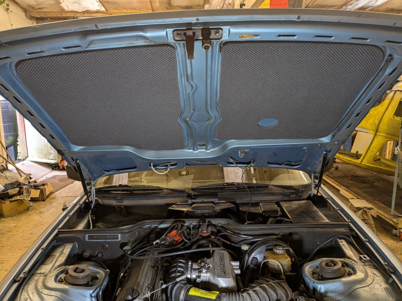

NVH work next. Under bonnet foam left the chat many years ago so I have new stuff from Design911. But first got to clean off the old mush. Bon Jovi moment:
And all done:

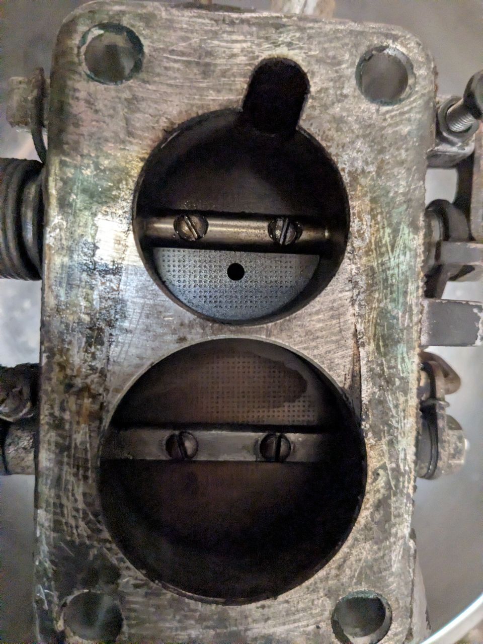

Next puzzle - should there be this small hole in my throttle butterfly?
I’d take the advice of the great Tom Jones on this - it’s not unusual.
Had similar age things with a similar hole, seem to remember it was to do with smoothing transition between the idle circuit and the throttle plate opening, but that might be nonsense!
