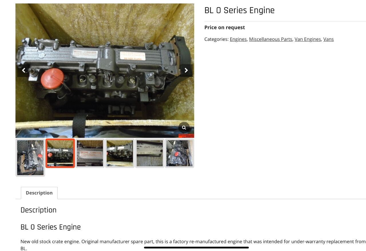

Low compression also means low power - a heady 61 bhp. I think I've bought the only motor vehicle which is slower than a Series Land Rover. Theoretically, putting in car-spec pistons would raise the compression and give more power, but I bet it's not as simple as that. And anyway, where do you get O Series pistons from these days?
The AROnline article on the O Series engine gives the impression that the B Series crankshaft was used in the O Series, which it wasn't, not quite. Apparently the dimensions of the bearing journals are the same, which on the face of it should make bearings interchangeable - although, mindful of the 'Don't assume anything' rule, I'm not counting on it. Still, since my Sherpa has only done 50-odd thousand miles, the bottom end of the engine should be in fine fettle, so I'm not thinking about crankshafts and bearings at this stage.
Aside from those similarities of the crank,  the B Series and O Series engines are not related. The O Series is not the B Series with an OHV head - that's a myth all of its own!

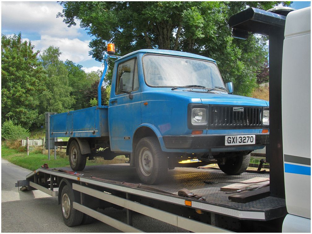

After a few years as an all-purpose farm truck it came off the road and was just used on the farm land only. Then in its last few years it went into the barn and wasn't used at all. So it's quite likely that it hasn't been near an MOT station since before 2005. The first time it came to the attention of the authorities was when I bought it and put it on Sorn. That's the one piece of info the records have on it.
The odd thing is, I think it's quite likely that it has never been on the road in England. Northern Ireland, yes, and now Wales - but not England. If it left the factory with other Sherpas on a transporter (which I think is likely because BT were buying lots of Sherpas at the time) it would never have got its wheels on an English road.

I like that...but they can't tell if it's a 1.7 or a 2.0 because the engine number has been changed. It's a gamble - if you're lucky, it'll be a 2.0 high-compression engine. If your luck's out, it'll be a 1.7 Commercial!
It's definitely a rebuilt engine. It looks like it's been painted with silver Hammerite, even over the alloy cam cover, and that's not a factory finish.
There aren't any external differences between the different types of O Series engines (the 2.0 has bigger bores), but all the same you'd think there would be some mark on the outside to show what's going on inside, if only to make it easier to find out the spec without squinting at the engine number.  At the factory it would have been necessary to identify the engines before they'd even been issued with a number. Perhaps the ID mark is under the Hammerite.
That bit about the 2.0 engines being unleaded-compatible, but the 1.7 engines aren't, is  wrong. That's another myth - one of many. Both engines used the same head. I know where they got it from: it's on Wikipedia, without any kind of reference. It doesn't even say 'citation needed'. Someone just made that up, stuck it on Wikipedia, and now it's a 'fact'.
