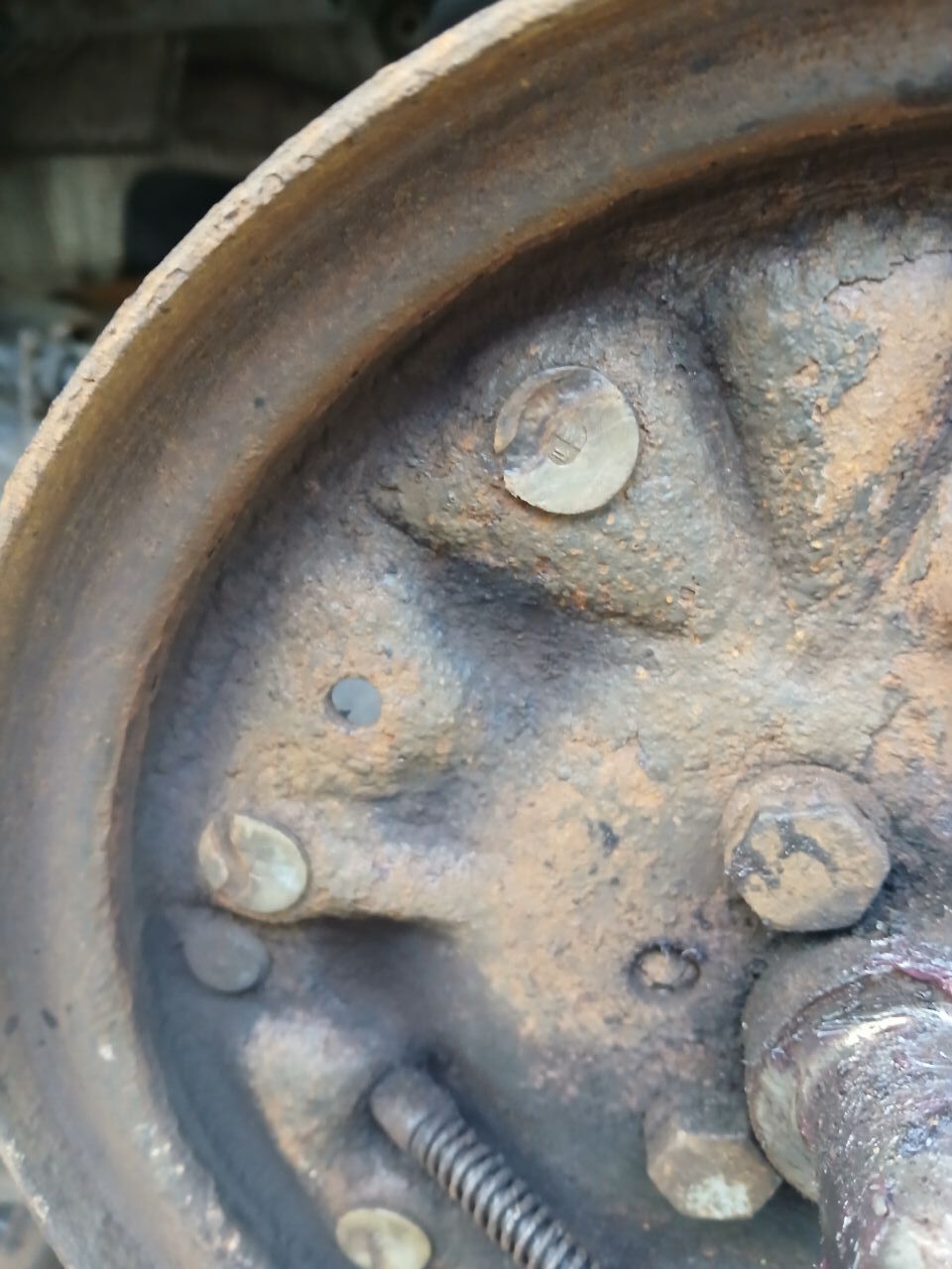

After having worked out via YouTube how to loosen brake shoes via hole in hub. Shoes are pretty worn and cracked.
£68 for. Complete  set of shoes cylinder and drums
Or £15 for just shoes.
Parts canon is loaded.
Via autodoc

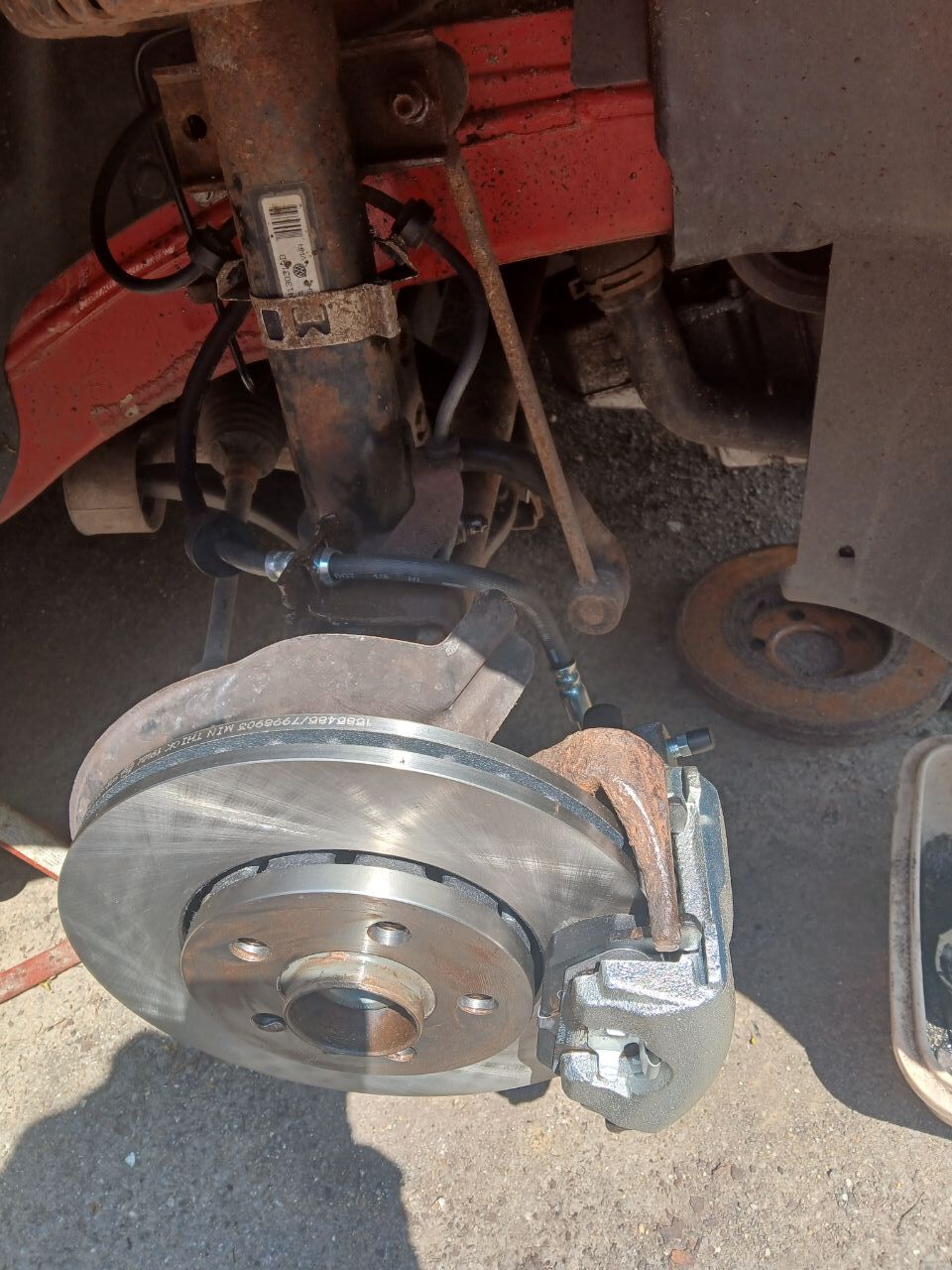

Front brake calipers ,disks , pipes, pads and rear full set shoes, cylinders and drums £217. !

In following pic what are the round hard  plastic plugs called ?
They are very worn and the brake shoes slide on them. Would be a shame not to replace whilst in there.
So  what are they called and where to buy please. I guess all brake parts are the same as vw polo stuff.
front brakes coming along nicely

I’m not sure what they’re called, but if they’re the same as a Polo then I’ve recently bought these https://www.ebay.co.uk/itm/304789320966

Drum brake plastic plug things arrived.
