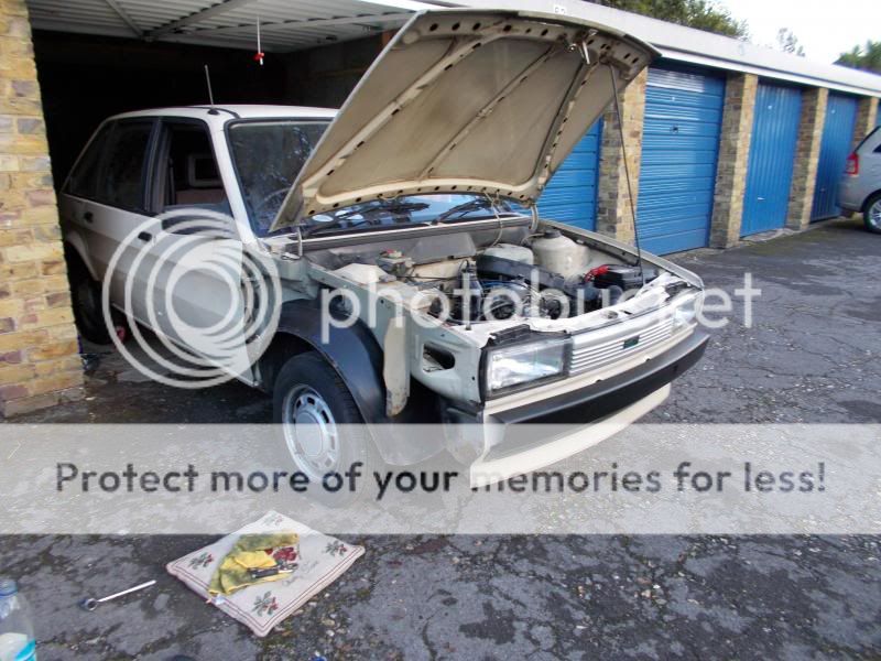

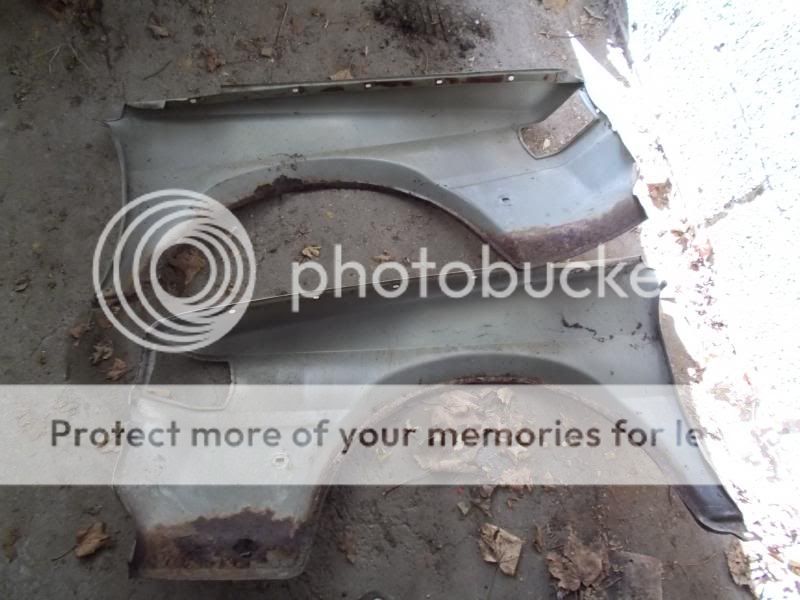

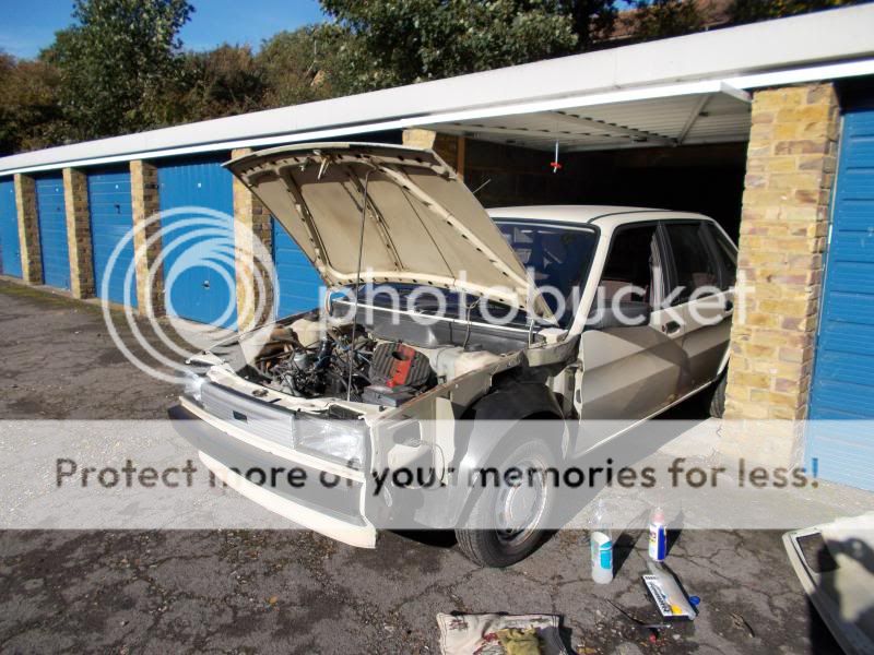

I got fed up of seeing the rotten wings so spent a couple of hours removing them. I was amazed how easy they were to get off, none of the bolts sheared and apart from one that needed to be wire brushed before I could get the socket onto it, all came out without a fuss. I suppose this is what comes of working on a 28 year old car instead of the 50-60 year old cars I usually work on. It's nice, I like it! At least they aren't welded on, that would have been a ballache.
Inner wings are jolly good despite the dismal factory rustproofing, the arch liners probably helped a lot. I was expecting to find rot at the front of the sills but it was like new under the dirt, which was nice. I've given it all a really good clean and plan to do it with zinc rich primer and beige hammerite to ensure longevity. I have big tins of both at home.

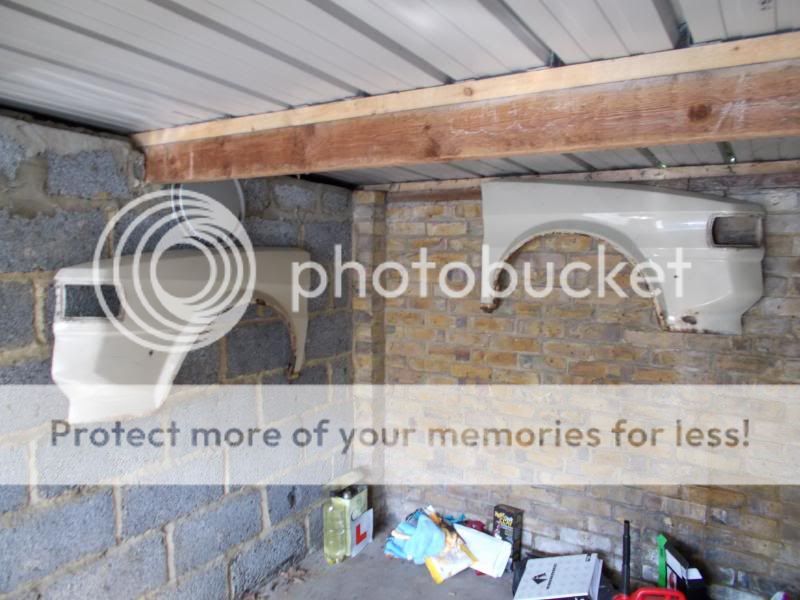

Old wings:
Which now make pretty good wall ornaments.

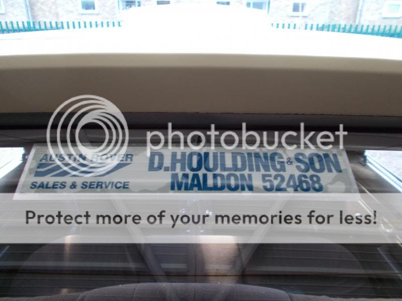

I then started fitting the new dealer bits! The new sticker was a right pain to fit but it looks pretty good.

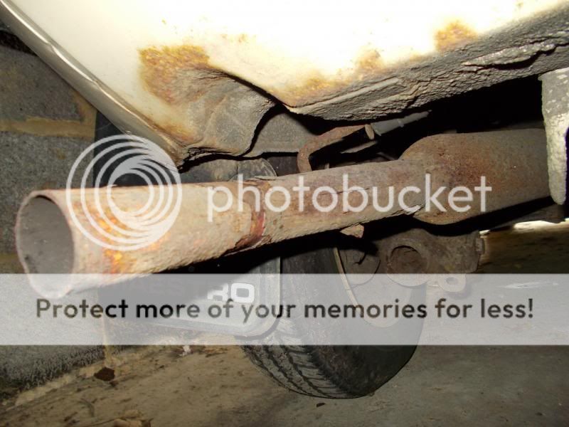

While I was fitting the rear plate I noticed the exhaust back box is looking very tired, I haven't inspected the rest of the system yet but Gary said it was blowing from somewhere so it will probably need a new system in the near future. Hopefully I can bodge it up enough to get an MOT as I don't fancy grovelling around under the car fitting a new one. I suspect it is the original, so not too bad an innings.

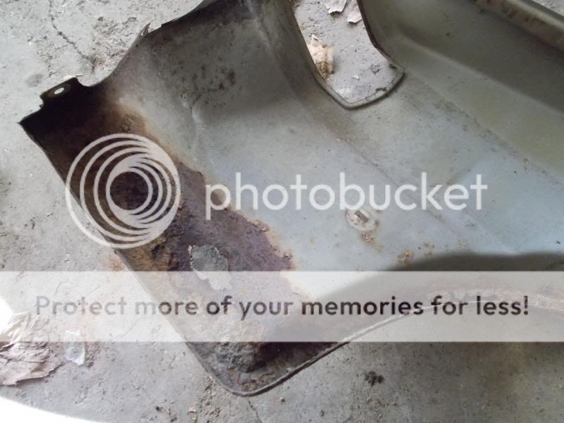

And these are the scabs at the bottom. The metal is pitted but wouldn't succumb to the prod from a screwdriver. The inner frame of the door looks good.
I was wondering if I could get away with a splash of rust converter, then a skim of filler on the bits that aren't holed...any advice?

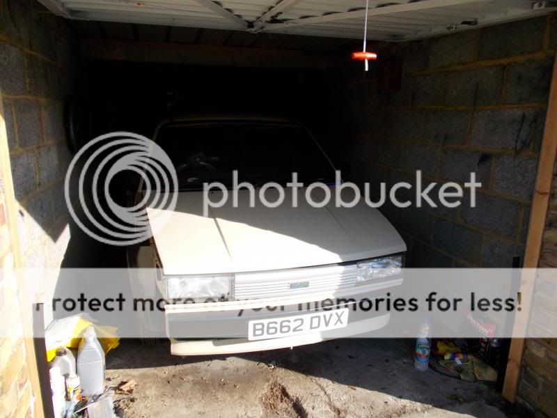

Well I spent a few hours down at the garage today. I adjusted the new wings to get them fitting better, they are pretty good now apart from the bonnet to wing gap on the passenger side which is still a bit small, but the bonnet does shut now. I then went over a few of the scabby bits with rust converter, fitted the indicators and bumper end caps, and tested all the lights. I knew Barrett had a puncture when he was using it, so the next job was to get the flat tyre out of the boot and go and get it repaired. However, on inspecting the tyre I noticed the inside of the wheel rim was badly buckled, not sure how Barrett managed that, maybe he hit a rock or something? Fortunately a local tyre place were able to beat out the damage and fit a new budget. The original spare was then returned to the boot, despite Gary's concerns about the age of it I examined it carefully and couldn't find any perishing or bulges, it's got good tread and holds air so I might as well keep it! While I had the wheel off I inspected the disc and pads and they are in excellent condition with minimal wear, which is something.
Here's how it looks at the moment.
