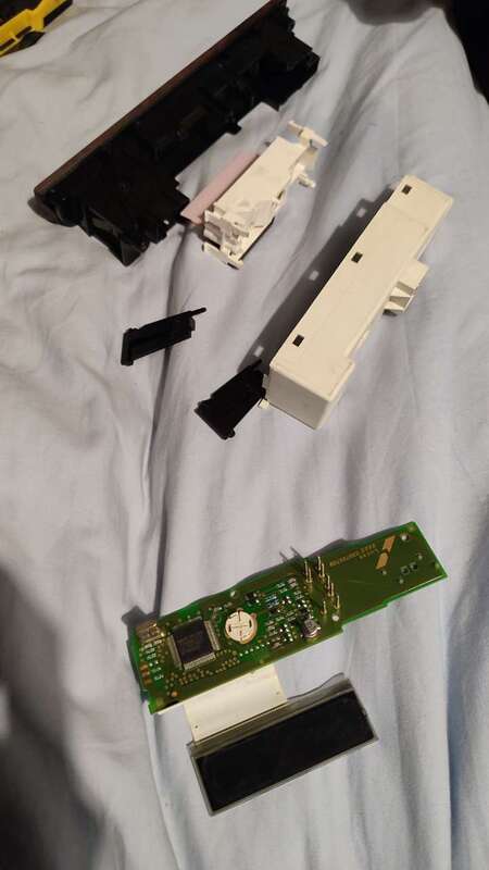

The clock doesn't. It's a Rover, TADTS! annoyingly it isn't just a clock but is also the radio display so I would very much like it to work, there are too many missing segments for it to be of any use.
Stripped it to bits, tried the iron trick on the ribbon to no avail. There's a repair service available for £40 which I might go for once it's through an MOT... Or I might try the iron trick again
I want to keep it original so an aftermarket stereo is an option but not one I want to go for
I could of course do nothing, but niggles like this irritate me.
Also, the telescopic antenna seems to have decided it doesn't want to come out and play anymore - so far I have only been able to tune into Radio 2! It just whirrs away when switching the radio on/off but doesn't actually do anything
Again, this is something I'd very much like to work so I will be tinkering with it as a matter of priority 😂

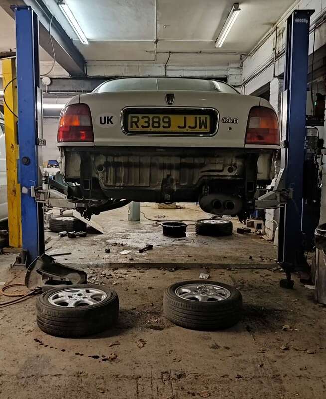

Time for an inspection!
Good and bad news:
Bad news first - the rust is *extensive*, but localised. There is further nastiness hidden away... Especially behind the rear bumper, more on that in a bit.
Good news - it's in the right hands and will be fixed.
Things escalated rather quickly as I removed all the wheels and arch linings to inspect and attack any grot points.
This was the expanding foam side.....
However, it is pretty localised as I soon found solid metal.
Whoever deemed that as an acceptable repair needs to hang their head in shame. To their credit, the filler work did an incredible job at hiding it which is probably how it went unnoticed for so long.
I decided I wanted to remove all the arch liners and check the inner arches more thoroughly. Off comes the bumper, I'm glad I did....
The nearside rear isn't too bad, there was an arch liner here and somebody has undersealed it in the past.
Unfortunately the offside rear is in quite a sorry state, the arch liner is missing on this side, so there's quite a bit of rot building up where you'd expect it.
I haven't even bothered attacking the offside rear lower arch yet, it's been filled with something or other...
One final surprise was unfortunately uncovered at the nearside front under the wheel arch liner:
So that's the chassis rail/leg which will need sorting too.
Anyway, rust aside which I already knew about, I'm pleasantly surprised at how the rest of the car has held up being in very good condition for the age, I couldn't really see much else wrong with it other than what was already known.

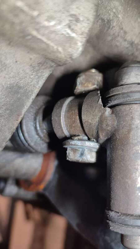

Unfortunately it has developed a coolant leak from the blanking ports, I connected the pressure tester and it started leaking as shown:
I am impressed with the nature of the 2p fix however will try and come up with an alternative solution.

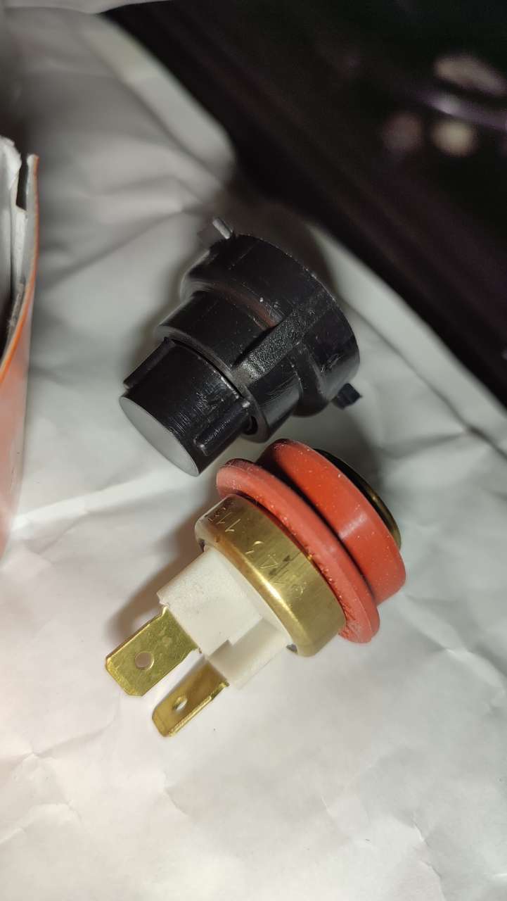

A bit of head scratching on the headlamp MOT fail:
  • Nearside Headlamp aim projected beam image is obviously incorrect + Very Dim (4.1.2 (c))
Scientifically* held a piece of cardboard up to it and the beam pattern is indeed very weak compared to the offside.
Can't really see much awry with the reflector medium within the lamp compared against the offside 🤷‍♂️
Fear not, chucked in a lowball offer on eBay and they only bloody accepted it within about 2 minutes 😅
Screenshot_2024-12-16-19-14-22-687_com_ebay.mobile-edit.jpg.295d715e67d8ba4fbfe06ceb9aa5f8af.jpg
It'll be handy to have another one and will save a lot of messing around for now, then maybe I'll pop the old one apart to try and see what's gone wrong and keep it as a spare

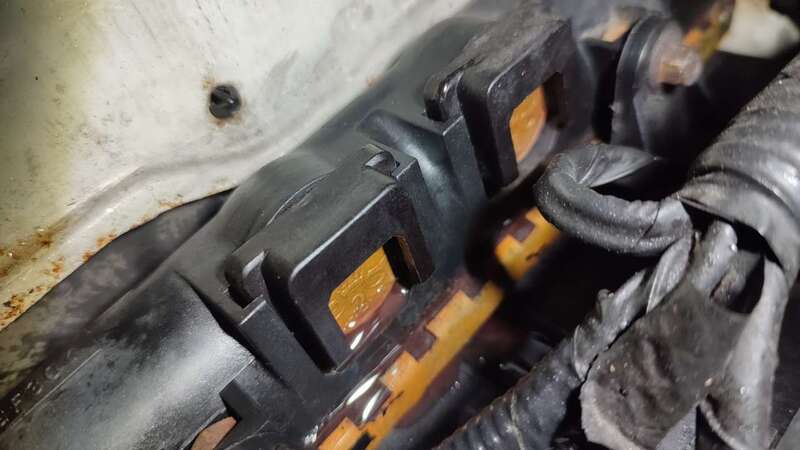

Alarm started going off at random this evening and it looks like the OSR switch has gone phut!
Fatharris had told me that a couple of switches had been disconnected in the past, I assume these to be the nearside ones as I checked them the other day and the nearside ones did not operate the interior lights but both offside ones seemed to be working ok the other day!
TLDR: yes please to any switches you may have!

Like I said, I'm impressed by the ingenuity of the 2p coin fix but it wasn't holding up on that port to the left in the photo.
I did some research online and found the OE part numbers for the sensor and retainer which would be fitted to a diesel model
And came up with the following:
Austin Rover new old stock!
You can see how this is going to work, the thermo switch comes with a new seal which is inserted into the rad, then the retainer twists and holds it into place
There's a cutout at the back of the retainer for an electrical connector if it was a diesel model which required them
And here they are in situ, demonstrated with and without the retainer. They fitted perfectly.
The old parts now retired from use, but I'll definitely keep these in the car as an emergency solution, just in case of any issues further down the line.
I had run out of time to run it up to temperature so instead I attached the pressure tester, and pumped the system upto around 15psi and left it for a while
Happily leak free!
Very pleased with this fix.
Just incase this is useful to anyone in the future:
The part number for the thermoswitches (seals included) are Lemark BHM4368 (factory number = CDU1490)
The part number for the retaining caps are Rover CDU1502
Both switches and seals were around £16 from parts in motion, and the NOS pair of retaining caps were around £10 from an eBay seller who had plenty in stock.
