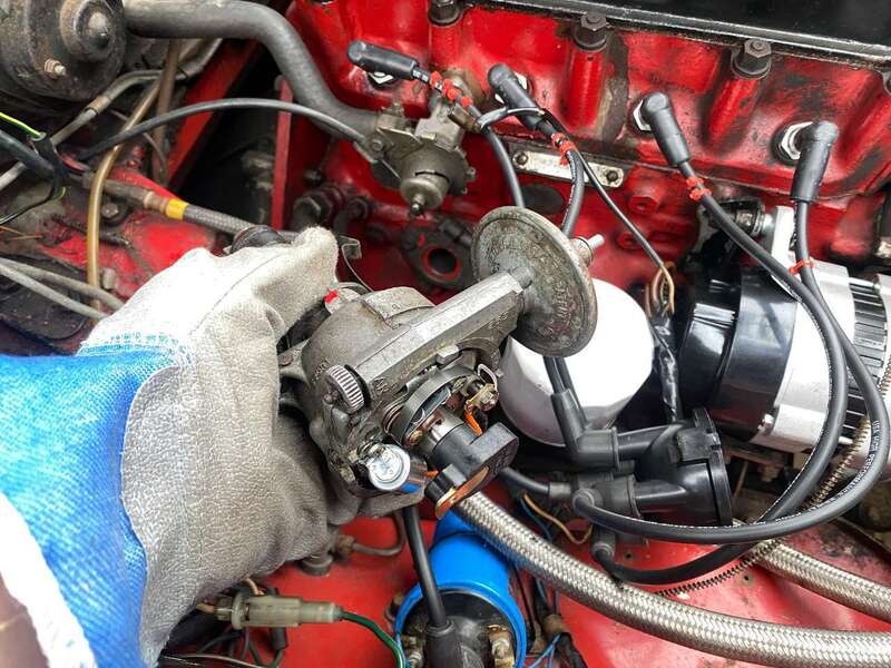

busmansholiday Posted January 31 Posted January 31 The capacitor connection circled in yellow, is that actually making a good contact,?
Peter C Posted February 1 Author Posted February 1 10 hours ago, busmansholiday said: The capacitor connection circled in yellow, is that actually making a good contact,? I think so, the nut keeps the cables together.

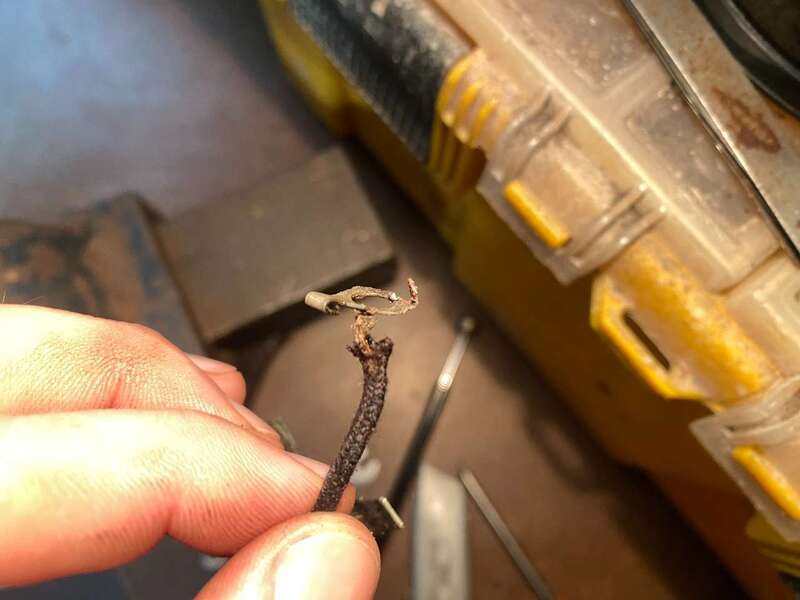

scdan4 Posted February 1 Posted February 1 That black wire looks knackered and may have internal problems to go with the visible insulation breaks. If it's the low tension power feed then I'd be replacing it to make sure it's not going high resistance / intermittent when 'vibing' Peter C and Zelandeth 2
Peter C Posted February 1 Author Posted February 1 30 minutes ago, scdan4 said: That black wire looks knackered and may have internal problems to go with the visible insulation breaks. If it's the low tension power feed then I'd be replacing it to make sure it's not going high resistance / intermittent when 'vibing' Agreed. Later today I will remove the distributor, check everything over, replace the black cable and go for another test drive.
Bmwdumptruck Posted February 1 Posted February 1 12 hours ago, busmansholiday said: The capacitor connection circled in yellow, is that actually making a good contact,? Shouldn’t the spade on the capacitor wire be under the nut rather than the insulation? Long long time since I’ve played with any points so I’m probably wrong, but it doesn’t look quite right to me!!
Peter C Posted February 1 Author Posted February 1 First thing I did today was check the wiring to the coil, as suggested by @SiC According to: https://www.mgexp.com/forum/mgb-and-gt-forum.1/ignition-coil-wiring.3342026/ the white wire should extend to the + terminal on the coil. Mine were fixed wrong way round so I've swapped them over. On previous occasions, I've been tinkering with the distributor whilst it was in situ, doing my back in and at times not really seeing what I was doing. Today, I loosened the distributor clamp and pulled the distributor out. It took less than a minute. I have marked up the distributor and clamp so that I know how to put it back in. With the distributor clamped in a vice, with good lighting, heat and music, working on the distributor was much easier and almost fun. Based on a previously presented photo, @Barry Cade pointed out that the heel of the points was not making contact with the cam. He was right. I loosened the points and adjusted them to get the heel as close to the cam as possible. Even then the heel was not touching the cam. With the points adjusted like this, the points gap was massive, way too wide. @Barry Cade I presume there is nothing that can be done, when the points are shut, the heel will not be touching the cam. The earthing wire appears to be rivetted to the base plate. Rather than disturbing the cable, which didn't feel brittle at all, I put some additional insulation around it. As for this cable. This much of it remains active. I have exchanged emails with Matt from the Distributor Doctor. Hitherto, he has quoted: The correct fibre heel points are £14.50, rotor arm £8.95, condenser £8.95 and distributor cap £19.50 plus postage and VAT, so £68.88 all in. I have asked Matt to quote for a new coil and today I emailed him again asking for the replacement cable. I suspect the total cost will be more than the Accuspark kit but hopefully the ignition system will finally be sorted. More soon. garethj, mk2_craig, Dyslexic Viking and 11 others 14

Peter C Posted February 1 Author Posted February 1 20 hours ago, busmansholiday said: The capacitor connection circled in yellow, is that actually making a good contact,? This looks useful. Bmwdumptruck 1

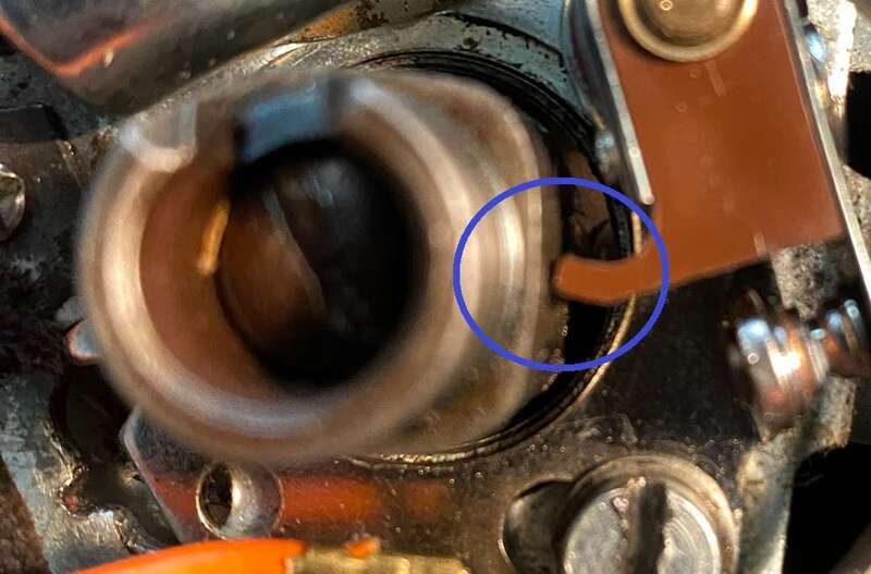

plasticvandan Posted February 1 Posted February 1 The fibre heeled points are a definite win,modern repros are made of a soft plastic that wears too fast. I grabbed a bag of old tufnol heeled ones for my minor years ago and they were great. As to he heel not touching the cam,I don't see why it would if the pointy part of the cam isn't touching it,as surely you adjust the points to open at the right gap when it's on the "widest" part of the cam. They usually had a felt wiper to soak in oil to rub against the cam as well. Matty, Peter C, Westbay and 2 others 2 3
lesapandre Posted February 1 Posted February 1 Yes. I think whether it's touching or not is irrelevant as that is the point of the spin at which the points are closed - the open gap is set at the widest point of the cam - ie the pointy bit - hence it opens and closes. These distributors can wear and cause problems ie the cam bearings, weights or vacuum advance etc.? Peter C 1
