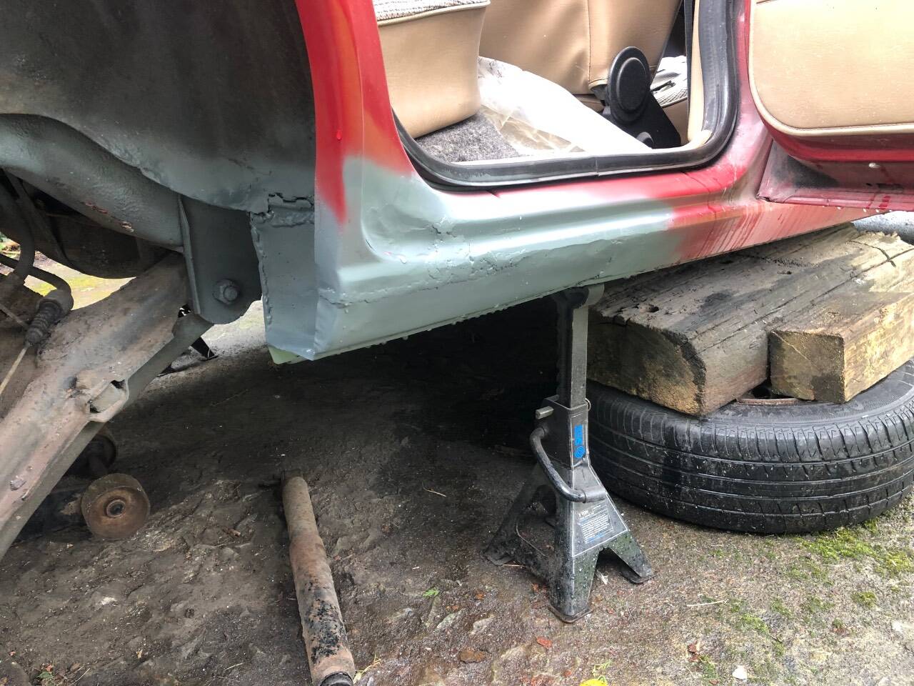

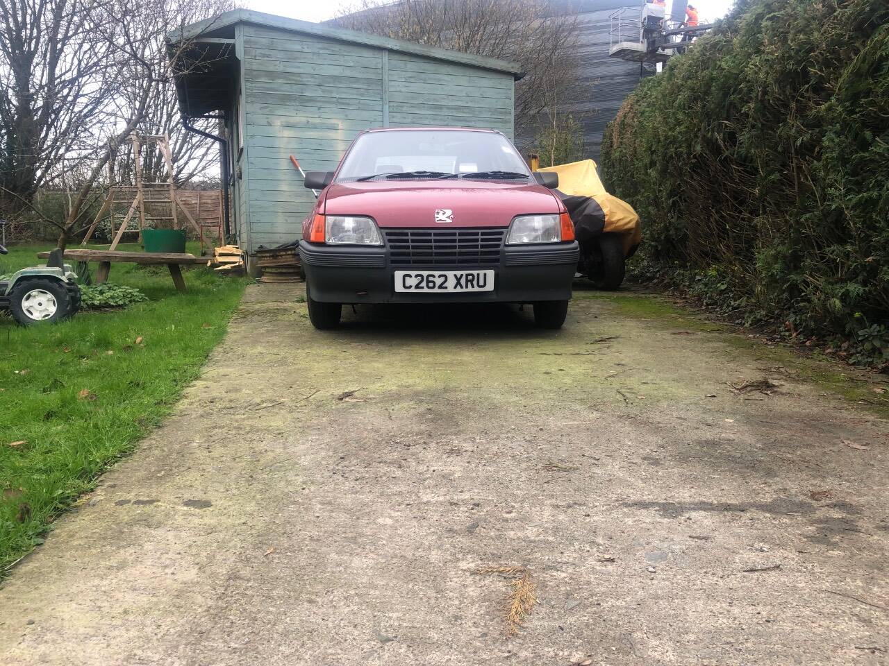

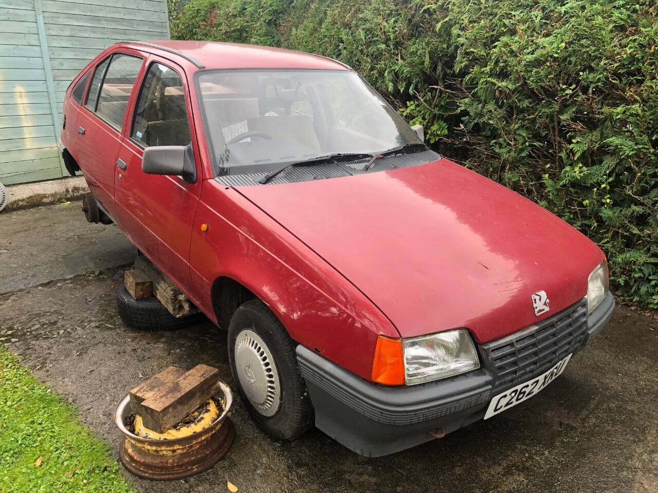

warch Posted August 28, 2024 Posted August 28, 2024 As detailed on my generic thread I bought a C reg Astra Mk2 (second year of production) earlier this year. It cost 900 quid (plus delivery) and is basically solid but minus a few parts and in need of a bit of welding. It’s the base model, not even an L or Merit, with the better 1.3 engine (the ancient 1.2 was the other option). Initially I needed to fit new front calipers as the old ones had gone walkabout. These were easily sourced online once I’d identified what I needed. Ditto a new starter motor which allowed me to run it and see what it sounded like. It did start fairly easily notwithstanding the quirky auto choke mechanism which is thankfully unfamiliar to users of modern cars. It ran smooth and lacked the characteristic death rattle of the time expired overhead camshaft that afflicted many of these engines. All the electrics on the car (there aren’t many) worked fine despite the odd number of indicators (someone had replaced the N/S front wing but hadn’t drilled a hole to refit the side repeater). Happily these aren’t actually required on cars built before 1986. Being a mid 80s Astra there was going to be welding. Initial examination revealed a crunchy O/S rear sill and a hole in the wheel arch in front of the rear wheel. Further examination with the wheel removed revealed corrosion damage to the rear upper spring mound on that side. A new sill was obtained online and the offending section cut out and replaced. A repair piece was crafted to fit in front of the rear wheel. I blasted it with zinc primer inside and out. Obviously needs smoothing and painting, this is how it looked after welding and linishing. The spring mount was repaired (replacement pieces are also available) and welded back into place. Next thing to tackle is the corresponding section of sill on the other side of the car. It’s actually technically ok as it’s strong enough to support a jack, but I may as well get it as good as possible especially as it may well not be regularly MoTed after next December when it achieves exemption status under the current regs. I’m not looking to achieve anything near perfection with this car, my aesthetic is rally car (still a few Mk 2 Astras still on the motorsport scene) so strong and well sorted will suffice. The only other items required are a new battery and fresh set of tyres. Cavcraft, grogee, GrumpiusMaximus and 44 others 46 1

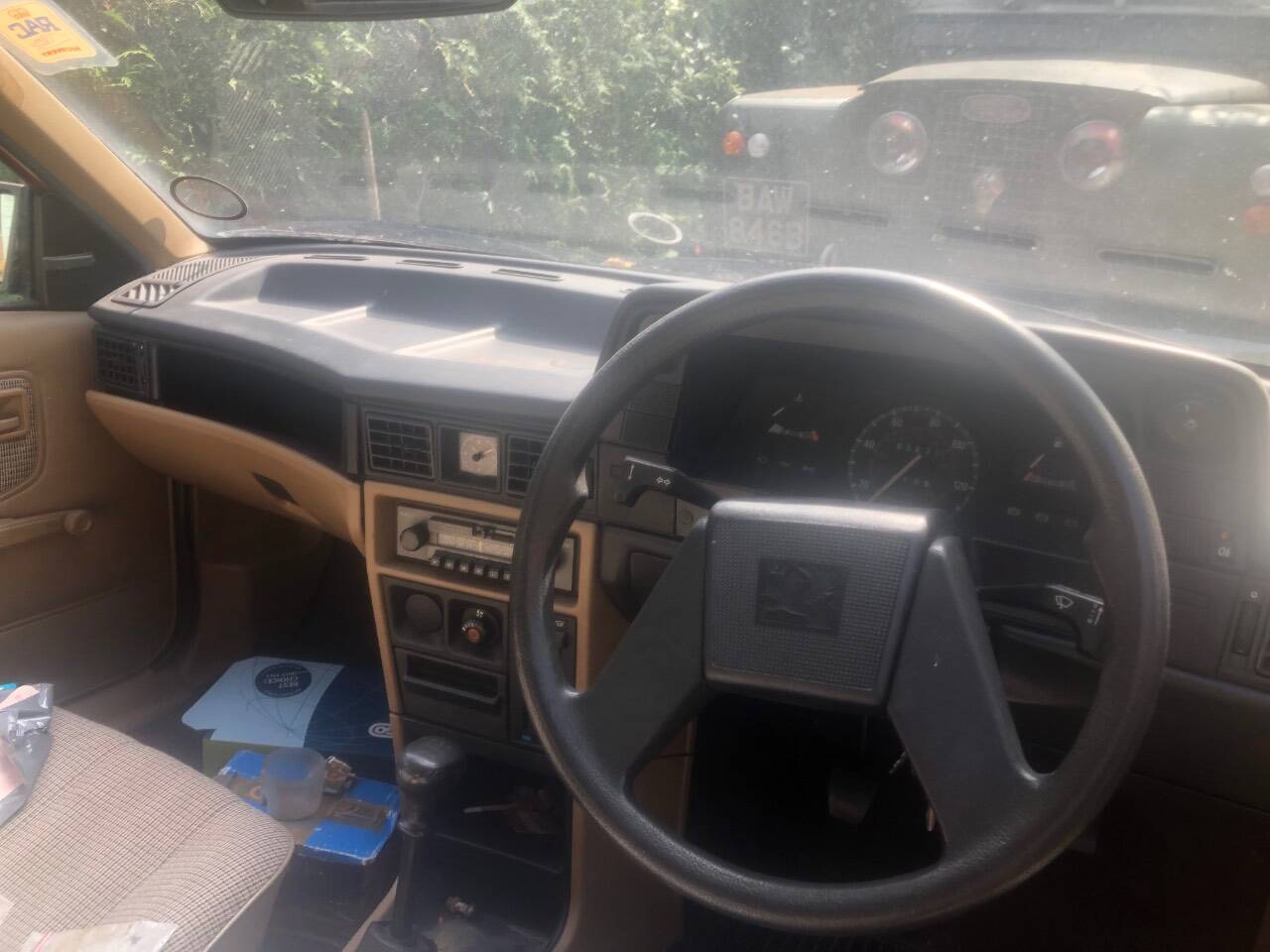

grogee Posted August 29, 2024 Posted August 29, 2024 My Dad had five Mk2 Astras, all with 1.6 pez. Really good cars, I think only one disgraced itself by snapping its cambelt but non-interference so an inconvenience not a disaster. I learned to drive in one of them. Impressive welding skills there @warch. How about a pic of the bASe interior? Does it have a clock? warch 1
warch Posted August 29, 2024 Author Posted August 29, 2024 Here you go Grogee. I can’t take any credit for the welding, I just cut the pieces for my mate Will (who also did my Landrover) to weld in. JMotor, danthecapriman, FakeConcern and 7 others 10
Matty Posted August 29, 2024 Posted August 29, 2024 Love it. Like a manta b dash its the view of my youth. My dad had a series of mk1 2 and 3 diesel vans as i grew up. At 17 i had an astramax for a bit as well. Well jell. warch and GrumpiusMaximus 2

warch Posted August 29, 2024 Author Posted August 29, 2024 30 minutes ago, Matty said: Love it. Like a manta b dash its the view of my youth. My dad had a series of mk1 2 and 3 diesel vans as i grew up. At 17 i had an astramax for a bit as well. Well jell. Me too. I can still remember sitting in the passenger seat of my Mum and Dad’s B reg Opel Kadett estate thinking how futuristic it was (I was 7). It lasted long enough for me to pass my driving test in 10 years later and was still going strong when my brother wrapped it around another car on a mini roundabout in Hereford a couple of years after that. Matty and GrumpiusMaximus 2
grogee Posted August 29, 2024 Posted August 29, 2024 6 minutes ago, warch said: Me too. I can still remember sitting in the passenger seat of my Mum and Dad’s B reg Opel Kadett estate thinking how futuristic it was (I was 7). It lasted long enough for me to pass my driving test in 10 years later and was still going strong when my brother wrapped it around another car on a mini roundabout in Hereford a couple of years after that. I agree that looks like quite a futuristic interior for its time, very sculpted and quite cleverly laid out. I guess the outside was a bit 'future shock' in 1985 as well, although we'd had the jelly mould Sierra for a couple of years by then. 1.6 felt quick then, the 1.3 didn't hang about either. Both great engines. As Matty says - well jell. Matty 1
warch Posted August 29, 2024 Author Posted August 29, 2024 26 minutes ago, grogee said: I agree that looks like quite a futuristic interior for its time, very sculpted and quite cleverly laid out. I guess the outside was a bit 'future shock' in 1985 as well, although we'd had the jelly mould Sierra for a couple of years by then. 1.6 felt quick then, the 1.3 didn't hang about either. Both great engines. As Matty says - well jell. I borrowed the battery off the Landy and fired it up today. A slight alteration to the idle speed and adjustment of the drive belt tightness was all it needed. What strikes me is how modern it feels, surprisingly smooth and free revving, much more like a 90s or early 00s car. It also doesn’t stink of petrol/fumes like many 80s cars used to. My brother had a 1.6 Astra GL which was fantastic really, supposedly only 82hp but went much better than my allegedly 105hp Orion Ghia. grogee, Burnside and GrumpiusMaximus 3
