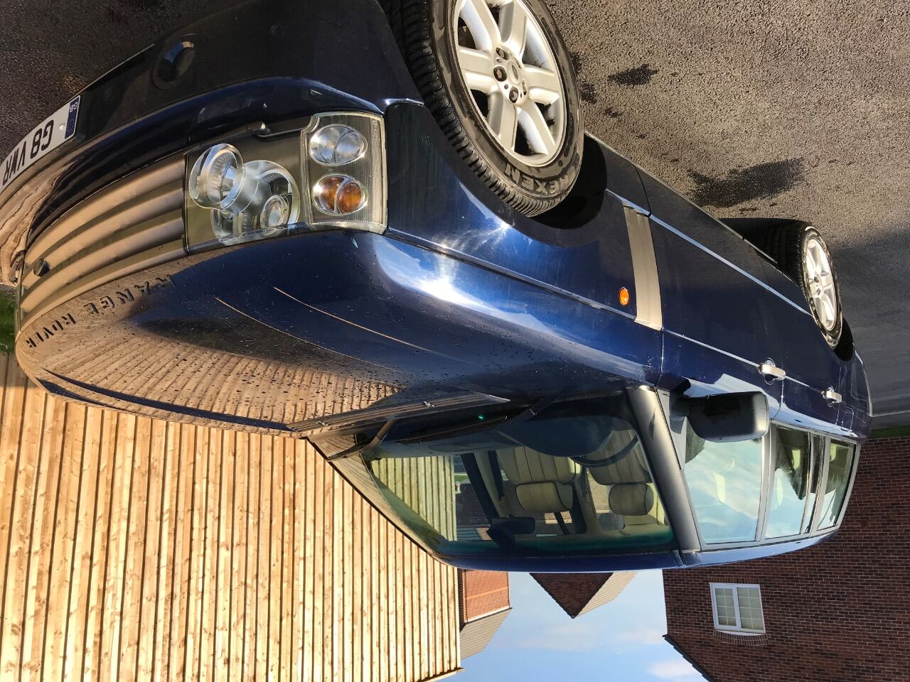

Brown trouser moment this evening. After a 15 minute drive on country roads I noticed I could hear the radiator fan on at full speed. Shortly after, the temp guage started rising very quickly. Just as it got to 3/4 and I was about to pull over it pinged back down to half way. It stayed there for the rest of the journey and no more fan either.
The heaters being hot and the temp guage staying in the middle on the test run had fooled me into thinking that the system was properly bled.
Coolant had only dropped a small amount, I thought it would have been more now that air has exited the system. All seems OK on the return journey though, so far.
Could have done without that 😂
Aye, so thats a naw on the Renault 5 thermostat, its causing issues.
The radiator fan was coming on again last night and when I opened the bleed screw a big burp of coolant and air came out. No change in the temp guage this time though.
Car drove fine tonight but I thought Id try the bleed screw again and more air and coolant came out. More again when I got home.
Correct thermostat ordered and I should hopefully be able to get the 5 one out the top hose with some hot water as its brand new and quite malleable.

I've had to order another new top hose as the thermostat is stuck fast inside there.

After the rain finally fucked off for longer than one hour I tackled the thermostat.
I still had my viscous fan tools from the E46 and after some faffing I got it off.
Some members of the RR Facebook page had berated me for fitting a Renault 5 thermostat as the standard one 'is only 4 bolts'. Well, that's bullshit😂 its buried under the EGR which is held on by 2 Allen screws. Notwithstanding the fact that one looked chewed, I couldn't get to the screw anyway without taking the coolant pipe off the top of it, which I couldn't get off because another hard rubber hose was fouling one of the ten mils holding it on.
However with the plastic cover off the engine I noticed there are THREE bleed screws throughout the cooling system.
So I bled it up via all 3, went for a drive, top hose nice and hot so we will see.
