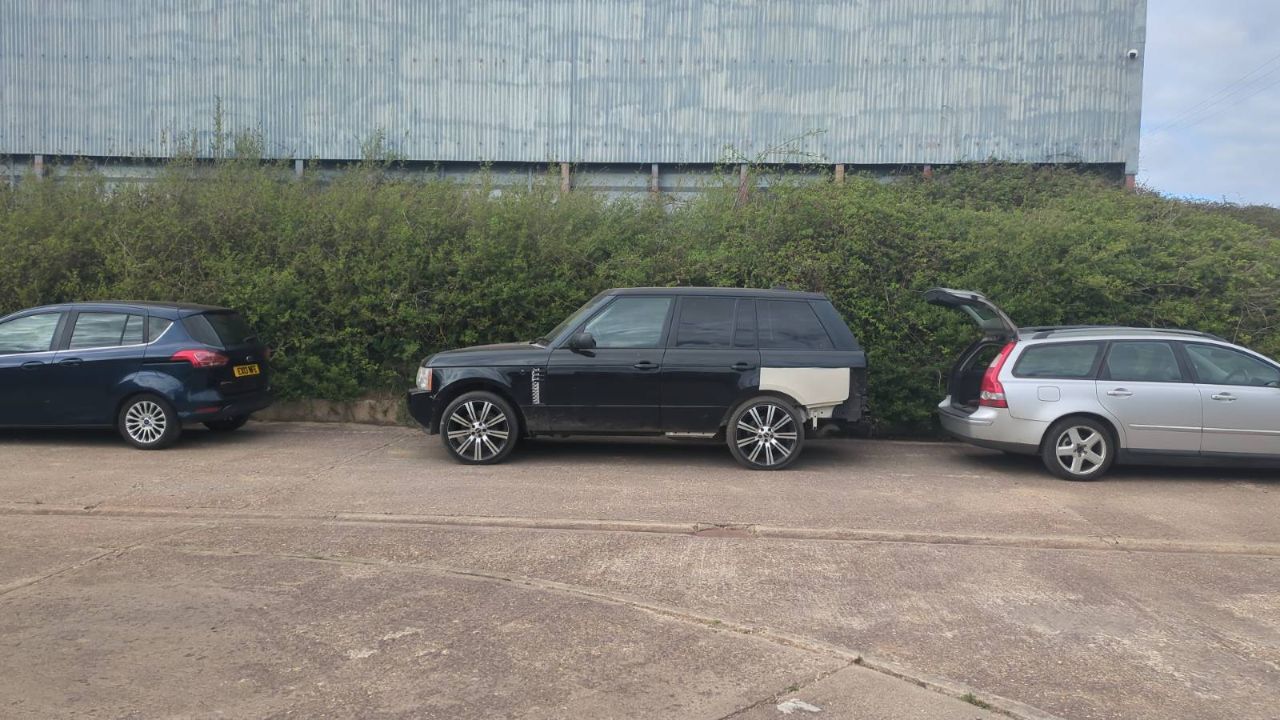

So this sort of escalated..
So far I've done, both sills, both jacking points, both arches, and got most of it into epoxy primer.
And I've been quite ill, so not really had as much time as I wanted on the car.. as a result it's now a collection of parts in a container, and most of a car in my workshop.
BTW if anyone is intersted in either a BMax or a Volvo, both are being sorted out for sale soon.  The Volvo is a 2.0 HDI one.
