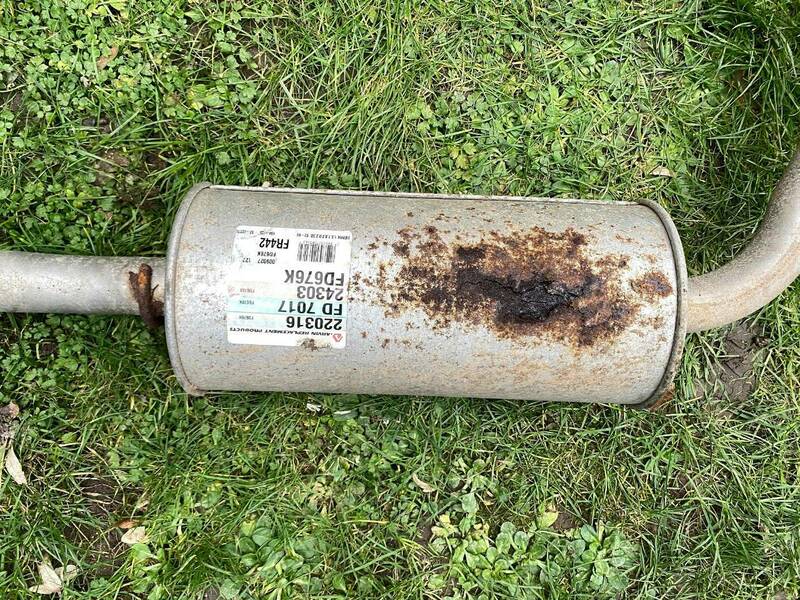

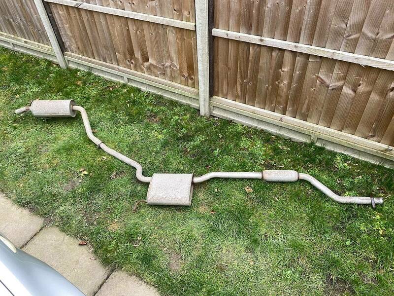

Looks like getting hold of a replacement downpipe and central exhaust box won't be difficult. Or expensive.

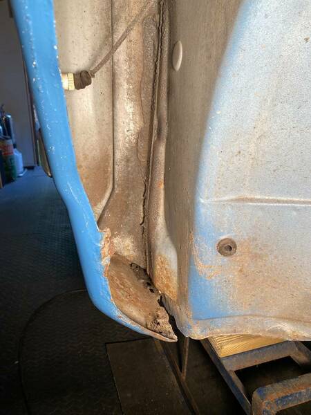

I know you’re already a little unhappy with the car @Peter C but personally I’d be looking further into this before anything else!
I think you’ll get away with grinding that back. It will have gone under the edge where the screen sits though but that a windscreen out job.

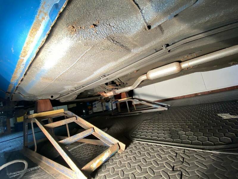

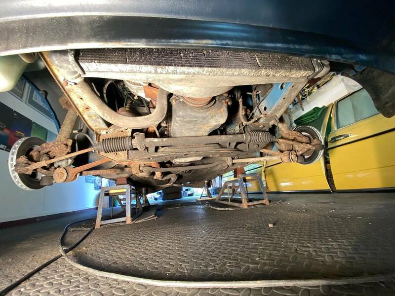

Looks like one of the better Sierra's left, not as nice as you hoped but I think you've done pretty canny

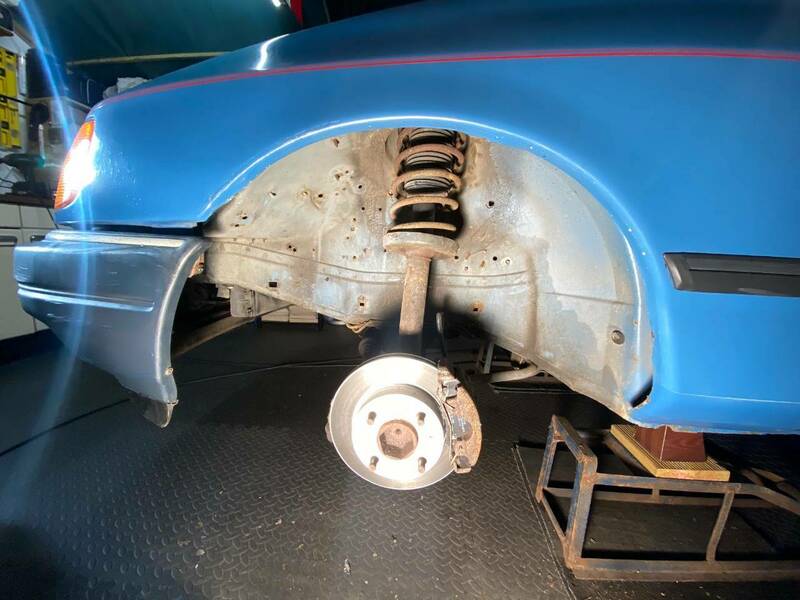

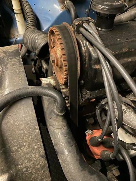

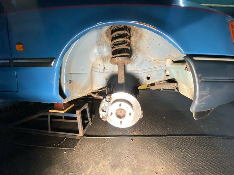

Christ that could have been a lot worse! All the important bits are in order and there's a few service jobs like belts and zorst. And by some miracle you can still get bits for it.
This is an easy ride for a 1988 car, trust me.
There could have been a thousand quid's worth of welding needed doing behind those arch liners.

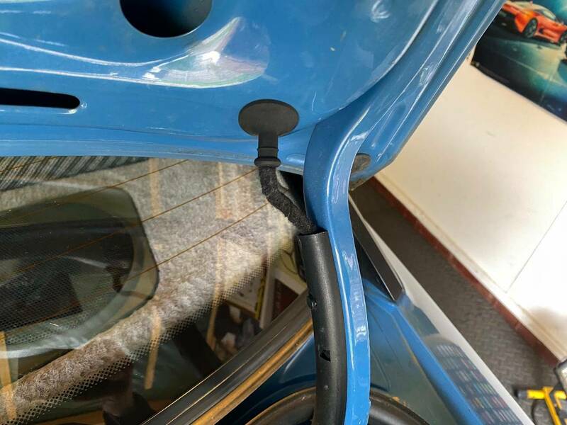

Re: boot harness - isn't that for the number plate lights?
The number plate lights are on top of the bumper.

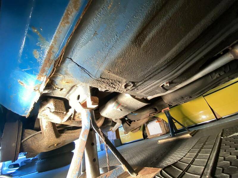

My sierra 30 years ago was rusty, 2.3 diesel in the same colour, so you're not doing bad. As long as there's no horrors under that textured paint on the lower third of the doors your doing well. Fixing bodywork is easier than trying to find a good interior.

I feel much better for you seen as the inner structure is ok. It's no big deal if you find the sills need metal letting into them.

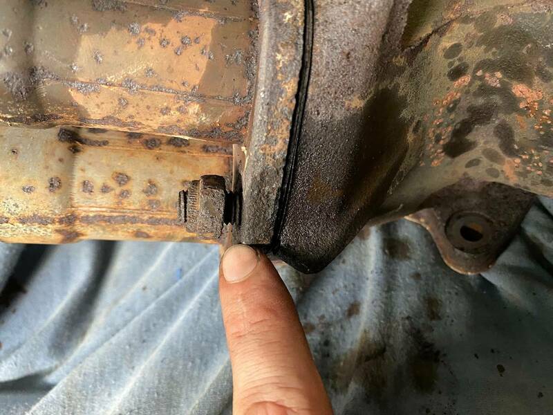

Soak the stuck nut in 50/50 ATF and Acetone, wrap a saturated rag round it and it’ll piss off that nut.
Sadly, I don’t have either.
