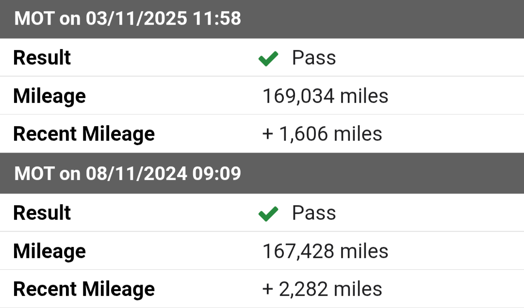

Clean pass this morning.
They commented that it went straight through the emissions, so the Pulseair™ 1980s style emissions cheat is working even if it makes the car run like shit.

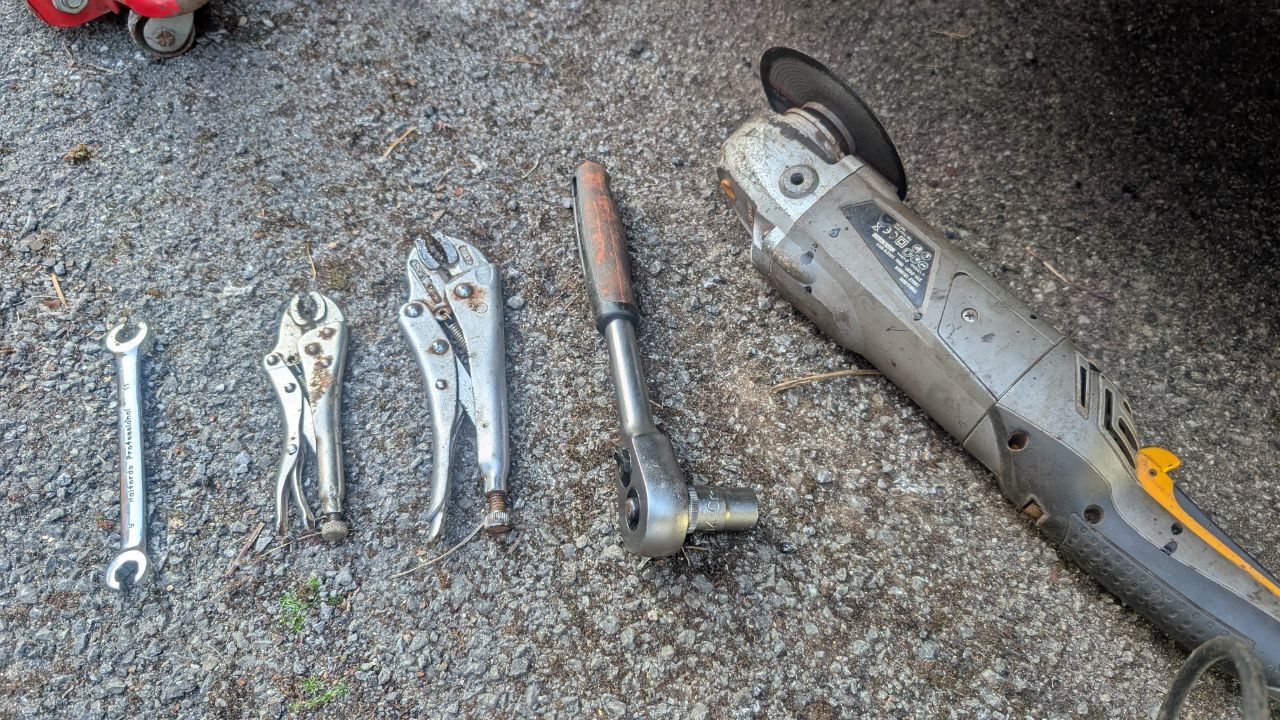

Not sure of the cause of the brakes catching fire but I started by changing the hoses in case they'd collapsed.
Easy job, yeah?
Welcome to the 4 stages of brake hose removal.
Absolute fucking cunt.
Obviously, once I'd cut the pipes i discovered my flaring kit can't do bubble flares, so I had to take the pipes to the garage to be done in exchange for a packet of hob nobs.
THEN to add insult to injury, when I went to bleed the brakes, the bleed valve just rounded with FUCK ALL pressure.
I thought about getting some new bleed screws  but ordered some new calipers as the old ones did still smell a bit of fire and all the bleed screws I could find were for cars built on a Friday, when mine was built on a Wednesday or something.
However when I ordered the calipers, they were out of stock and took a week to arrive.
They arrived yesterday, so thats the offside sorted. Lets replace the nearside.
Both pipes are not fucking budging. 😭 Needs more:
However, i can't be fucking arsed. The other side took me a fucking month 😂
It may be that I'm being a bit cautious after mullering the pipe last time but I'm out of fucks and hob nobs.
I either need more time or a better hobby.
