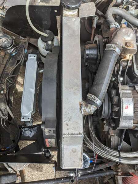

I do think I'll need to put the mechanical fan on before we get to summer weather finally. I did notice that the gap between the electric fan and radiator stops a lot of the air flowing through. So it ends up blowing over the top of the radiator. Possibly less of an issue with the bonnet shut but that fan is also on the wrong side for the manifolds & carb. Where as the mechanical fan would be sucking air through the radiator directly onto the carbs.
I can't see any easy way of mounting the electric fan much closer or even directly on the radiator.

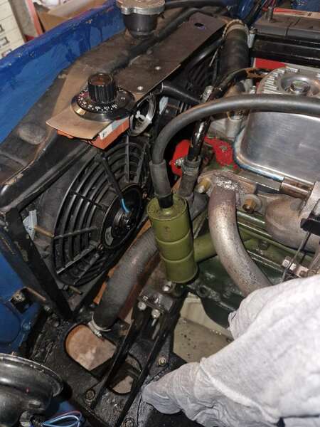

The biggest issue is heat and cooling.
It's temperature is getting pretty spicy under the bonnet on a run. It got higher than this and on the last peg before the H.
The fan switch is becoming even more temperamental. It didn't work at all earlier even after turning it back and forth. I was about to pull the connector off and it kicked in again. However I didn't trust it so I connected it permanently on for now with the extra spade terminal I crimped on to allow it to be overridden. I noticed the fan running quicker on this terminal which suggests that the switch terminals are high resistance.
Looking at the wiring, there is a relay to turn the fan circuit on with the ignition. I was expecting the thermostat switch to go through this too but instead it directly switches the fan motor. The motor draws just over 16a peak starting up and falls back to around 11a running.
According to the rating (this is off an eBay listing of an identical switch) it should be 16A but the different spec on the paper label doesn't inspire confidence. It's also the AC rating which is often higher than a DC rating.
There is a large gap between the fan and the radiator. This is really not helping things as most of the air goes over the surface of the rad rather than through it. I can't see how I can get the fan much closer and I don't want it touching the rad as it might damage it.
I think I'll have to figure how to get the mechanical fan attached. It's the best solution really. Even though the carbs are behind a heatshield, the float chambers are almost too hot to touch. This can't be helping with fuel vapourising. You get a whiff of petrol now and again, especially if starting off, so I suspect the heat isn't doing them good.
I might go for a fiddle in a minute while the weather is nice.

Now I've repaired the fault, my electric fan set up is very effective. Mines at the rear of the rad and drawing through. Twin fans and it has a hell of a draught on it. Is it possible to move the rad forward and squeeze a set up behind?
Edit edit
Like this

It is an option but I want to make sure I'm not side stepping any other issue. Such as the wrong Speedo drive in the overdrive. They'd have to re-gear the speedo if that's an incorrect one. On the Triumphs of this age they seem to have all 1000TPM and correct it in the box. The TPM would need to go down (I think!) to fix this issue. Not sure how much but presumably 10% if that's the error. Again if I get the actual teeth count in the overdrive, the correction needed to be applied can be.
There should be room for a mechanical fan. That's how God Triumph intended and should be all that is needed. I have a correct fan but I need to find some correct bolts and it needs to be fitted. Both I've not done yet.
With the fan on permanently with the ignition, I've just been out with Mrs SiC to the beach and back with it absolutely fine. Temperature stayed bang on where it should be.
You see that's your problem. You will insist on doing the job properly 😄
With the weather starting to get hotter, the cooling situation really needs to be sorted.
So dug out an old BL fan
Cleaned off the oily filth
Dug out my box of bolts
Fitted it
This took far longer than it should due to limited access. My flexi stubby ratchet spanners came in very handy.
It required a bit of mold grip reshaping of the guard by the radiator cap as it caught the fan
Then ran it up to make sure it didn't hit still when up to speed
This is the front shot of the radiator. The electric fan is more on the other side. While I probably could get it moved across, I'm quite happy it here as it doesn't obstruct the mechanical fan I've just fitted.
I'll still wire the electric fan into a switch. While it should never be needed, it may come in handy on a really hot day. After all it's going to be a spring/summer car for me and that'll likely mean it'll be used in very hot days. I don't want that gauge creeping up in stationary city traffic where the mechanical fan isn't doing much, with no means of resolving it.
While I was putting the roof up in the dark, I noticed my light on the bonnet shining through some holes in the footwell area. Presumably this is why they got so soaking wet the other day. Water drains on top of the scuttle area and must leak through these holes.
I'll find a way of plugging them perhaps.
Hopefully this fan will be the end of any cooling issues and that gauge will stay fixed in the normal end. My experience on heatsinking is that even a small bit of airflow makes an enormous difference over no airflow.

8 hours ago, RayMK said:
you confident that the engine won't swing from torque effects when under load and/or jiggle on rough surfaces and clout the rad?
Certainly not confident! Even though it's an aftermarket radiator, it lines up all with the existing factory mounts and I believe is a correct one for a Spitfire. However there is no guarantee that things won't shift. I'll have a measure.
There is enough gap to get a 3/4inch bolt into the fan and a spanner. Not enough for a standard socket and ratchet. So I'd guess at least 3/4inch of clearance, maybe 1 inch.
Not a huge amount of room but it's not butted directly up to the rad.
That fan should be in direct contact with the rad. Most aftermarket kits have little fasteners that you push through the gaps in the fins. Sucking eggs comment…. It is rotating in the correct direction….?
